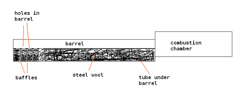

So what if I add a pipe under the barrel that serves as an extended expansion chamber for a silencer. Would it work ?? and how good it would work when compared to a normally built silencer with the same volume as the silencer+expansion chamber combination?

Maybe have a bit of steel wool/cotton in bettween the baffles?

Poland spud, what do you mean? I don't know if this is what you were thinking, but it sparked an idea for me.
Instead of the silencer surrounding the barrel end, perhaps in could be on one side only? This may be hard to implement, but the silencer tube would go underneath the barrel, and many holes would be drilled on that side, so the holes would line up.
Hmm... that is kind of hard to picture, and I am too lazy to draw it up (I'm on a mac at the moment!)

yes Hailfire753. My idea is that a silencer tube is connected to the tube under the barrel. It increases the silencer volume and as a result its effectivness.

If you mean something like the attachment, it will work, but while it will have greater volume than a coaxial silencer of the same diameter, since the holes in the barrel cover a smaller area you'll have less gas coming into the tube, so it might not be that much more effective.
