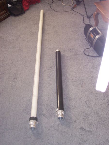

Check out the cams on this page: http://www.bcvids.com/store/index.php?cPath=23_31
<a href="http://www.bcarms.com/"><img src="http://www.bcarms.com/images/store_logo.png" border="0"> </a>
These are the cam locks on two barrels

They have NPT threads, they attach to threaded PVC fittings.
