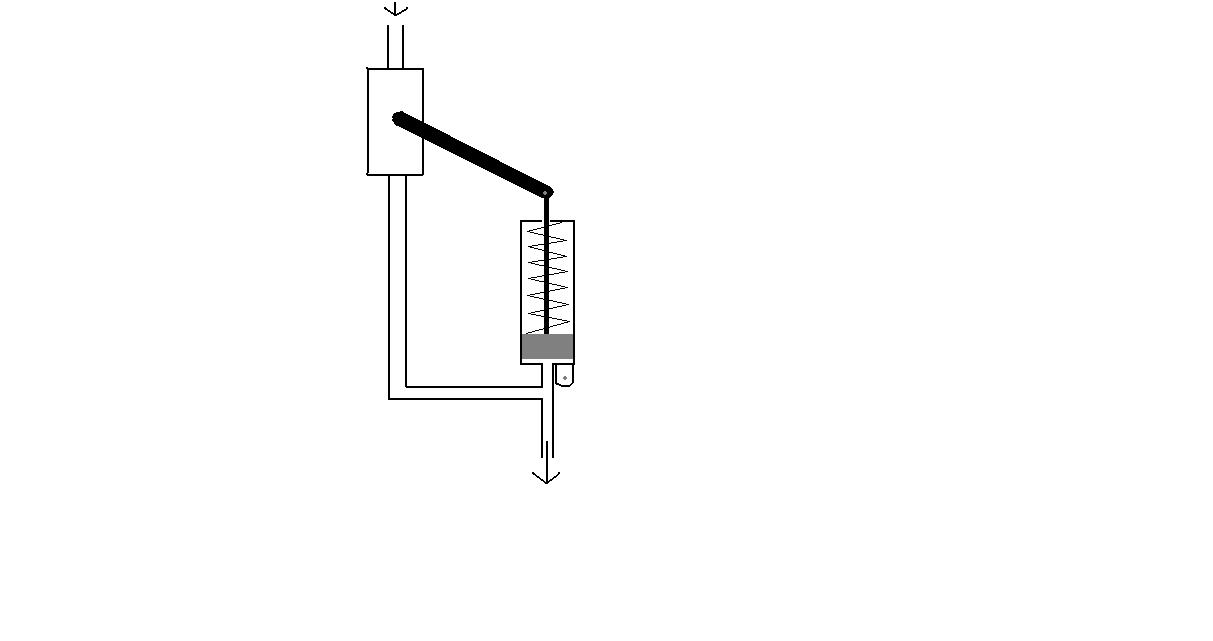

If the pressure in the system overcomes the power of the spring ( on top of the piston) the ballvalve is closed.
The power of the spring determines at what pressure the inlet is closed, So yes..in theory this works
When the pressure increases, the piston is pushed back wich closes the valve more and more._Fnord wrote:Am I the only one that doesn't have a clue how that diagram is supposed to work?
Anyone care to explain it to someone who just got up?
The valve will be completely closed at a given pressure.
When the pressure drops the piston is pushed back by the spring and opens the valve again, letting air flow in, increasing the pressure.

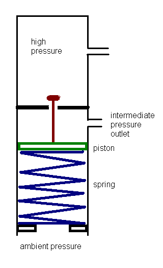

Hi,
Try to look at a diving regulator:
http://en.wikipedia.org/wiki/Diving_regulator
(the drawing with the caption: Diagram of the internal components of a piston-type first stage)
This can be simplified somewhat, to avoid having to seal the outside of the moving stem pipe... see my drawing.
When the intermediate pressure is too low, it can´t prevent the spring from pushing the valve open --> intermediate pressure rises.
When the intermediate pressure is too high, it will push down harder on the piston, overcoming the force of the spring and closing the valve.
The problem with the ball valve set-up is that it requires a lot of movement to control the ball valve. It will need a very long and very stiff spring. On the other hand, "my" design also is influenced a little by the force of the high pressure on the valve - a ball valve is not. If the piston in my drawing is large enough compared to the valve seat diameter, it won´t really matter though.
Regards
Soren
Regards
Soren
Regards
Soren
Regards
Soren
- Too late for a patent, but here it is.
- regulator.PNG (7.68 KiB) Viewed 6842 times
