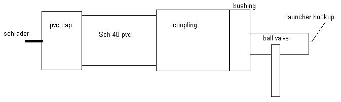

Be sure to lube it with a water based lubricant and not a petroleum based. Also, This may can be utilized to help seal it better.
As far as using a bike pump, it may be that there is not enough air flow to make the seal. You could make a small secondary chamber (see diagram for more detail). This chamber should be able to seat the piston, if that is the problem.

Ill try that and see if that helps

After fiddeling with it for a hour or two I got it to work now all I have to do is put a chamber and a barrel on it and I should have a powerful peice of machienery.And thanks hubb017 for sugesting the secondary chamber idea it worked
