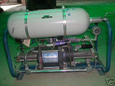

grumpy
Posts: 331
Location: tampa,fla.
here is one check it , if i wasn't already set up i'd be alover it.
http://cgi.ebay.com/Haskel-Air-Driven-G ... dZViewItem
