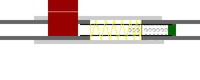

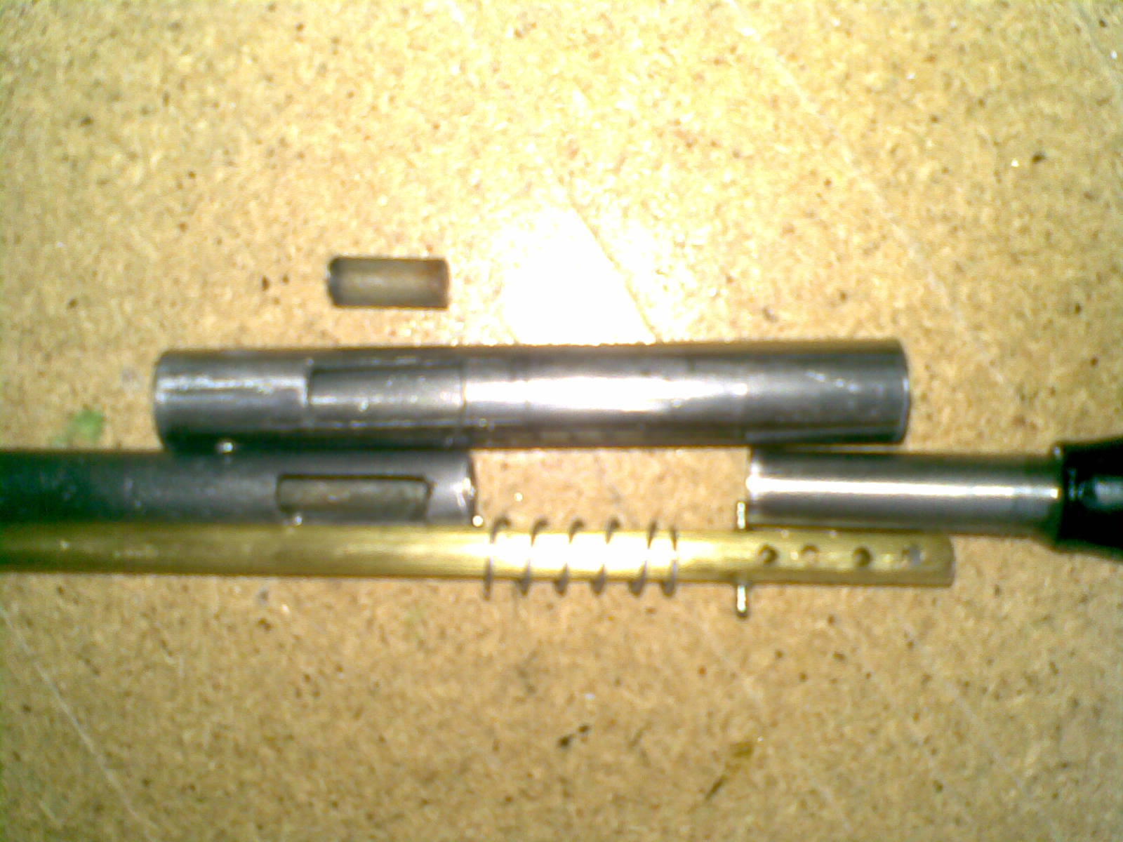

heres the plan.
making a semi auto mechanism for 6mm - 1/4inch projectiles using Clides slider design. the barrel and mechanism will be encased in pn18 22mm - 7/8inch pvc
i have made the chamber and am working on the sprinkler valve
my questions and concerns are:
if i release 150psi from the valve down the barrel into the slide will it hit the projectile out of the barrel before the air forces it out a bit like the pin in a nail gun?
also how much if any performance will be lost from diverting air around/through the slide?
thanks for any answers and comments.

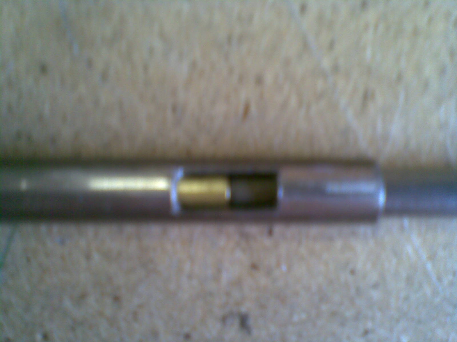

the semi auto mechanism copy of Clides idea

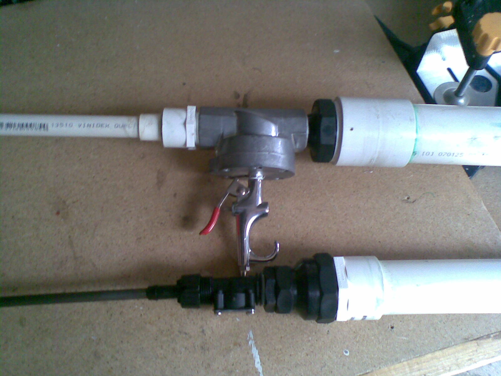

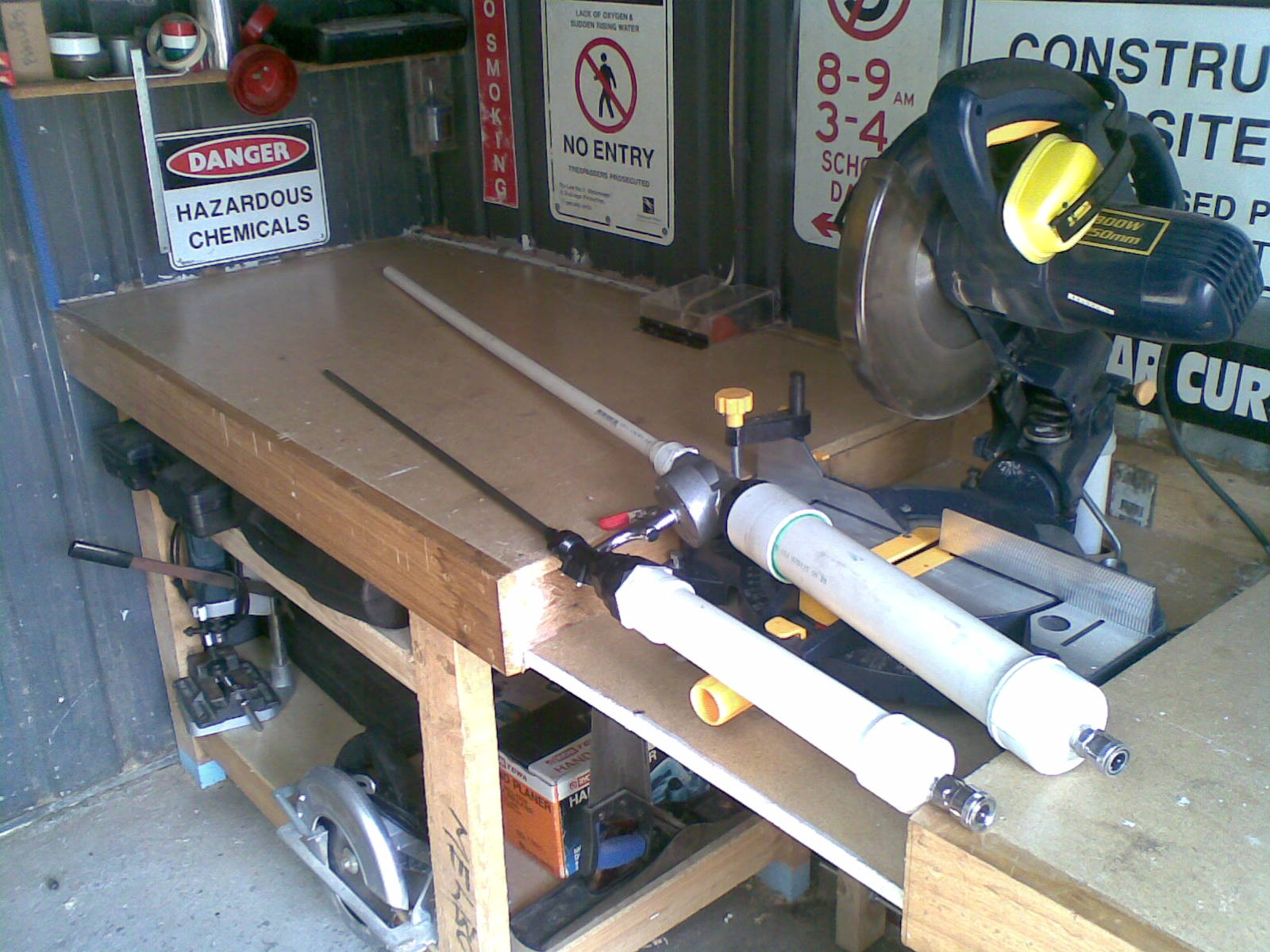

my marble cannon with the new cannon currently under construction

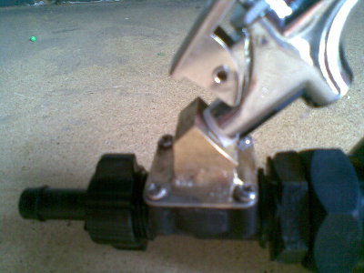

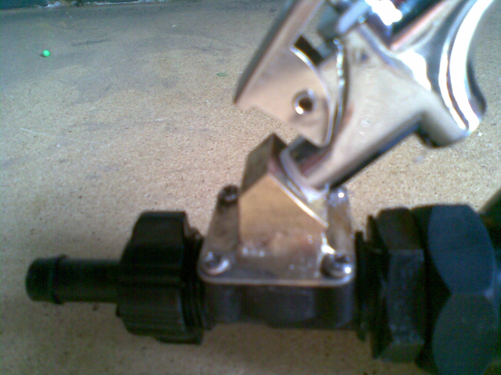

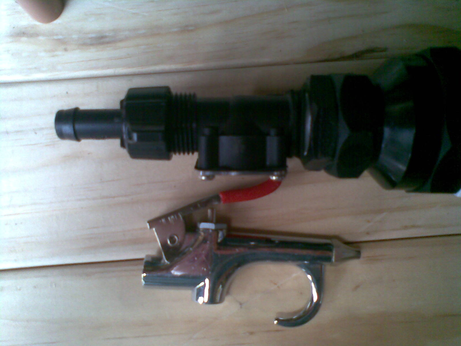

size comparison of the small valve

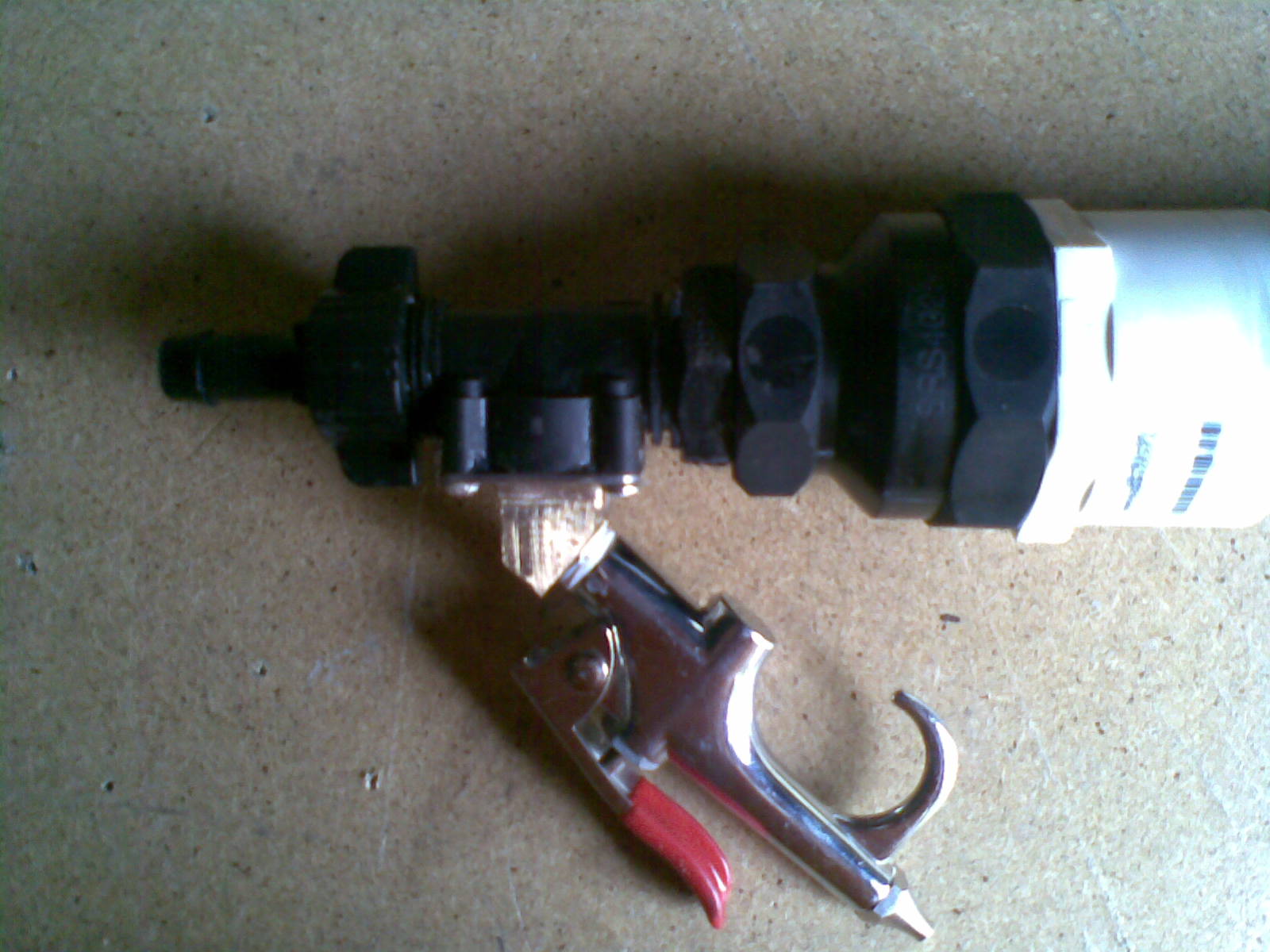

another size comparison of the small valve

There's no doubt that the breech design works, right now I'm going for something similar here but hoping to use a constant flow of air for full auto fire.
The valve opening will be quite instantaneous so I wouldn't be too concerned, however you can add some sort of frction mechanism like an o-ring to keep the projectile in place, if anything to stop it from rolling out when the barrel points downwards.
Of course you're increasing the dead space and reducing the flow, however for a decent chamber size and pressure you should still get respectable performance.
I think a sprinkler valve is a bit overkill for a 6mm barrel, with this design I got very good performance using a simple blowgun - at 150 psi yours would be even better, as I'm limited to 110.
edit: Also, have you checked how long it takes the sprinkler valve to reset after firing? if it is too slow the system will be very wasteful of air.

i haven't finished modding the valve so im unsure at this stage.

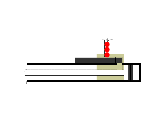

idea for a bb pistol forgot what type of valve it is though
pistol idea.gif (30.1 KiB) Viewed 4455 times
Been thanked: 350 times
The above would be a manually reloaded piston valve. If you have two separate valves to both fill the chamber and pilot the valve, you could easily make it semiauto by incorporating it in your first design instead of the sprinkler. If i were you before making further progress, mod the sprinkler and see how long it takes to seal shut after firing.

i have already made a prototype of the piston valve but destroyed it because it didn't seal i have now realized i probably should have placed an o ring in the bondo/bodyfiller around the barrel for the piston to press against forming a seal.
ur 6 mm semi is some what of a piston valve anyway.

finished modding the valve today it resets fairly quickly. and since i already have all the materials to make the slide i think i'll give it a go and see how it turns out.

I got scared when i saw that your cannons were under a cutting saw.
Nice work and good luck with your new "Jaunt".

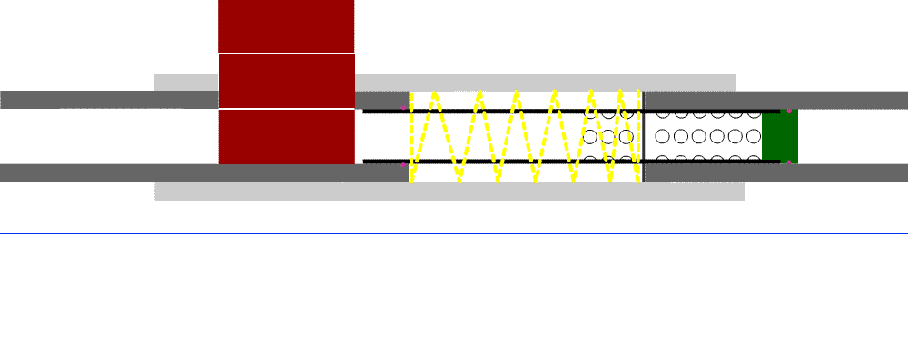

made some progress on the slide now to let the glue set. boring
anyone know how to rifle a 6mm - 1/4inch I.D steel barrel or how to make a tool to do it?
cut out in two barrels with the slide and projectile in the middle. dremmels are
all the pieces of the mechanism <br />slide hasn't been cut to length at this stage.
