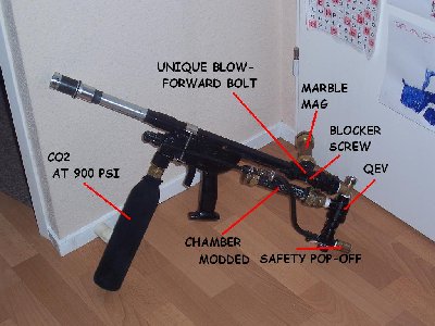

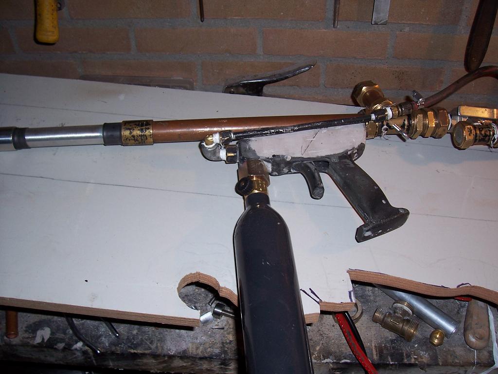

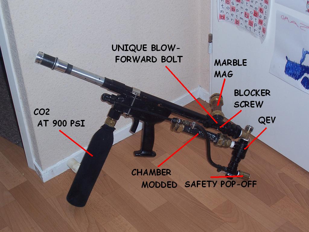

Here is a preview to my current project.
I finally obtained a QEV and was eagre (sp??) to try out the QEV-safety pop-off principle to achieve full auto in a marble gun.
Boy does that work!!

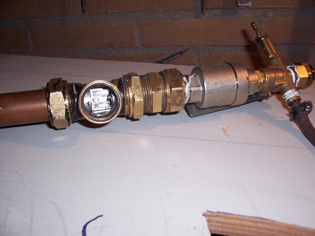

I currently use a small chamber, because I still have to get a CO2 refill and now pump up the bottle with my trackpump to test the principle.Therefore I need to reduce gas consumption to the minimum for now.As it is, I can only fill the bottle to give me 5 full auto shots at the required 11 bar.I like the fact it doesn't give weak shots as the tank empties.It just stops.Very clean..BANG-BANG-BANG-BANG-BANG.Then silence..I love it!!

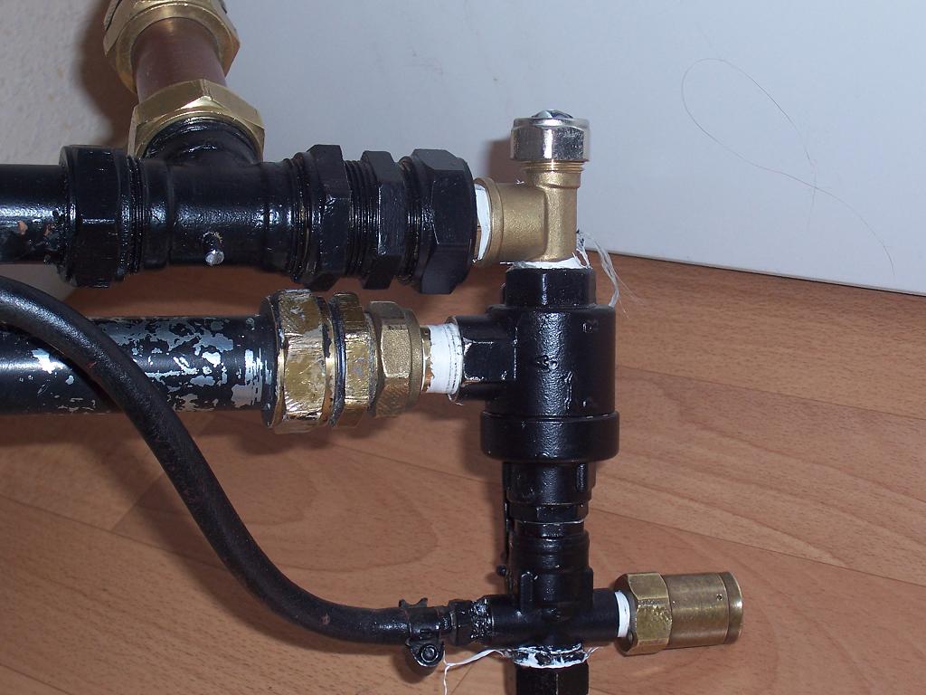

I have been tinkering with the pop-off to achieve higher pressures than it's set 11 bar, so far I can only get it to go up to 13 bar.I'll work on it some more coming week.I want 16 bar minimum, rather 20 if possible.

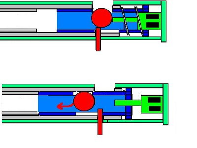

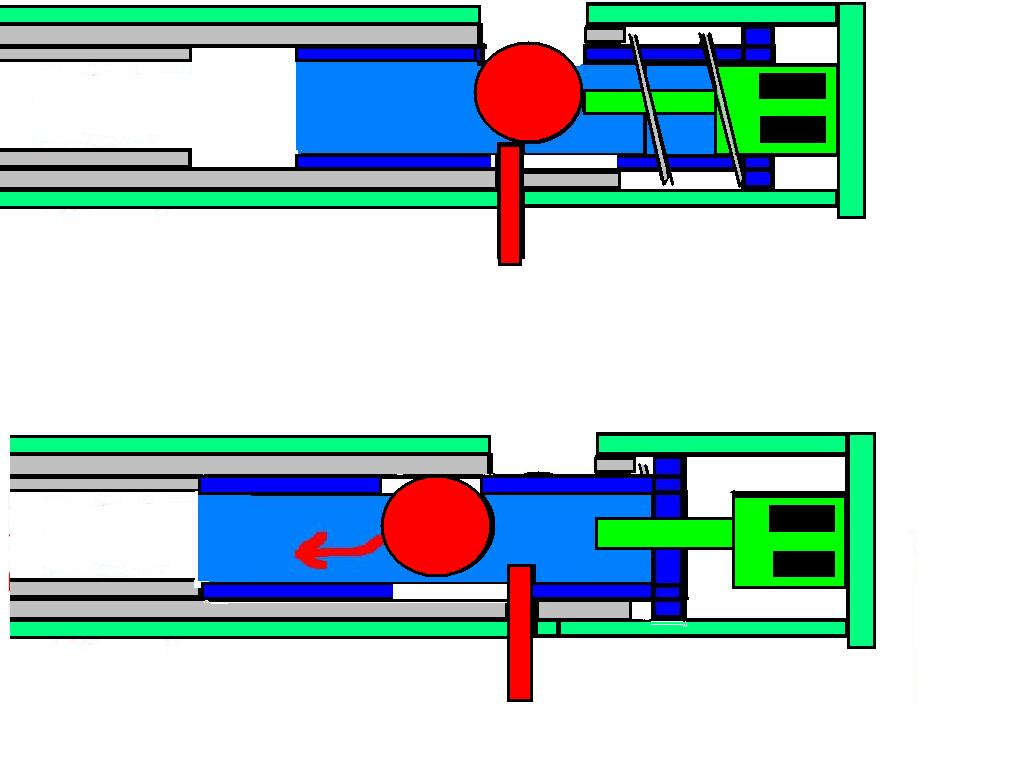

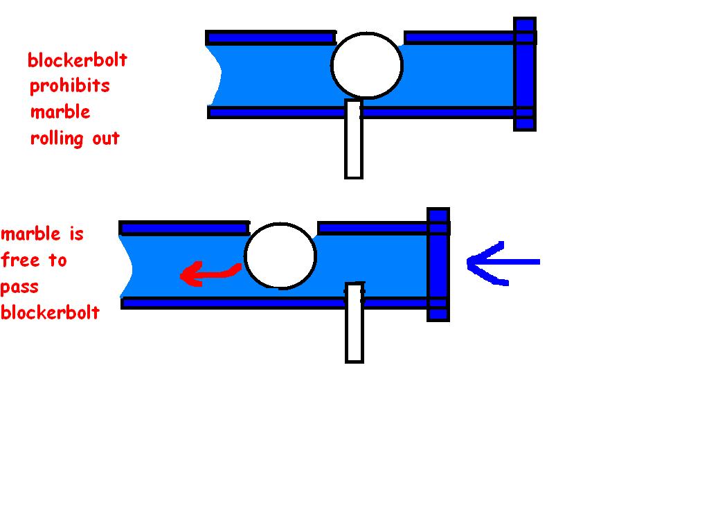

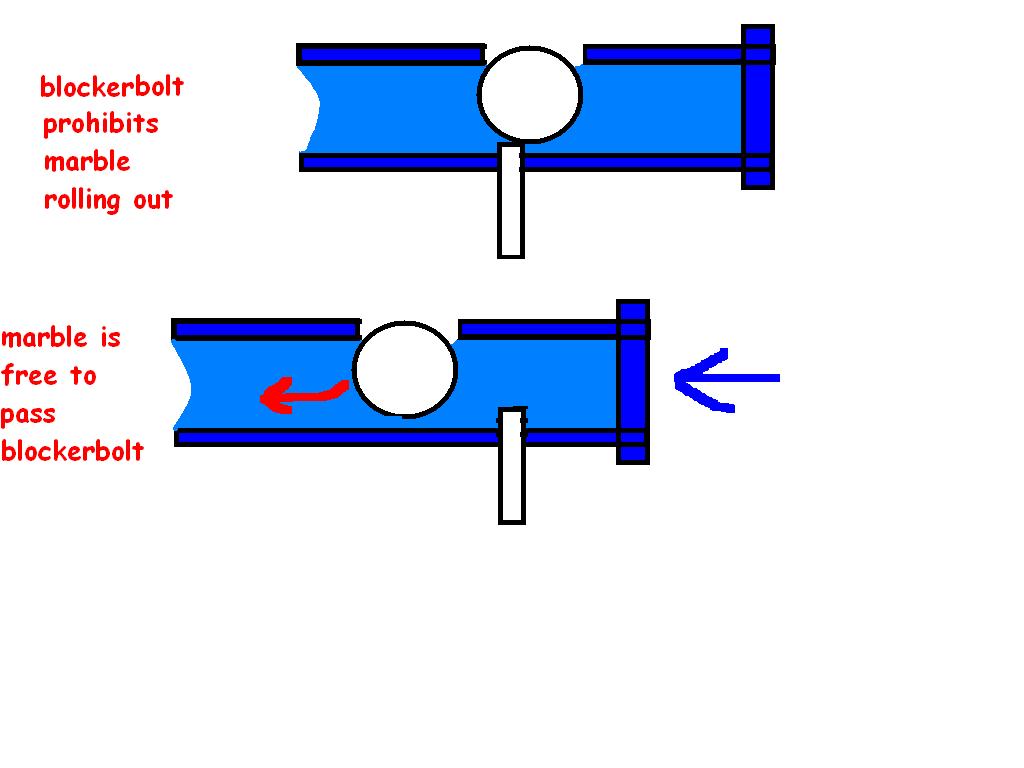

The bolt is a "regular" blow forward bolt with some additions.
I'll explain that with some pictures.

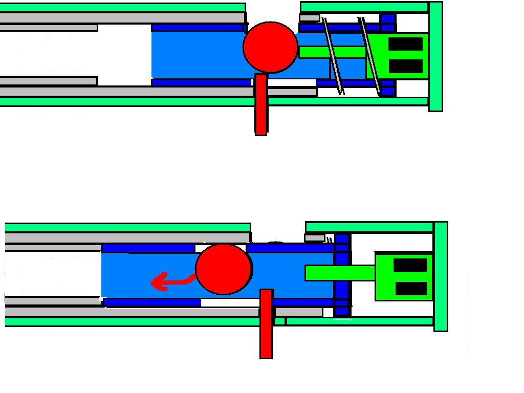

The bolt ensures a no more than one marble can ( ever) be loaded at a time and it prevents the marble from rolling out.It works 100%.
When the bolt is moved forward the marble is released.
I didn't want to use a paddle and I also dislike the idea of "blocking" marbles with an O-ring or a smere of silicone or whatnot.
All of those use friction and friction means wear and redoing.

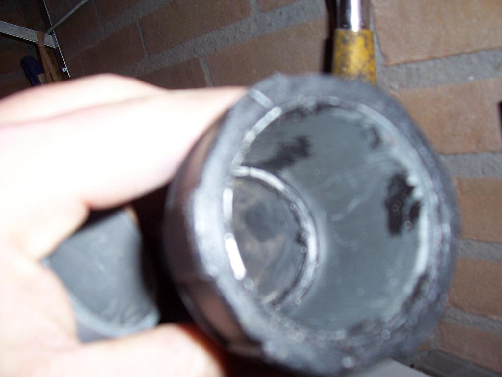

- THe "blockerbolt" is fixed to the tube in wich the blow forward bolt slides.In other words; it doesn't move, only the blow forward bolt does.It runs through a slot in the bottom.As the bolt is moved forward the marbles roll off the blocker and drops in line with the barrel to be fired.The hole in the top of the B.F., bolt provides the nessecary space for this action to work.The blocker also inhibits the blow forward bolt from turning, wich would mis aline the "drop-in"hole at the top of the B.F. bolt.
The back end of the B.F. bolt is a bit narrower in real life, wich also prevents the marble from roling back.All this ensures clean full auto bolt action without misfires of roll-outs
Now I gotta go listen to Bad English...Jesurs!!some of the most basic things can be hard to explain if English isn't your first language..

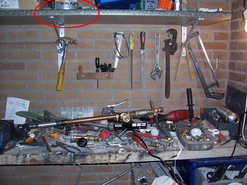

Well, at least you have a general workshop. I just use my garage and i dont have too many tools. But i have all that is needed to make a cannon. Well i am curious to see a video.

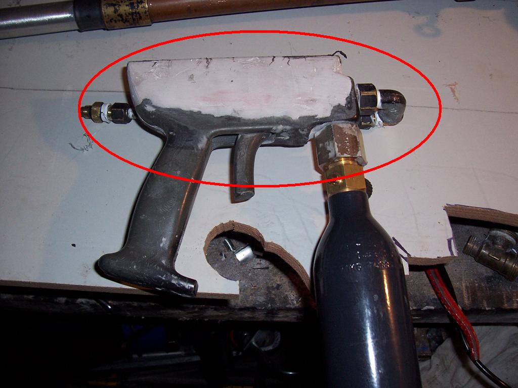

wow, looks great. I'm afraid I dont get how the marbles can slip past the bolt though... what did you put on the pressure washer handle? bondo?

THe top hole in the blow forward bolt provides just enough space for the marble to...well..be.. as the bolt travels forward.Without that entry hole in the top the marble would be unable to pass the blocker.

Oh and yes, I believe that is what you guys call bondo.
Body filler if you will.

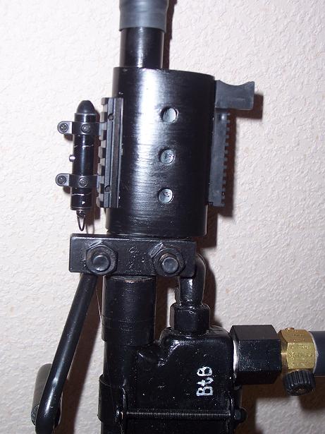

I can't wait to see a video of this thing. Once it's painted you should add a detachable laser sight (it would just be wrong not to add one on such a gun:).

The two laser sights I have now are from airsoft guns...not very sturdy or accurate.

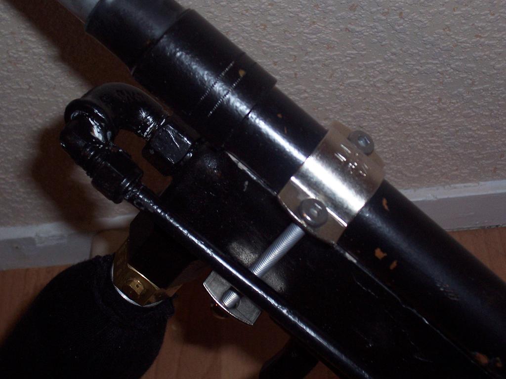

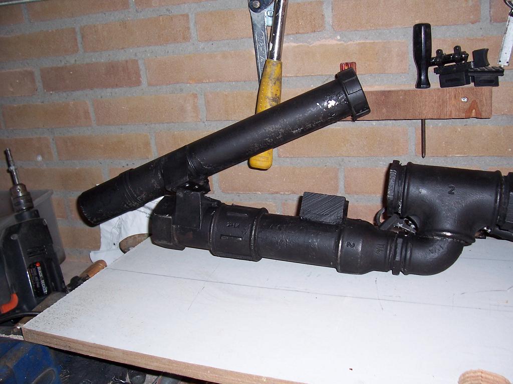

Still working on it.I managed to mod a safety pop-off.I tapped the hole that is normally kept shut by the piston thingy, and screwed in a 1/8 fitting.
THe goal was to make a smaller surface area for the pressure to work on.( I reduced the hole size so to say).
THis makes higher pressures possible.I'm aiming for 16-23 bar..somewhere along those lines..

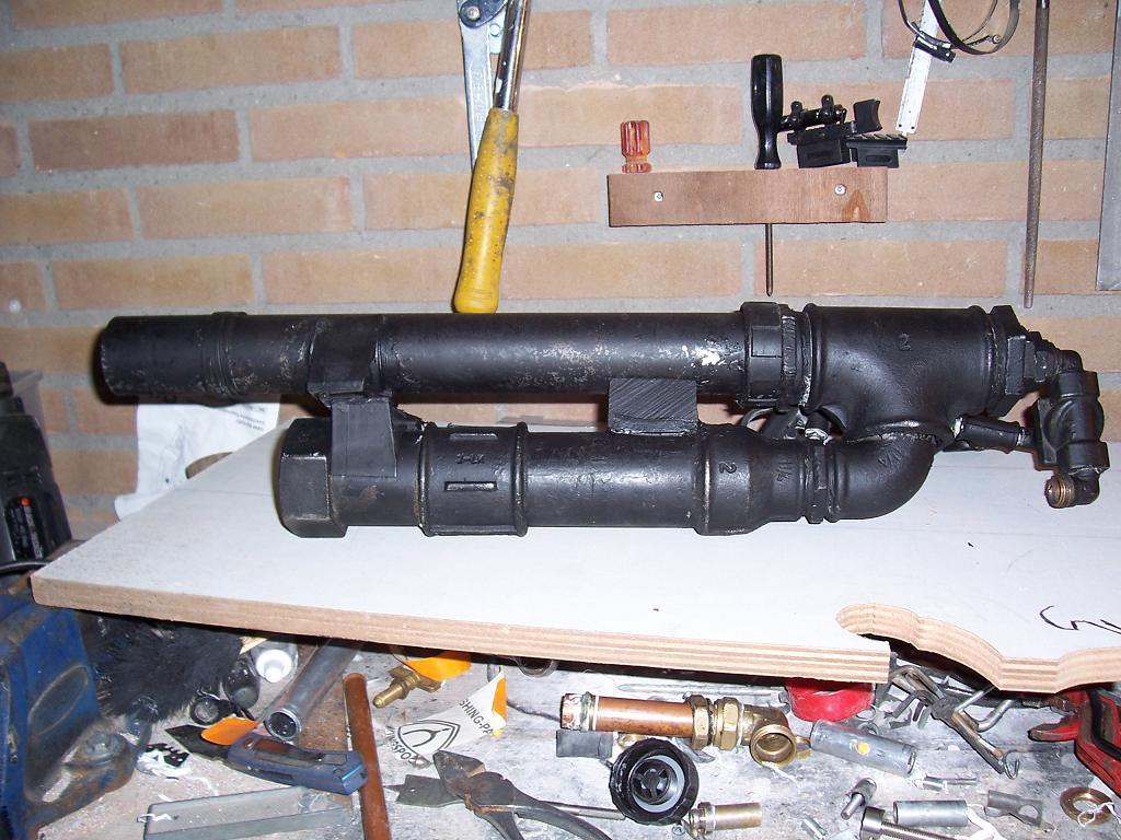

I reconfigured the gun to be more bullpup like, so without chopping the barrel, the gun is now much shorter.I used brackets to hold the barrel to the blowgun.glue kept coming loose wich in hindsight is a god thing because I would not have been able to change it.
..and I found out that socks make excellent cheap-o bottle covers.
I redid the chamber and found a better way of connecting it.It is now tucked away nicely.
THe temporary marble hopper will be replaced by a proper sports-drink bottle.I painted some parts before I changed all of this so it still looks unfinished
