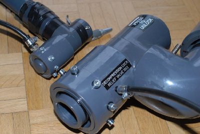

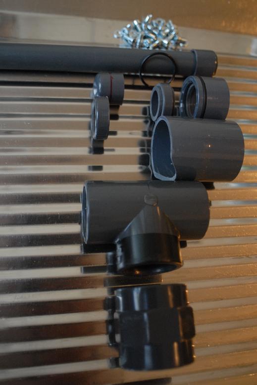

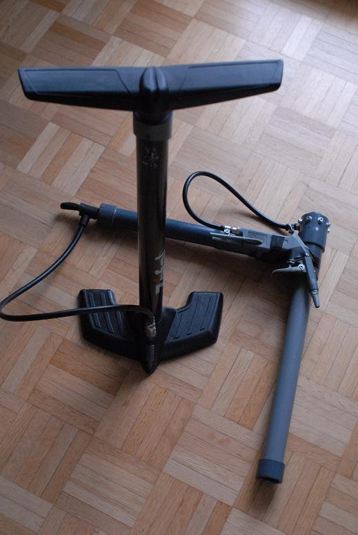

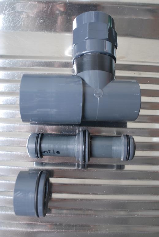

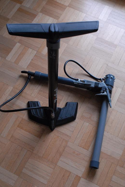

The SEX Pistol is a DFTV based gun; valve housing is a 32mm tee. For an explanation of the DFTV and of the terms used, see http://antennalaunchers.com/dftv19/.

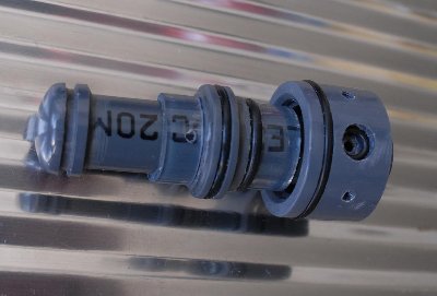

The main difference from the plain DFTV is that the exit disc and the vent disc are the same diameter, that the turbo disk has been omitted, and that the bolt is a pipe and is used as equalization hole.
This is really the same as the S-DSTV I once mumbled about; that was a pilot valve for conventional large barrel sealers. I simply added a barrel and a chamber, and then it became a SEX Pistol. Scaled, because I have a much larger scale-up of this in the pipeline .... (and I had it in the drain line too, if any of you read my story about how I blew up a clogged drain with it, that's it).

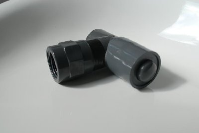

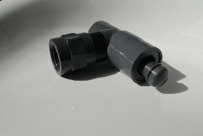

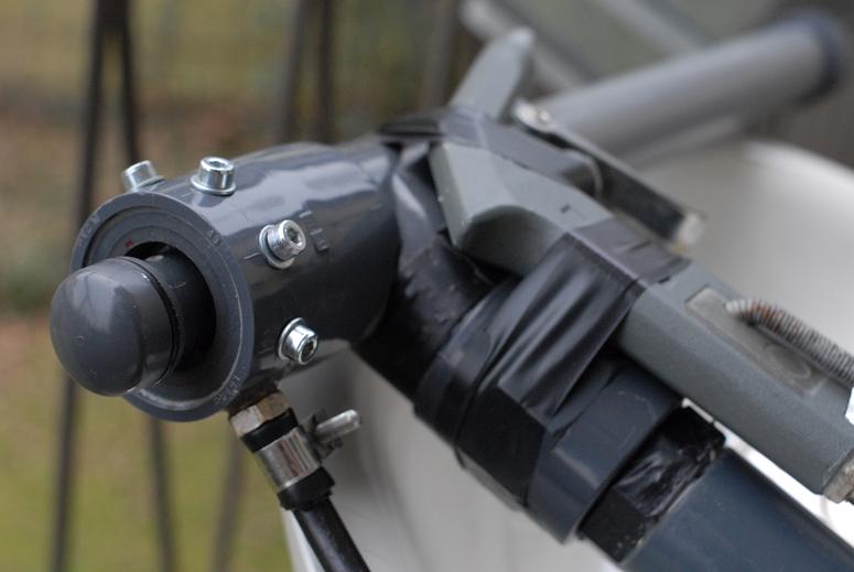

The PVC hose over the chamber end of the 20 mm pipe that centers the bolt/plunger is an RSCV (Ridiculously Simple Check Valve). It is the same as an old-fashioned bicycle rubber valve - a flexible sleeve over a hole in a pipe. The PVC hose around the pilot chamber end is a recompression damper - it seals pretty well against the vent disk seat and has some mechanical friction too.

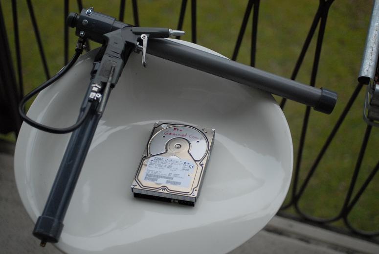

The performance of this tiny thing (exit valve diam. is only 25mm, or 1 inch) is quite impressive. I'll see if I can get some damage done and post it later.
Regards
Soren[/url]
The SEX (Scaled EXperimental) Pistol
- OOOoo kay, I reveal it: Why it is called Scaled EXperimental. Its good performance convinced me to ge ahead with a larger, meaner motta fokka version. It has a quite short barrel and a very high pressure (it's all PN16, goes up to 230 PSI water), and it can pump golf balls through virtually anything. It still needs an improved damping system - it has cracked its vent seat / breech. I have a top secret solution for that underway, but I'm too lazy to get it built.

Impressive, what pressures are you running at?

ooh grey pvc goodness, i get the same colour in the uk, i think its EFFAST pvc... and thats a nice looking pistol and i'm curious as to what pressure you run at aswell. maybe to improve the looks you could use a smaller higher pressure chamber (not that it looks bad now
Hi,
Yeah I did think about a stubbier chamber. Or a 90 deg elbow.
I have no pressure gauge on it, but I'd say somewhere between 6 and 8 bar.
It can take more, but the threaded connection to the chamber starts to leak before that. I need to either replace the chamber (then if I cement the chamber on, the valve can not be used as a trigger anymore) or just improve the seal.
Regards
Soren

The best ammo I have found is pieces of 25 mm pipe with some tape wadding around them and ice inside. I will try do some damage pics with that. And maybe also with a 25mm barrel.
