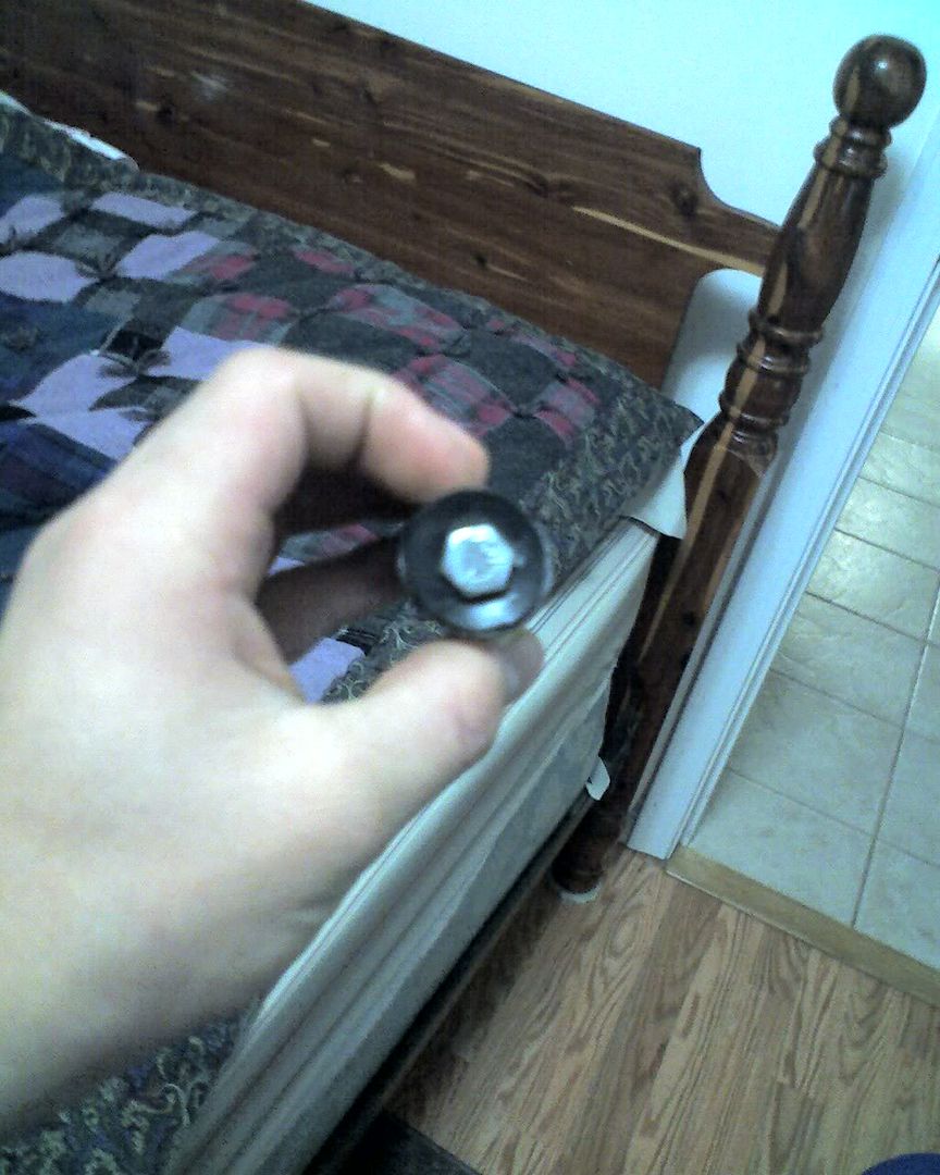

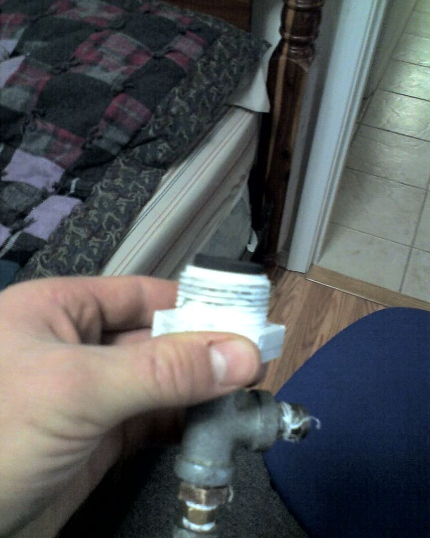

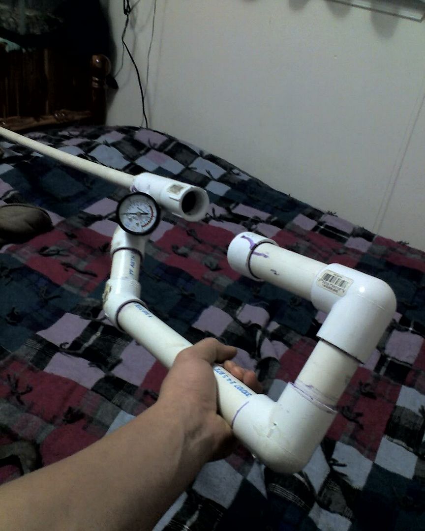

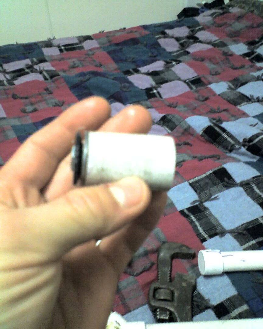

I've made 2 other valves exactly like this and they worked fine piloting off a modded blowgun... ( reason I cant use the other valves is because I have a 1" female adapter glued on the chamber port, they where used to pilot a 1.5" piston valve) this one doesn't want to cooperate with me.
Specs:
Housed in a 1" tee
Piston is a .5" coupling sanded down to fit tight but still slide easy
Neoprene rubber sealing face
a rubber cylinder from an old fax machine, grinded down to fit as a bumper
Pilot is a modded blowgun
amount of air to pilot looks around 1 to 2 ci of air
piston travel is .5"
I fill up the gun, hit the trigger and all the air rushes out, I remove the blowgun, cover the hole with my finger, fill up, let go, it fires great...
Here's some pics

Well the obvious has already been posted so howabout stickiness of the sealing point?
I can't imagine when you're using a finger over the port that you're using particularly high pressure, but with a blowgun and the 1/4" ball valve I'm guessing you're using higher pressure.
It might sound unlikely but if the seal of the rubber against the barrel is greater than the force of air at those higher pressures to push it back then the piston won't move.
Feel like humouring me and, I don't know, oiling the rubber sealing face? :wink:
Killjoy
Posts: 1052
Location: New Mexico
You know hot wired you may be right, Cause the same thing happened to me. The rubber would "cling" to the sealing surface in that as the piston would try and pull back the extra width on the rubber would hold onto the sealing surface until almost all the air was gone.
So I would recommend trying to secure the sealing face's sides down on the piston or trimming it so theres very little excess sticking out arouns the sealing surface.
