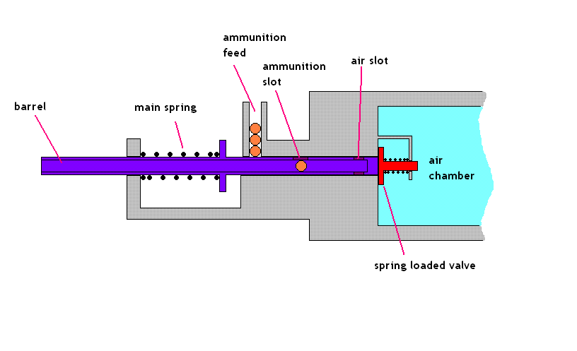

A while ago I came up with a design that used an electric motor to cock a hammer valve that basically consisted of the barrel itself. looking at it, it would probably work just as well without the motor, though you'd need to add a latch that would hold the barrel in the cocked position.
It's fairly straightforward, the diagram shows the mechanism at rest. To fire, the purple barrle section is pulled to the left, this compresses the spring and allows a projectile to drop through the ammunition slot. The barrel is then released and moves to the right, sealing the ammunition slot, and knocks open the red valve. This allows compressed air to escape through the air slots, firing the projectile, as well as pushing the barrel back forward in order to enable the sequence to restart.
No plans to build this as of yet, just thought i'd share the idea.

were you shooting for auto or semi-auto?
if auto, i would think the rof would not be that good. how fast would it take for the air pressure to drop to the point of not resetting the barrel far enough to open the hammer valve?
if just semi, i could see using a cam to cock the barrel.
two of these side by side with a cam setup for fire control would give this the AT-AT feel.

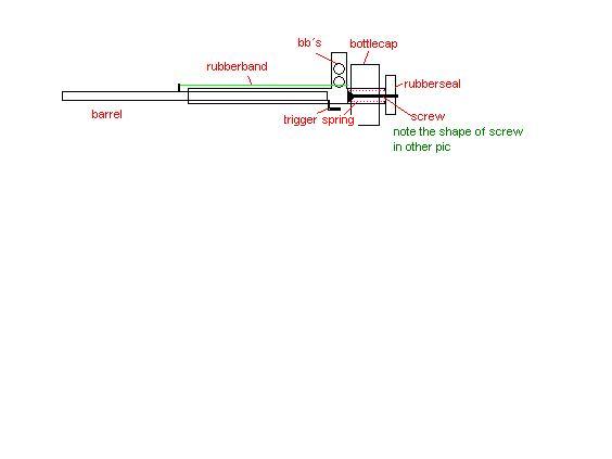

mh this is the same design what ant use in the bb-gun i think...

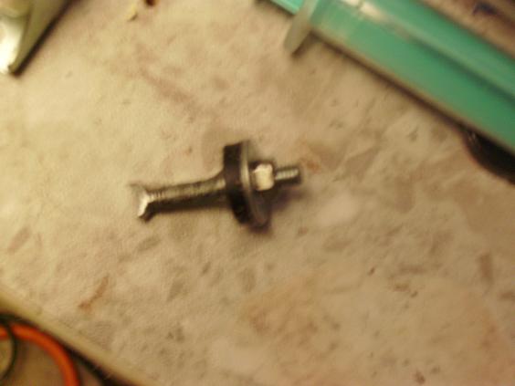

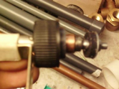

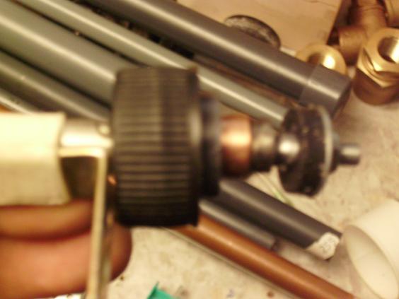

here pic to show my version of valve is much easier
i fit it to an cap of plastic bottle

Looks almost identical to what ant made.
Posts: 26220
Been thanked: 352 times
Hawkeye wrote:Looks almost identical to what ant made.
So it is, I hadn't seen his diagram.
Ah well, I had posted the original electric driven version here (scroll to the bottom) in August so it's a case of great minds think alike :P :wink:

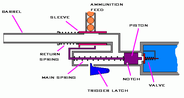

What we can do is give the bolt a larger area, and there are several ways of doing this. Here's one I had come up with - similar to some painball designs - but never built:
I had also made an attempt at a simple Caselman style direct blowback design (originally intended to be electrically driven) but it failed for the same reasons, I had though of a way of solving the problem by applying the same larger bolt area rule, but never actually built it:
