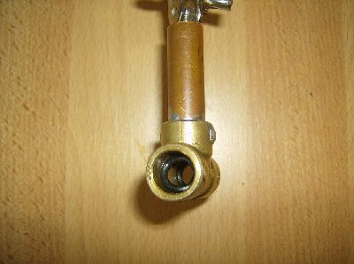

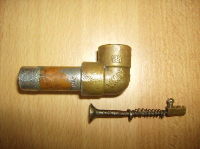

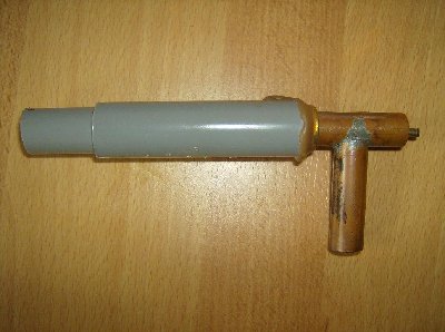

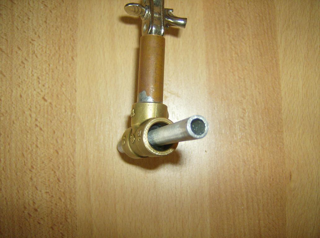

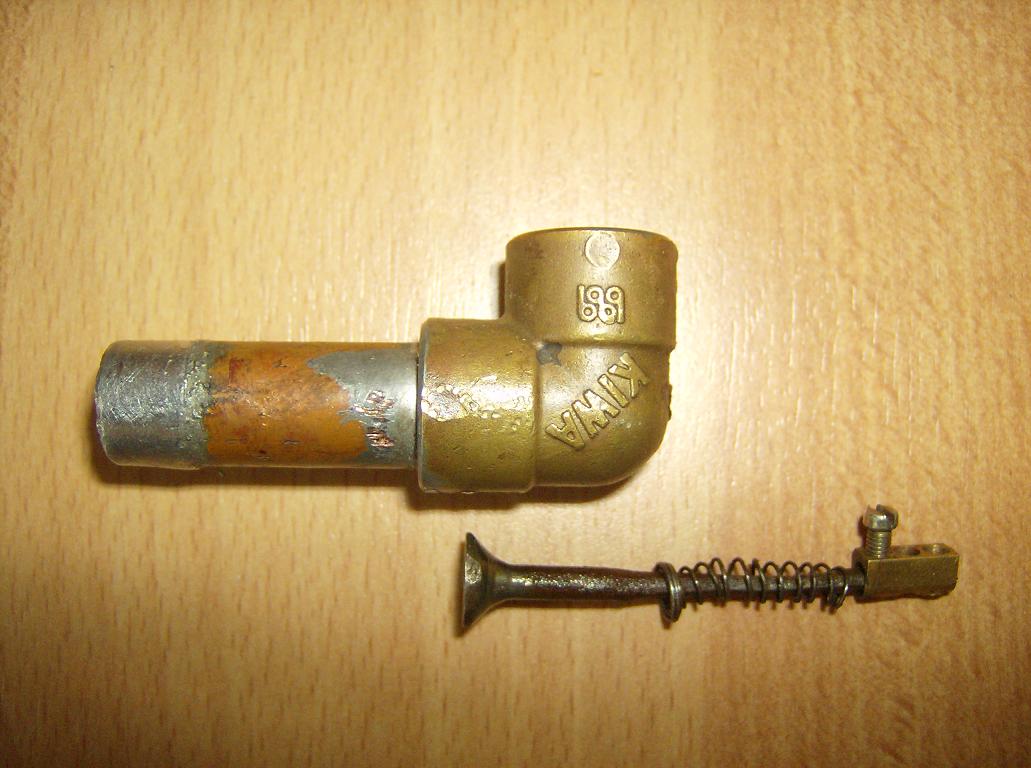

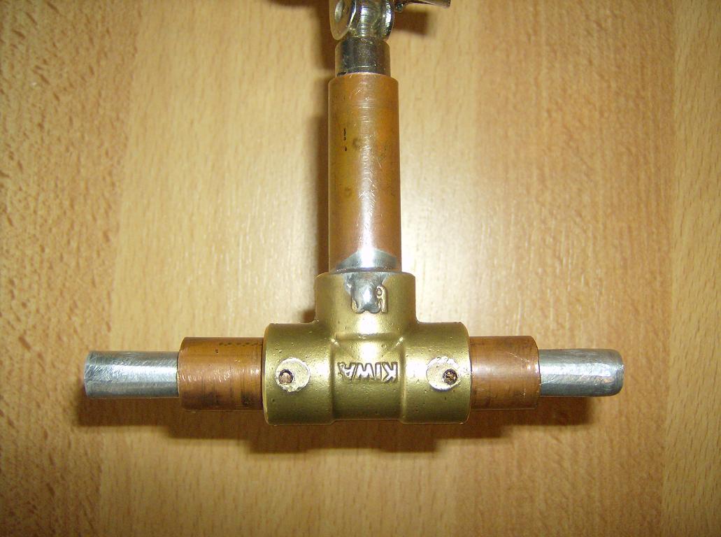

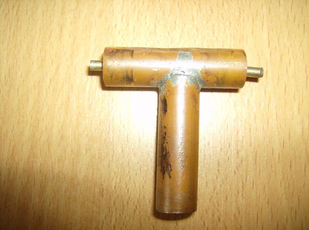

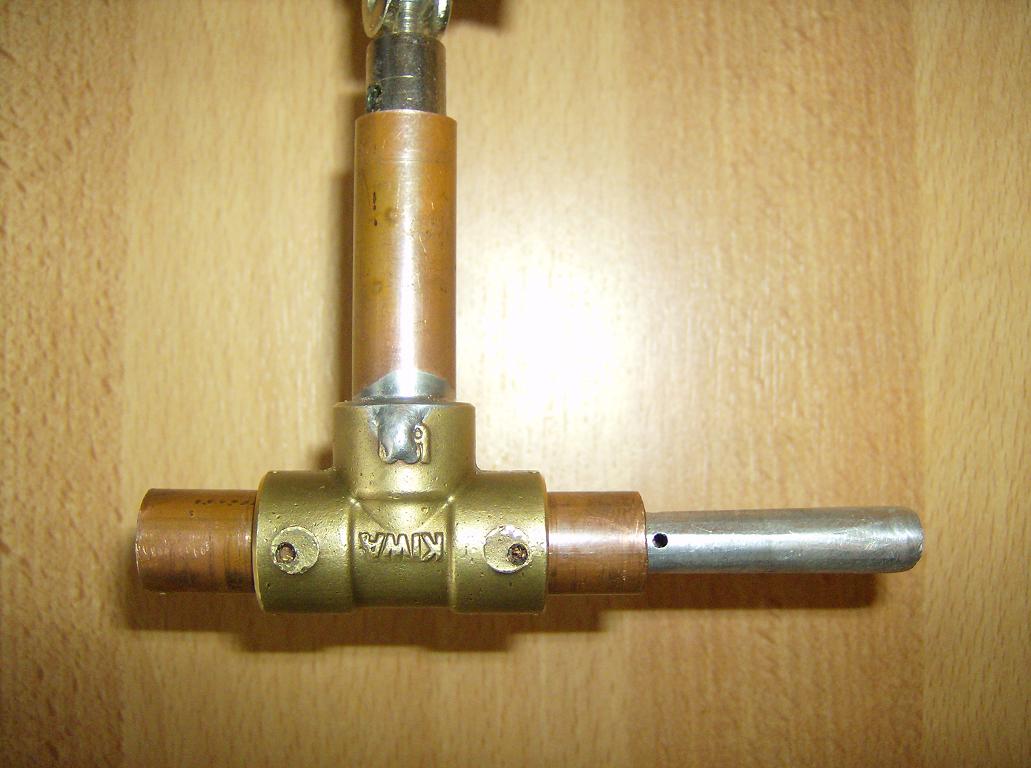

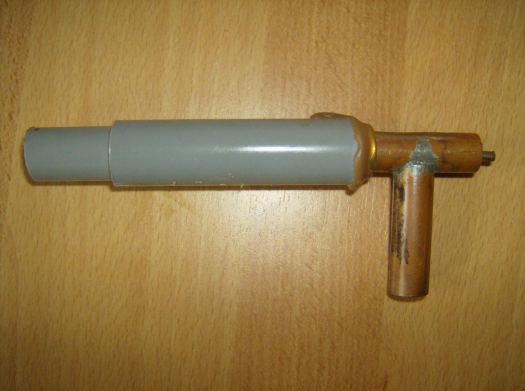

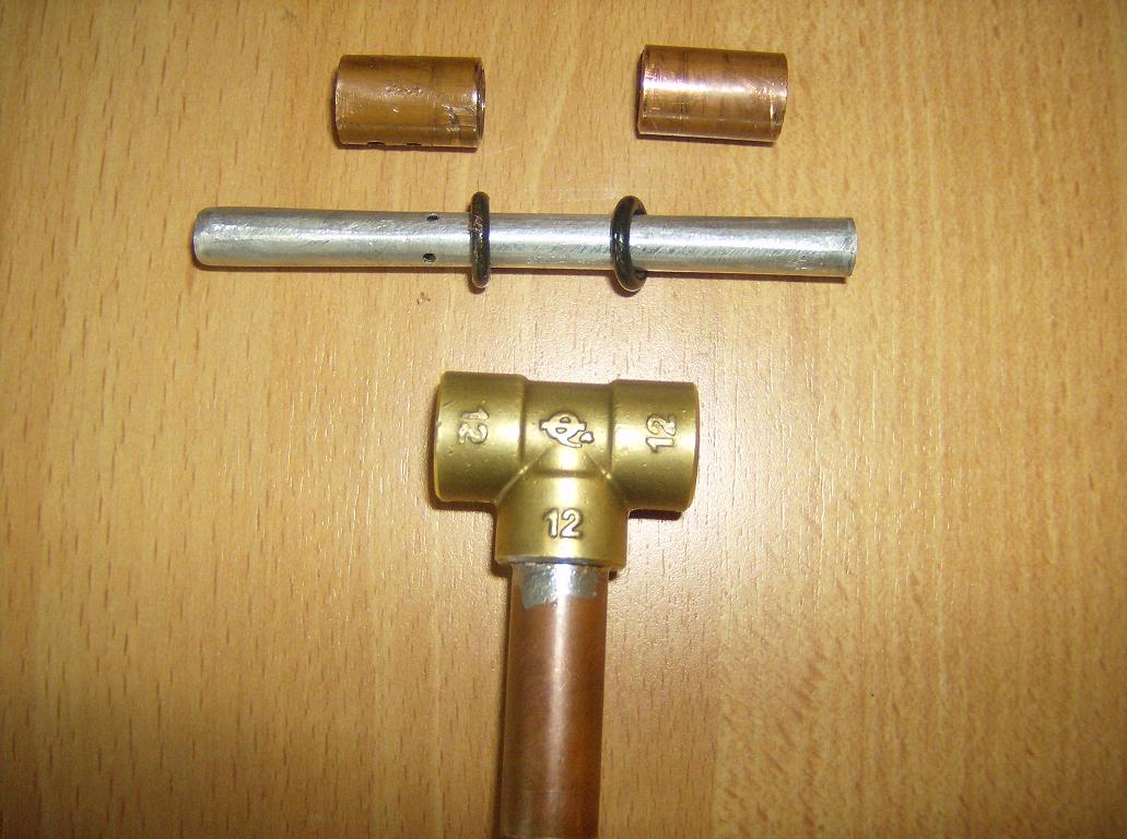

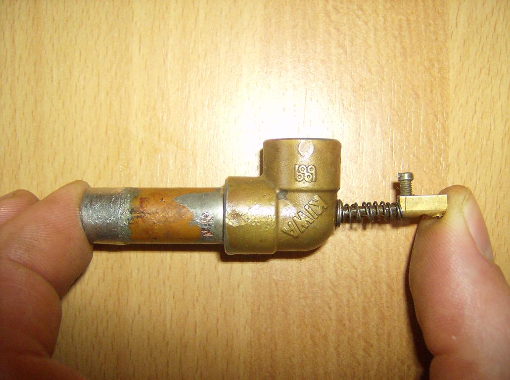

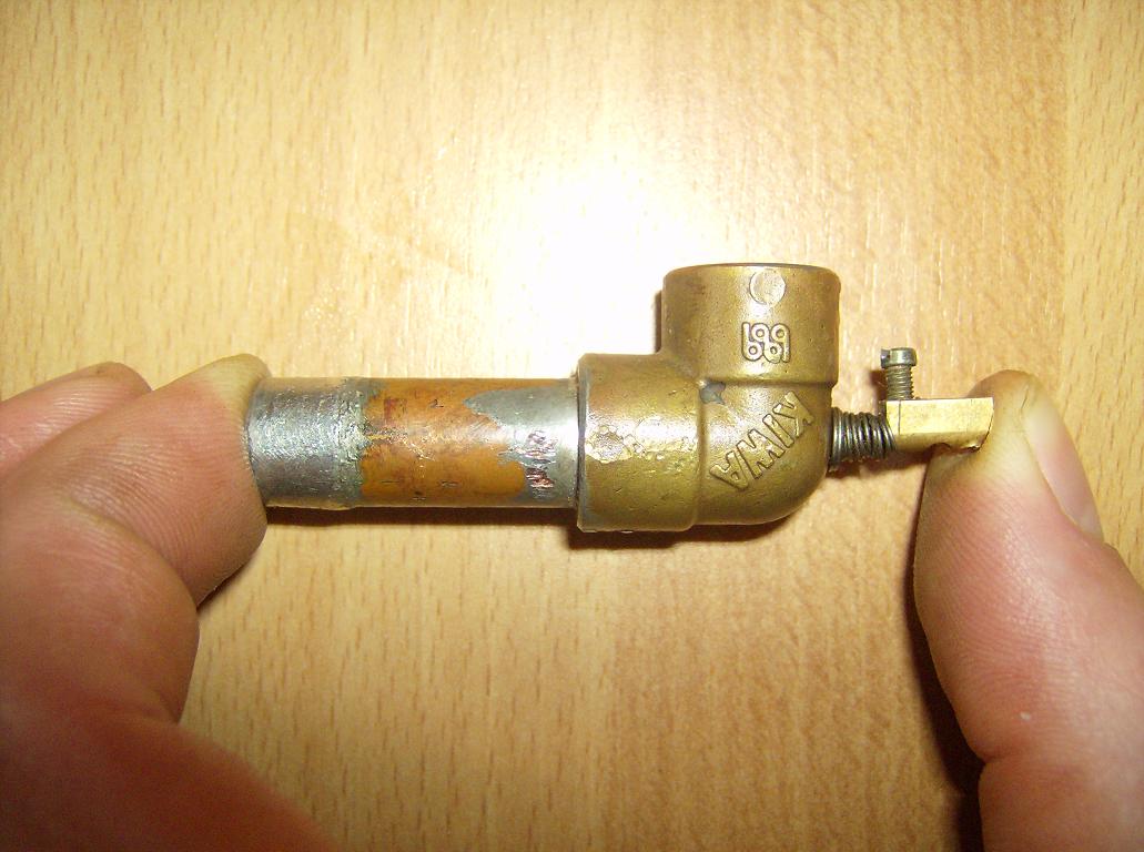

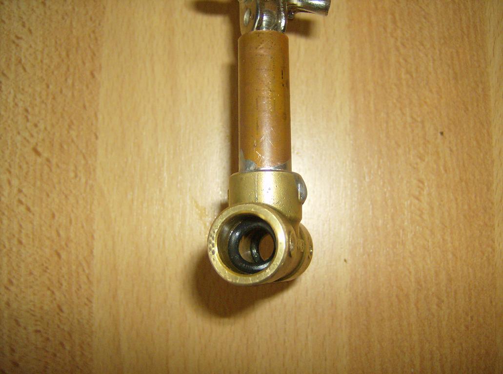

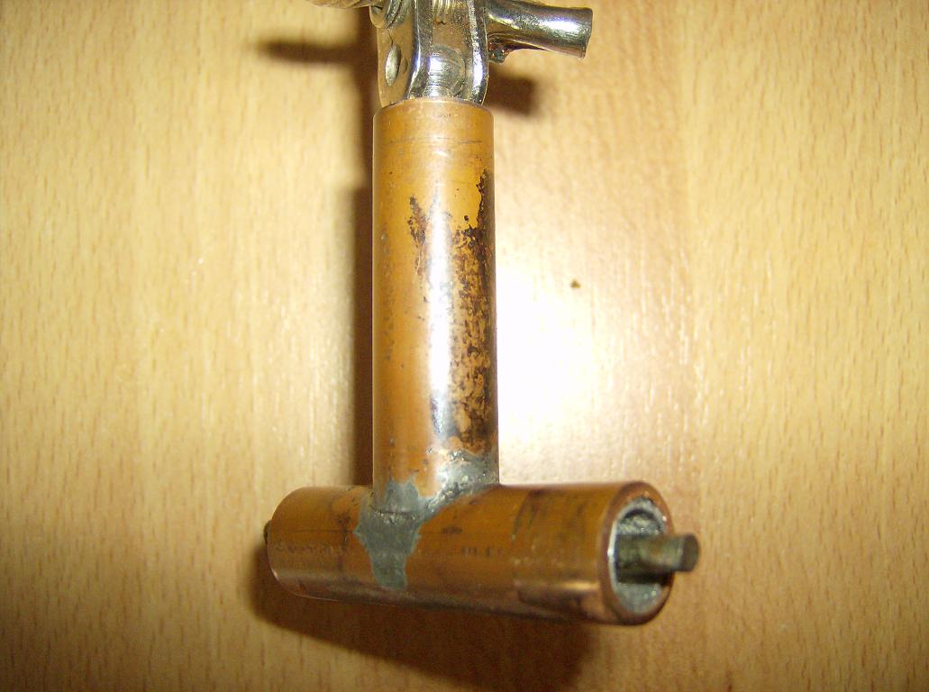

Different kinds of valves I made and that work:
1 Poppet valve with ballpoint spring, 90 degrees bend flow
2 Tippmann type of valve, two poppet valves on two sides, can be used for blowback designs
3 Drozd sliding valve, slides forward and takes a bb then gives a burst of air

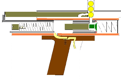

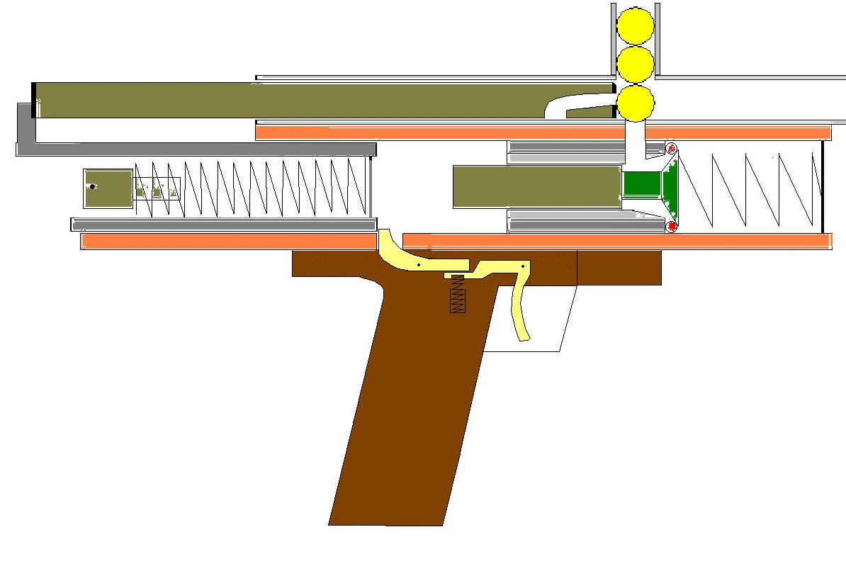

wow nice valves although i don't quite understand what stops all the air being released on the stacked tube valve design?
On the animation of the green part is a screw it has a spring at the back which keeps it closed. The o ring is colored red. When the hammer (brown) hits back the poppet valve gives a short burst of air. Bc of the air pressure and the spring behind the valve it closes again.ALIHISGREAT wrote:wow nice valves although i don't quite understand what stops all the air being released on the stacked tube valve design?

very nice, these popet valves are just like the ones on blow guns but usually when you make them much larger they become too hard to operate so it requires the force of a nice hammer blow I've recently noticed that moded pizeos can be used to made hammers to strike the valve instead of the piezo crystal
oh and the holes on valve 3 are way too small if your afraid of making it too long (but so for its fine) you can make a slot probably with a saw
the rod on valve 1 is not quite clean enough looks like you ghetto drill press lathed it, do you have some tap and dies you could thread the tip of a rod and add nuts and a washer or sleeve it in some tubing
Last edited by iknowmy3tables on Sat Jan 05, 2008 4:46 pm, edited 1 time in total.
Yeah you are kinda right. The problem is that the holes are not supposed to rip open the orings lol. So yeah its kinda hard. But my main problem on the sliding valve is that it moves really ...viscid. Too slow for fast operation due to the orings.iknowmy3tables wrote: oh and the holes on valve 3 are way too small if your afraid of making it too long (but so for its fine) you can make a slot probably with a saw

I got a question about the trigger group on your second animation, the one entitled “stacked tube airgun smaller.gif”, they way that spring is positioned it’ll keep the sear designated, is this intentional, and if so why?

[quote="judgment_arms"]Ant, between you and jack I’m really beginning to fell like a slacker, ‘cause I’ve bean working on the same type thing as you two, and I still ain’t got nothin’ to show…
Oh, well.
quote]
Hey nice to hear from ya! Its nice that lots of ppl are feeling boosted by all these projects here. To be honest though I have been working on these airguns for some years already. So not that it seems like that my project pop out of the ground like mushrooms.
The trigger, yeah the animation is actually wrong. As in this gif program I used I coudnt rotate objects so I wasnt able to make a good animation. Now that I look closer.. the spring should be at the backside of the sear and not at the front close to the triggers pad. Ill change this, thnx for telling me. Shows atleast some ppl are looking closely to my postings. Btw the spring doesnt have to be a pressure spring, it could also be a tension spring, so ill leave it to that for now
