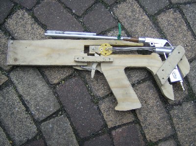

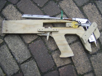

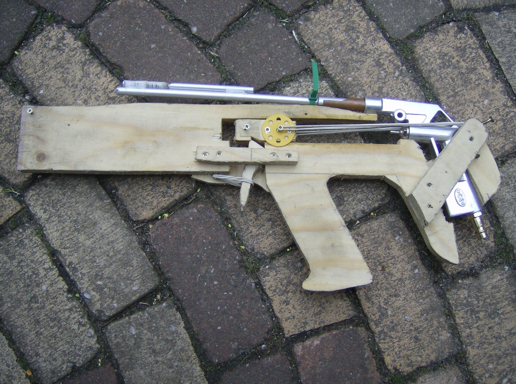

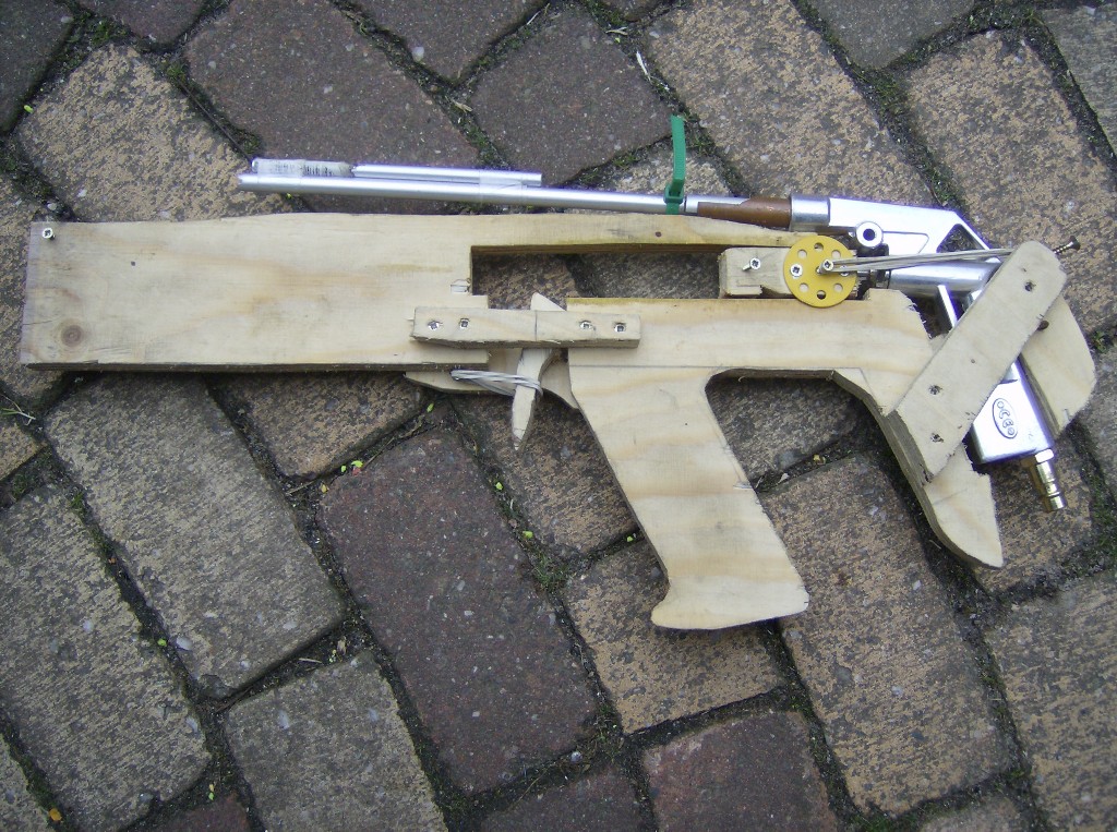

P. 1 Very simpel airgun2
Antonio
Posts: 508
This airgun works on a blowgun and it shoots around 100-150ft/s

yeah or you can hook it up to a bottle, its not really exciting but it works.
finally, someone proved my long promoted idea that you can use a blowgun as a hammer valve :D

jackssmirkingrevenge wrote:finally, someone proved my long promoted idea that you can use a blowgun as a hammer valve :D
Yeah as I have said in a other post sometime ago is though that the ports in the blowgun are really small. I tried to drill ehm open and broke the blowgun. Another problem is the low dwell time due to the strong spring behind the valve. I have shown it works but it shoots significantly slower then all my other guns. But its sooo uber simple. Eventhough I say this I wont work on this project no more as it was just to show that it works. I dont think it has much potential due to its dimensions and limited flow.
I'm aware that it's not the ideal type to be adapted to a hammer valve mechanism, but it's self contained and ready made so it would not involve too much construction for a person with limited facilities.

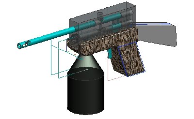

Hey thnx :) Its like I make that many though. Some are old ones I had laying around. Btw I have been working on this new auto design: [youtube][/youtube]
but when I tried to make it I realized everything had to very precise and it didnt really work out. I wish I had a milling machine or something, then I could make a stacked tube type of spyder bb gun (check the attachment>I made it myself sometime ago I am not sure if I should post it though as its not really something physical)

My major problem at the moment is my use of materials. As I am working on this automatic bb gun right now(with the same valve) the parts start wearing and deforming due to the forces and impacts. What I have in mind atm is a 20 shot auto (with semi trigger) that works on a 1.5L 8bar bottle.
