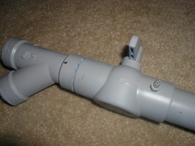

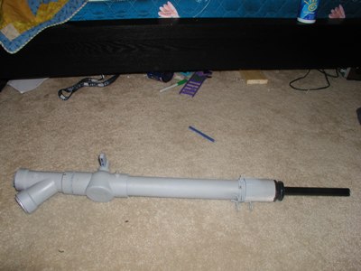

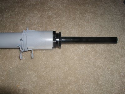

this is my new piston gun.Its called a "naval" gun becase it kinda reminds me of a gun that would be mounted on a battleship.

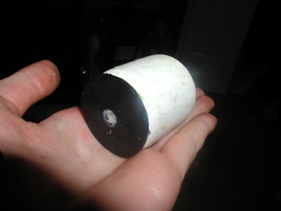

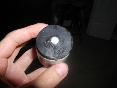

The piston is a 1 inch cap slightly sanded down and has a neoprene washer for a sealing face and it works perectly.
The camber is 1.5 inch sch 40 pvc with a 1.5 inch ballvalve for a pilot and it usees a shcrader as a fill valve.
Barrel is 1/2 inch pvc and ther is an old rag as a bumber.
Tis gun has power! and seals perfectly! the only thing to complain about is that the bumber comes put some times but oh well. :roll:

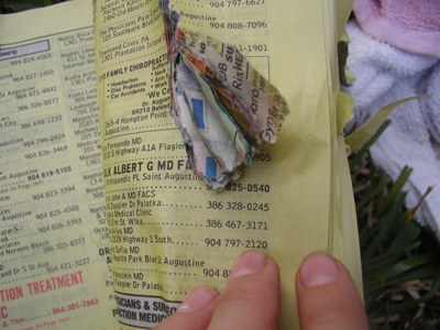

DAMAGE! from 5 ft 60 psi.

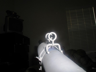

the sights.
the sights.
barrel and bushings...

piston sealing face.
piston
piston

what are those sights actually made of and can i expect to see any damage pics soon.

idk what the sights are but they work oh and the dwv is fine its just to direct pilot exhaust so there is never any pressure on it.

@ the guys above concerning the Y
Isnt the Y unpressurized and just open to the air?
Like being some sort of stock?
Im not of that sure but just a thought.

Yup ur right psycix its just a stock so i can aim it better it also helps direct the pilot airflow away from my face. :wink:

Haha. Sights are funny.
Well..if they work than they're fine.

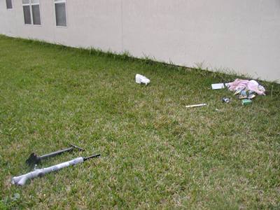

more damage! all was done at 5.5, 6, and 9 ft
the setup.
the setup.

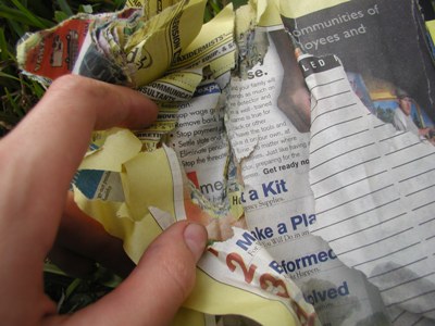

entrance
entrance
exit
exit

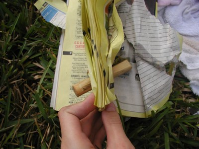

phone book,6 feet 90 psi.

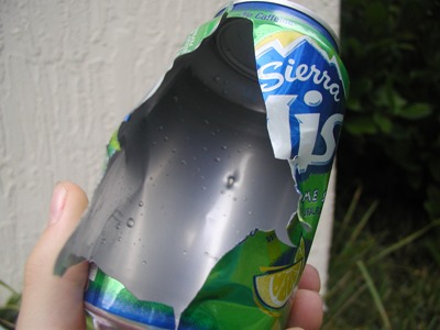

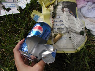

full can,5.5 ft, 80 psi Ammo: wood dowel.
full can, 5.5 ft, 80 psi ammo:nail
