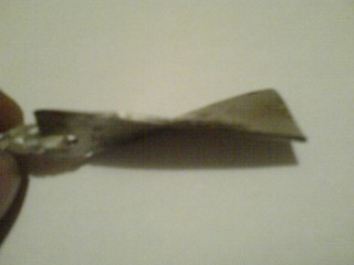

I managed to put lots of groves inside the pipe with a piece of steel that I formed into a spiral shape and attached a rope to it... the twist rate is about one twist / 15 - 20 cm... I fired 5 shots with this and it seems that it helps with accuracy but I have to test it more... All the shots were consistent but the marbles hit always a bit to the left.. I noticed that it must have been caused by the last 2 cm of the muzzle that I abused a little while trying to remove the ABS pipe from the 3/4" steel pipe....

here is a pic of that twised metal thing that I pulled several times through the ABS pipe (lol it looks great as it rotates inside the barrel I'll make a video of this if my tests show that this rifling is really good and it does not wear out )
It has sharp edges on one sides and a hole to pull it.
