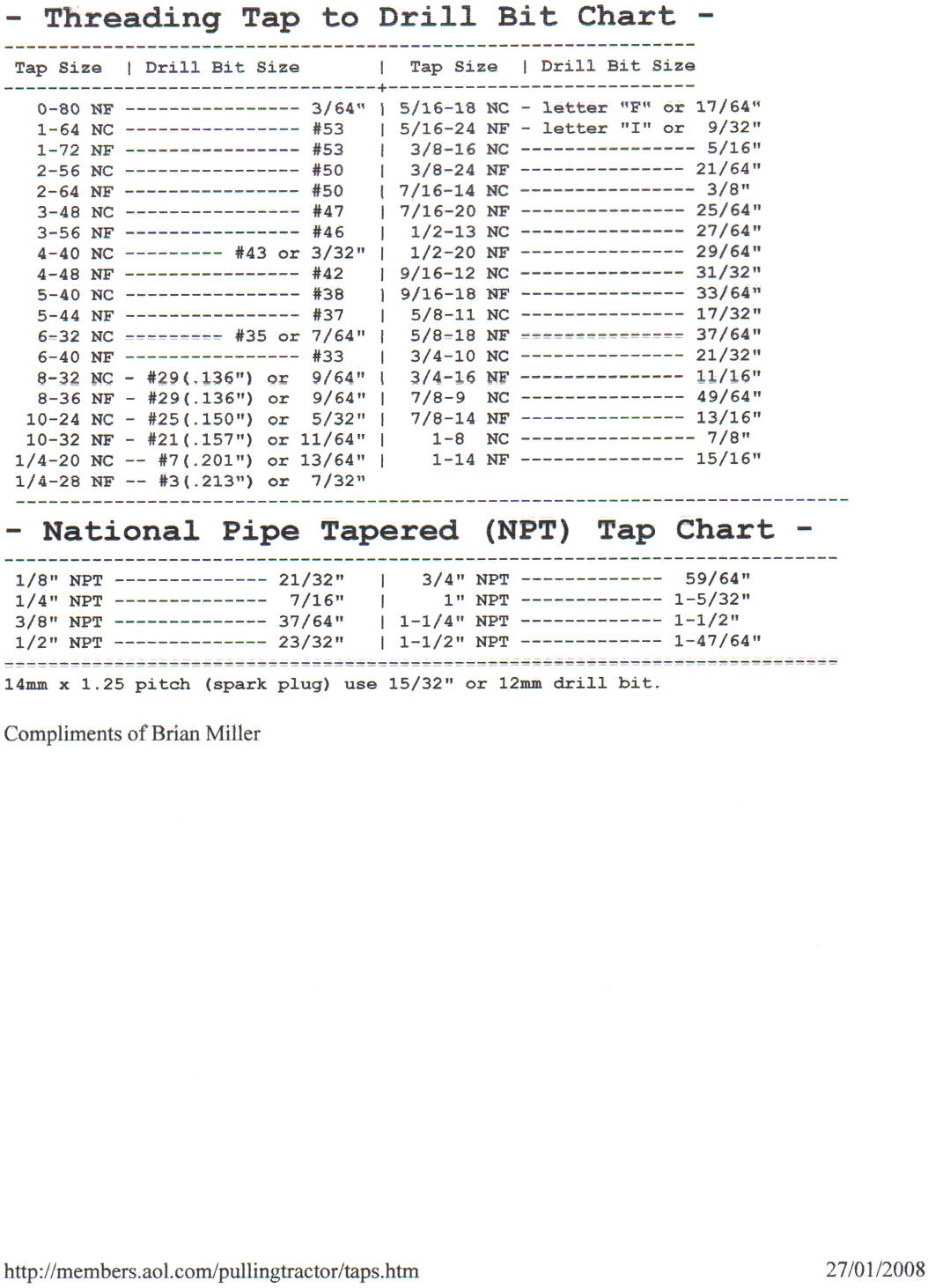

Taps may be a little costly but great for confidence , just knowing one part is done safely. Right on the tap the proper drill bit size is stamped .
Right size bit and tap used on PVC will last for ever. Give it to your grand kids!
Hi,
Is there something wrong here? 21/32 inches for an 1/8 inch fitting?
I know that the 1/8 inch is not to be taken literally, but that hole would be so large that the whole fitting (I have lots of them so I should know their approx. size) would drop right through it ....
Regards
Soren
Regards
Soren
That chart has a severe problem. It shows the hole for 1/8" threads as being larger than the hole for 3/8".
just read the tap
