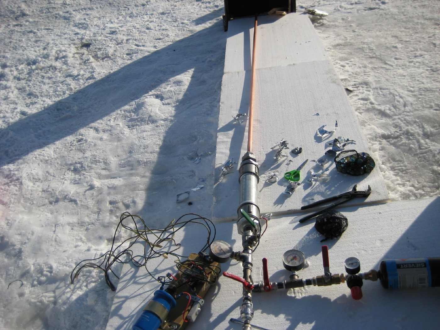

chamber: 8" of 2" galvanized pipe. "little bigger with all the couplings"
barrel: 18mm copper barrel 6feet long for small marbles.
(defect) barrel2: 1" copper 3feet for big marbles and 100g steel bolts :D
ignition: primitive camera flash and ignition coil.
union: 1"
burst disk: 16 layers aluminium foil at 4x

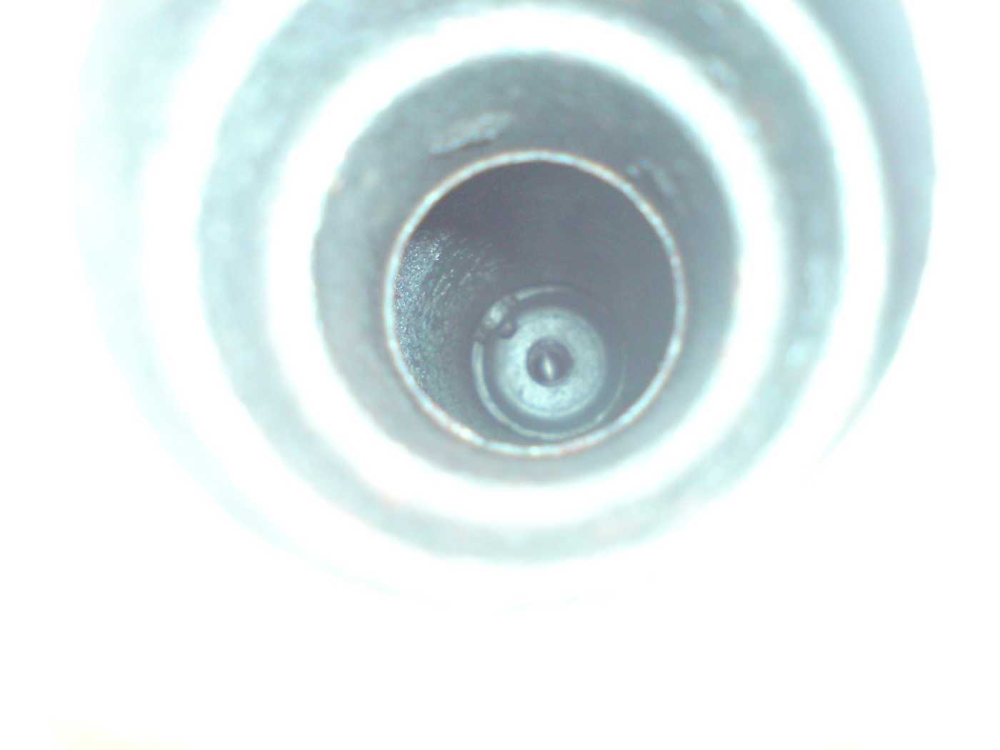

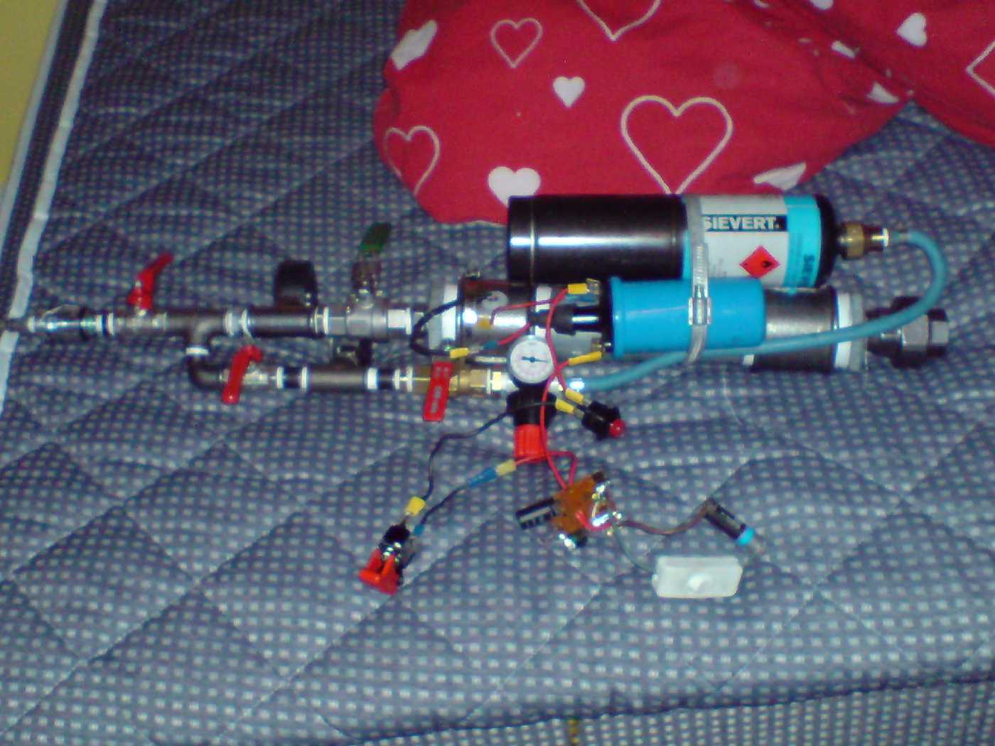

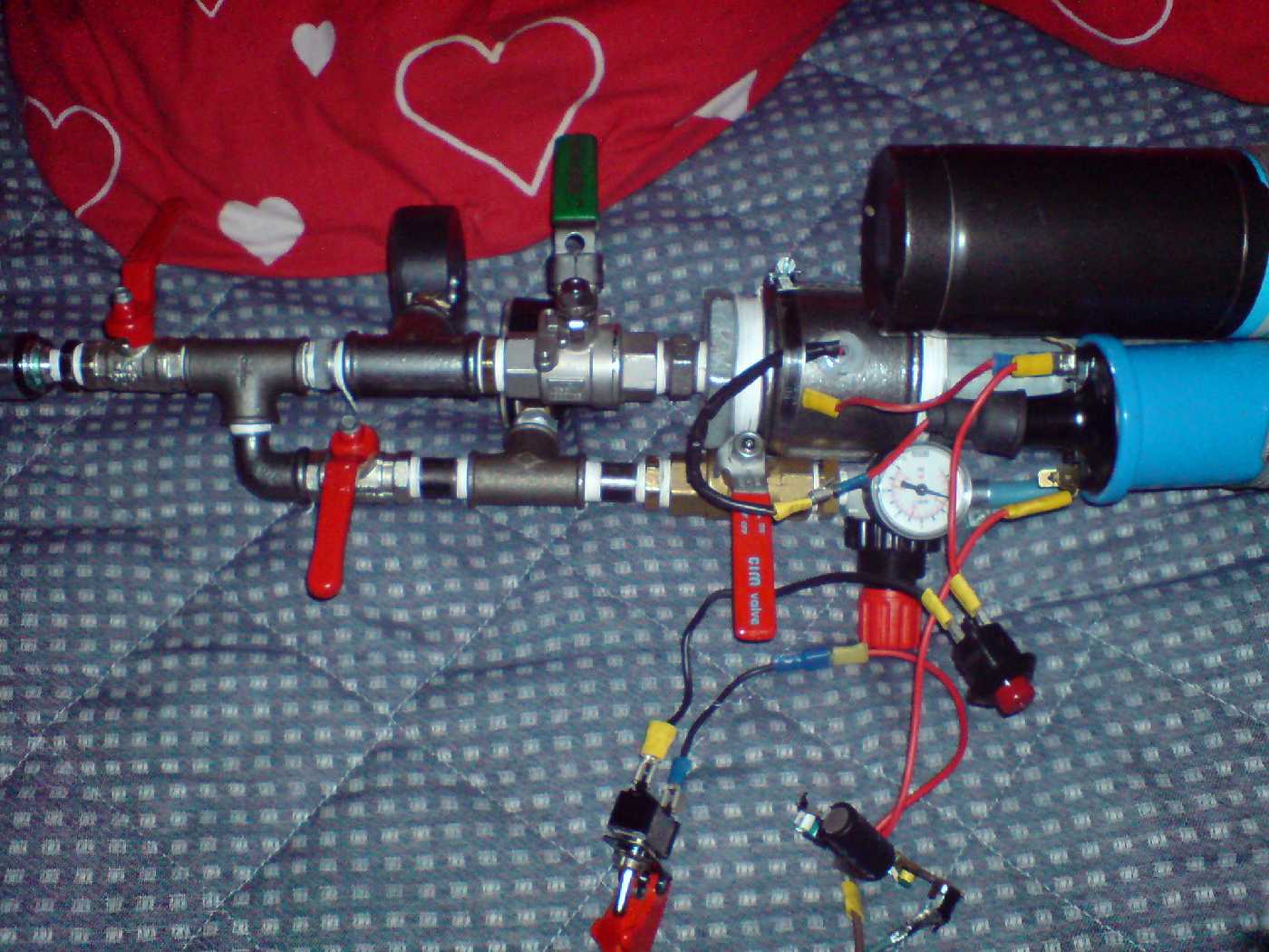

i converted my hybrid into a handheld launcher for more enjoyment and i ran onto some small problems.

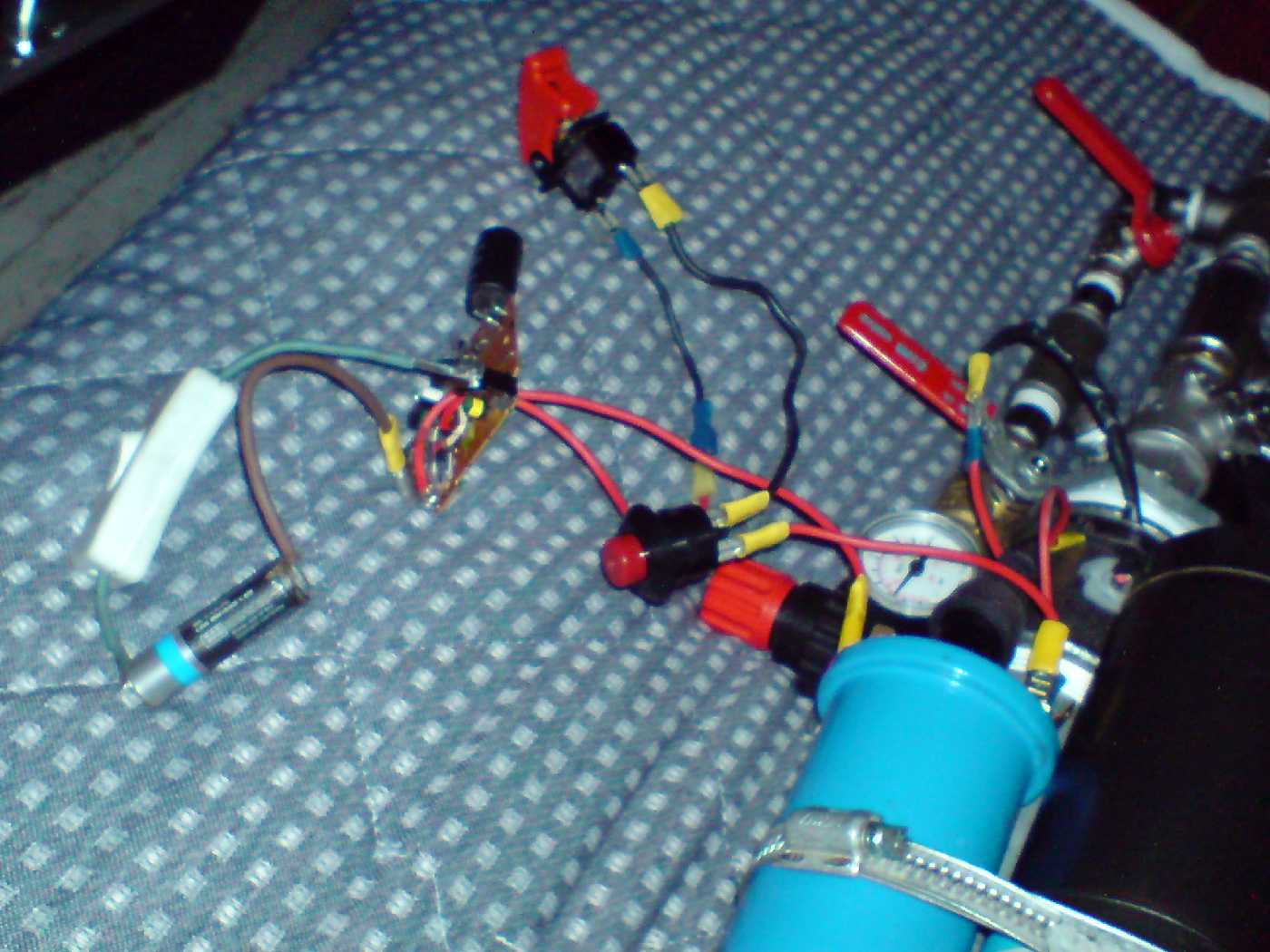

the trigger and safety switch are on the negative side of the circuit board (galfisk said you got smaller risk to get shocked then) before it was like a nightmare when i was in contact with the gun on ignition i got a BAD shock!
i have accidental leand on the meter of the gun and fired today and i didn't get a shock is it a difference on were you hold the gun?
if not i just try it out tomorrow!
tha clean way to hide away all the damn wires!!!!!!!
i will ask on the images' description!
sorry for bad english and grammar :oops:

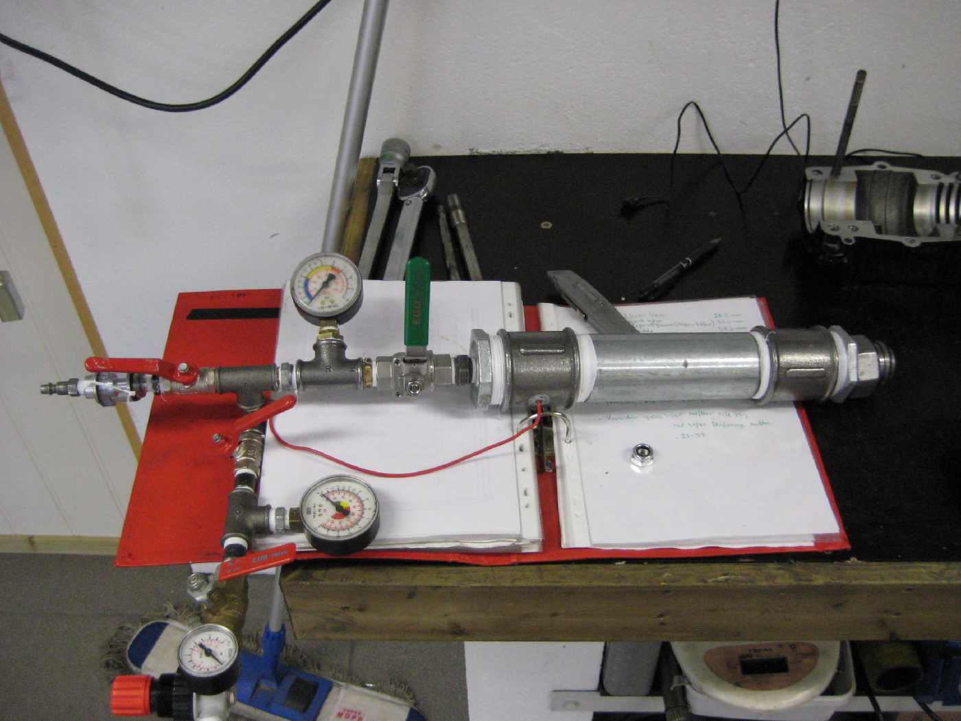

before
before
all the stuff needed before

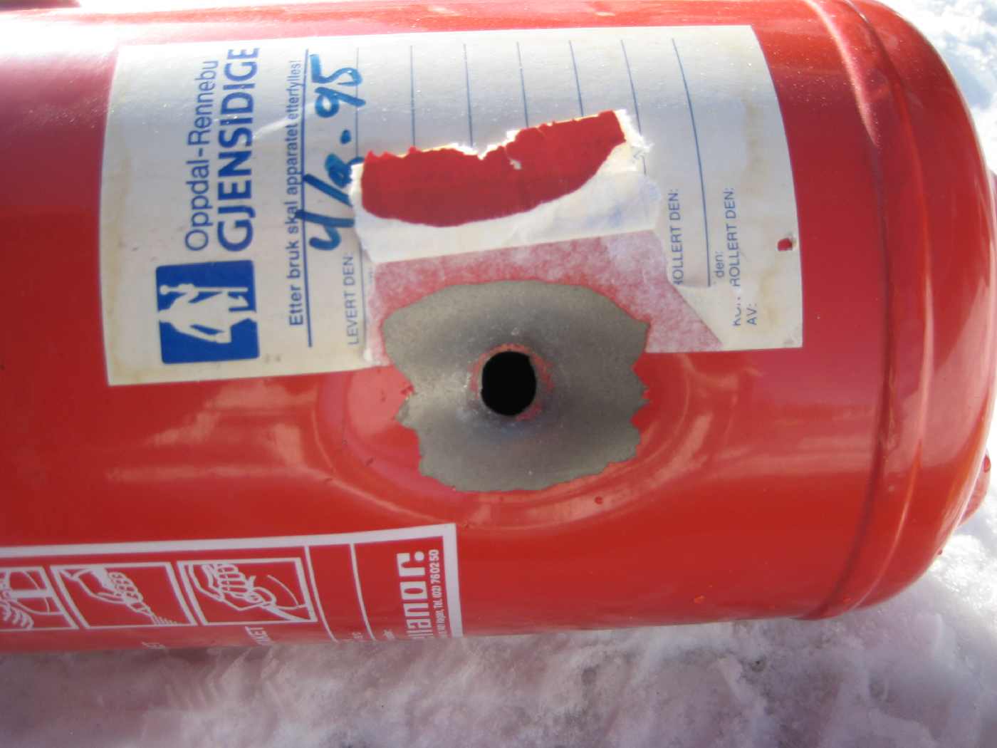

fire extinguisher (?) yes it was empty

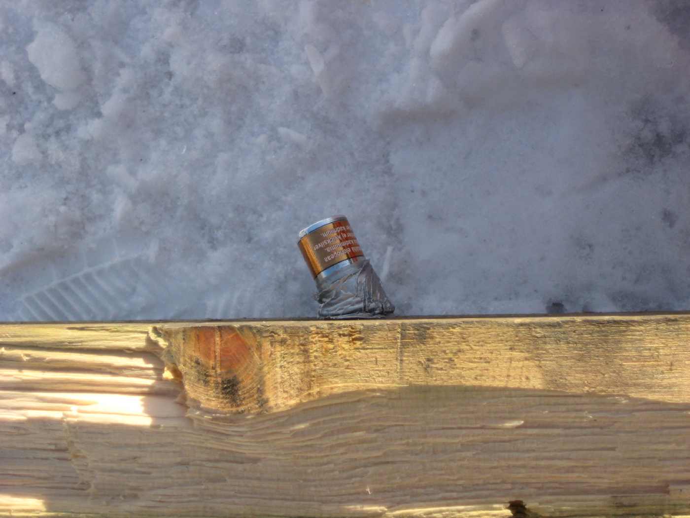

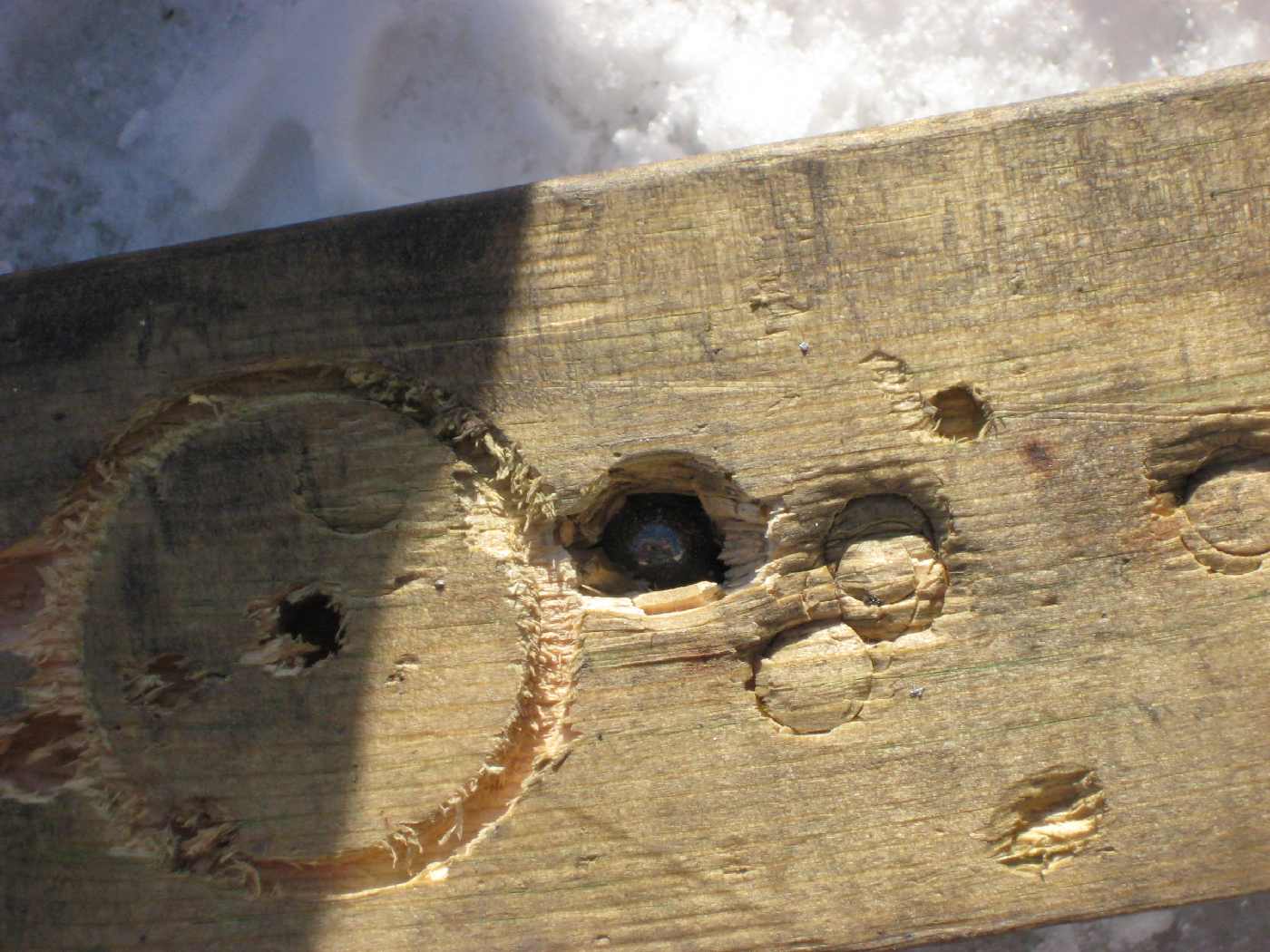

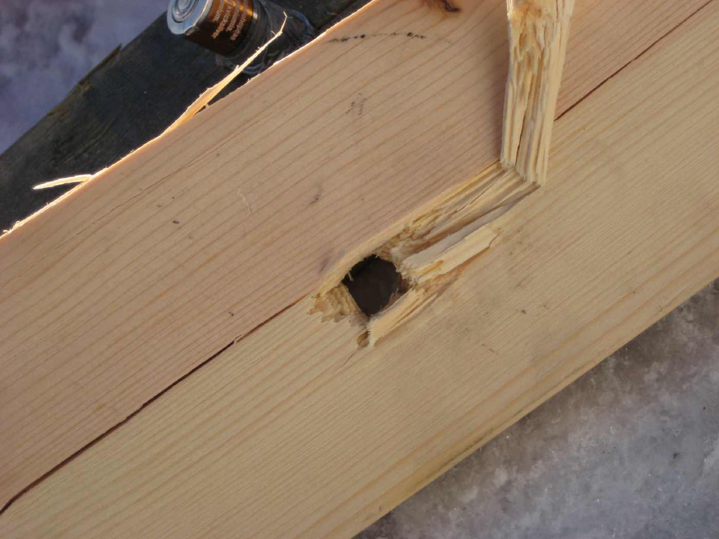

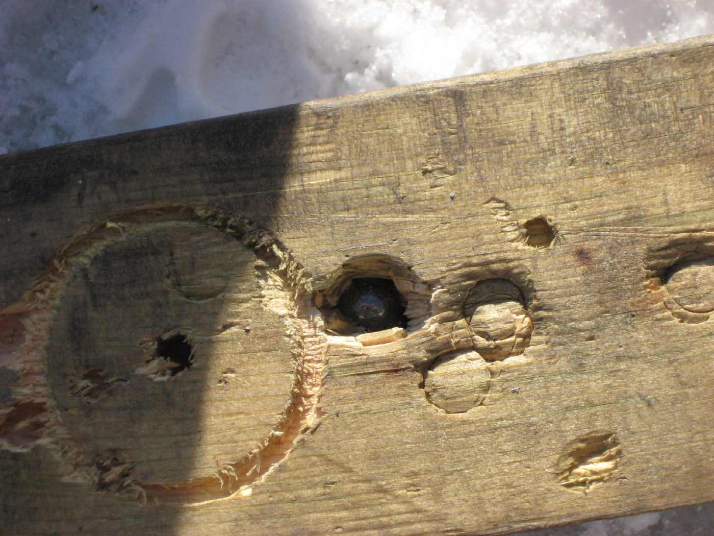

marble in the 2 by 4 (about 1" deep)
aa battery in a 2 by 4

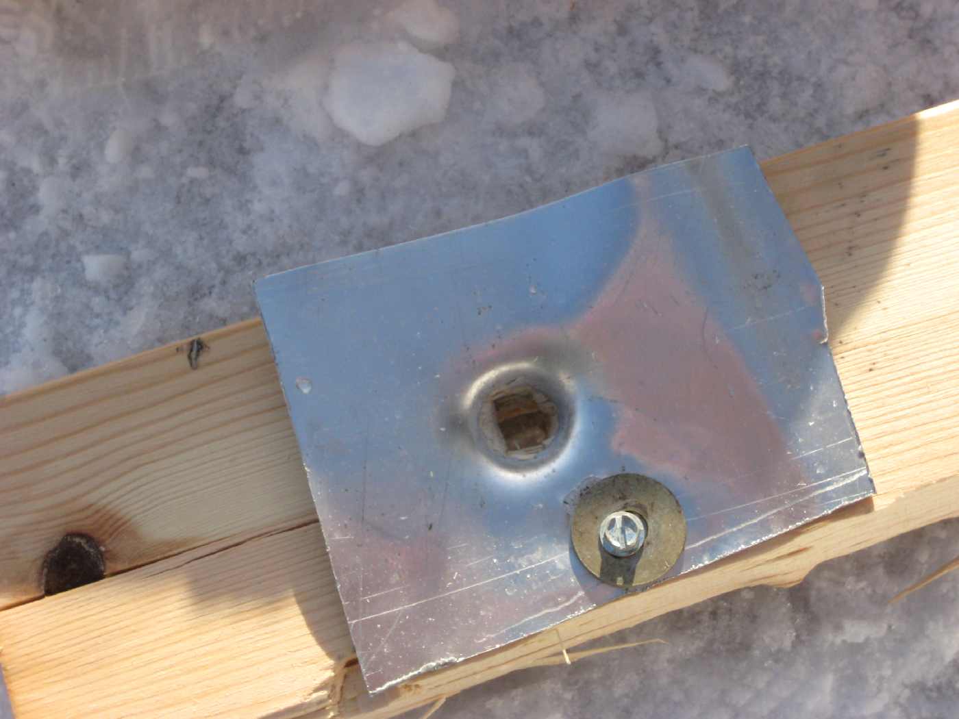

one of the planks with 2mm aluminium armor.

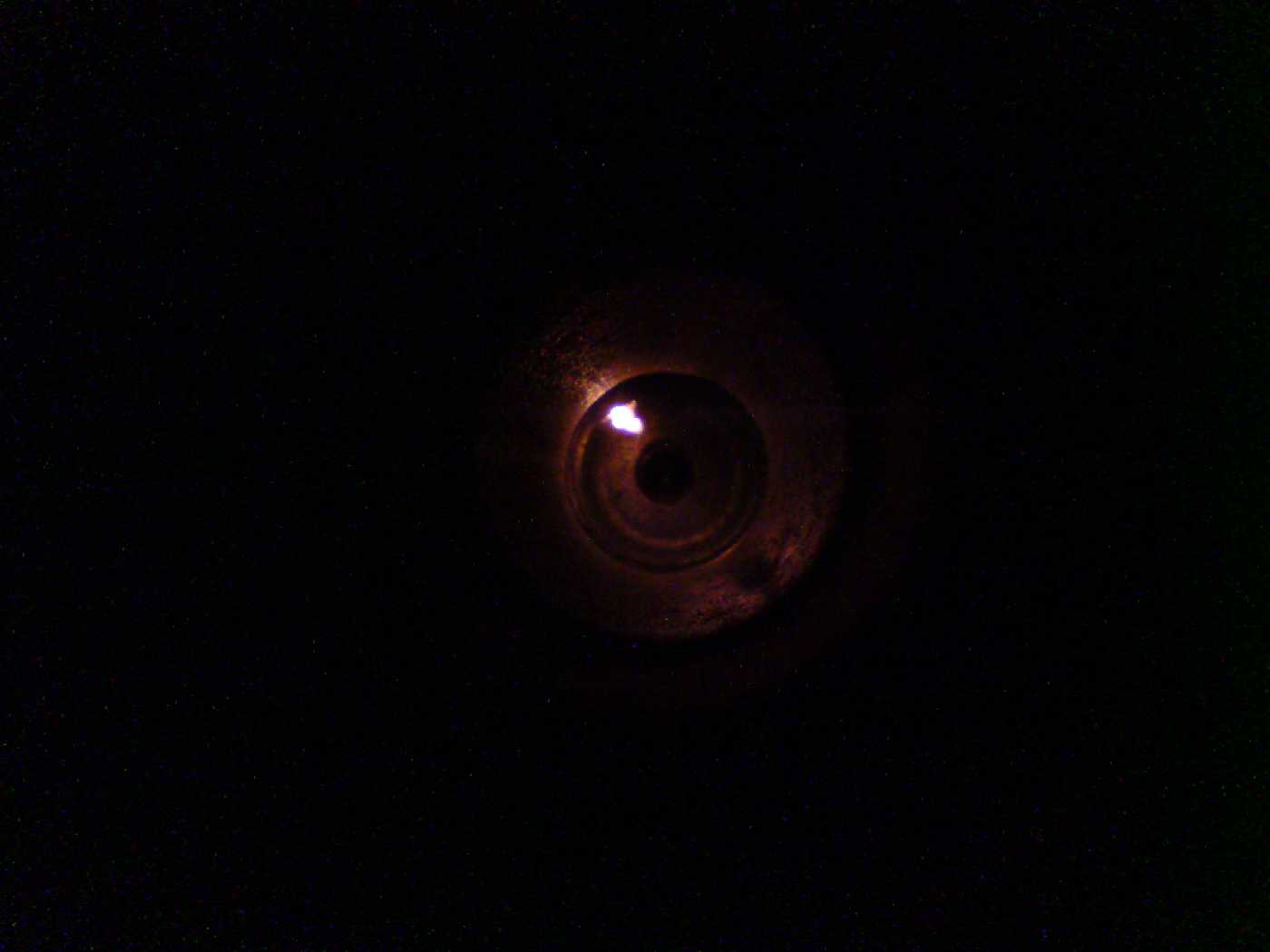

try to see the "spark plug" on the upper left

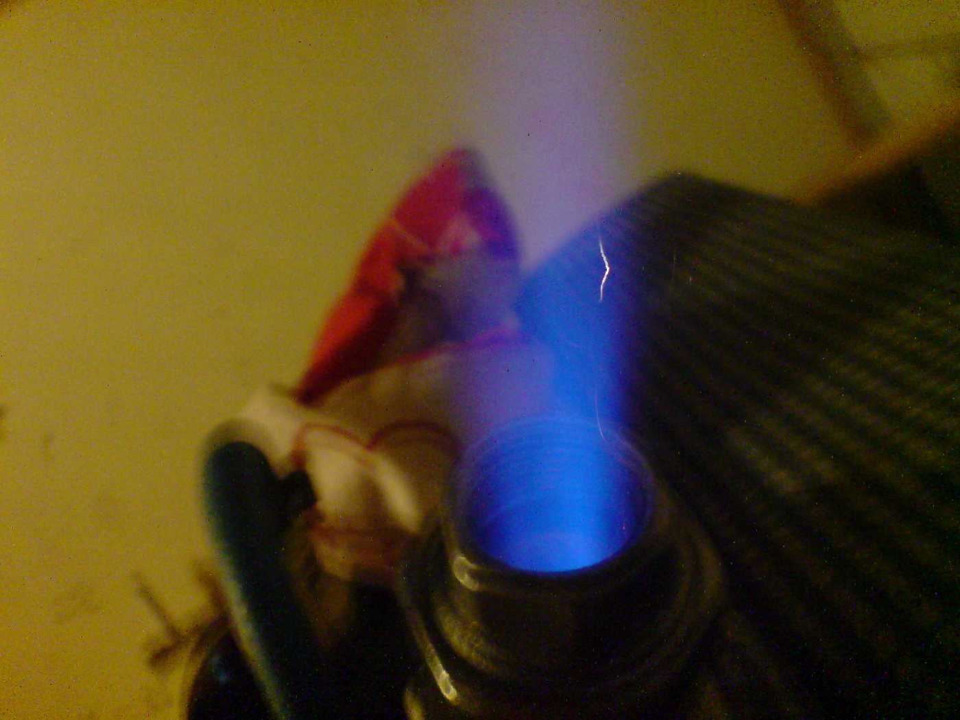

spark
spark
where should i put the trigger and what do i use to cover circuit boad and wires? (the white switch you see on another pic is charge, the push button is trigger and the other one is safety
if you can figure out how this stuff work tell me: is it safe to hold the launcer or will i get snaped?

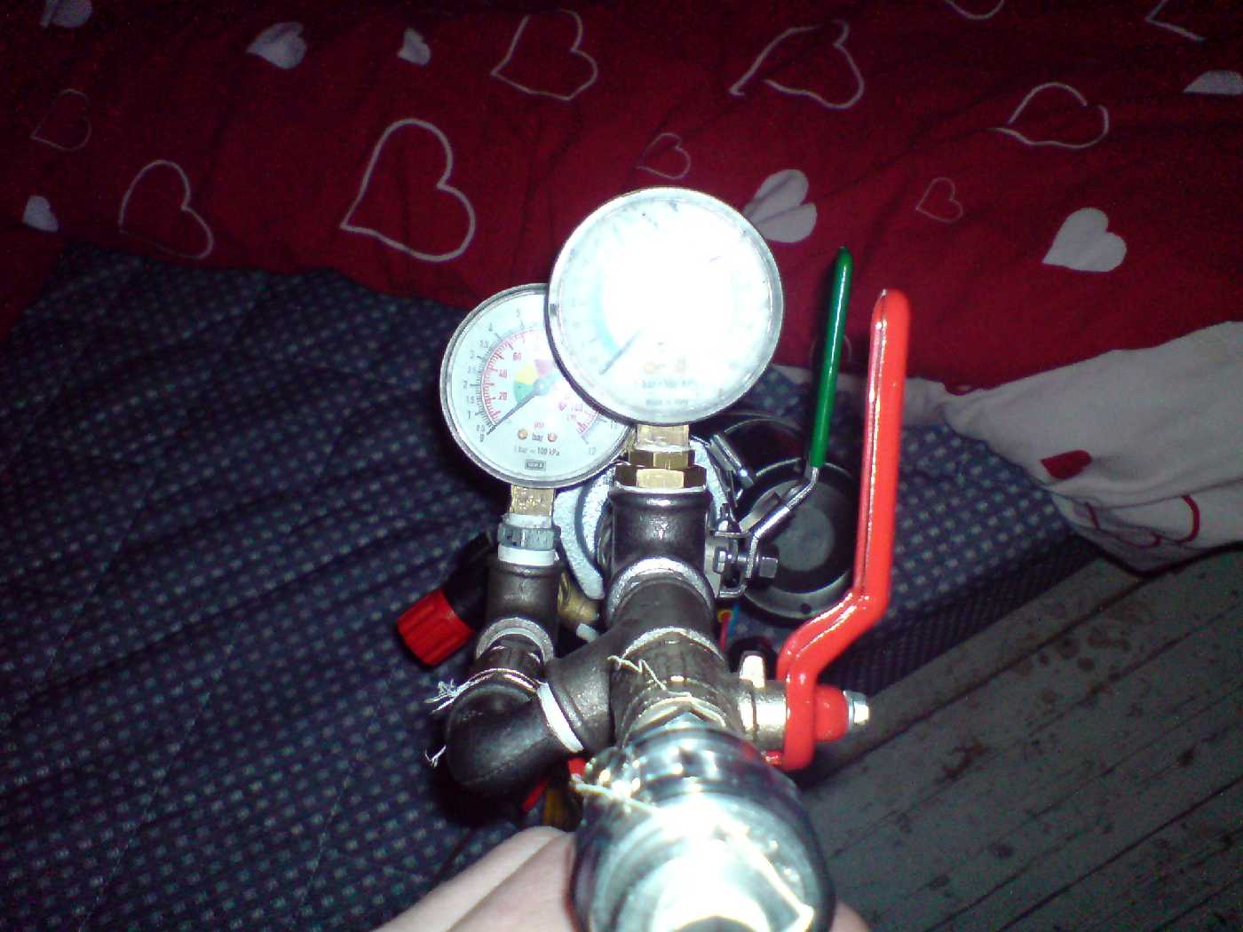

the whole gun
the whole gun

What are you using for your spark plug?
SpudFarm
Posts: 2571
I drilled a hole through a big screw and run a wire in it. the screw is screwed in from the inside so it dosen't pop out. the wire is glued and soldered inplace and the spark jumps from the wire to the screw again!
it looks very neat and clean... can't wait to see some dammage pics
