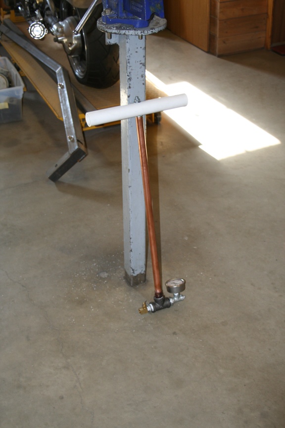

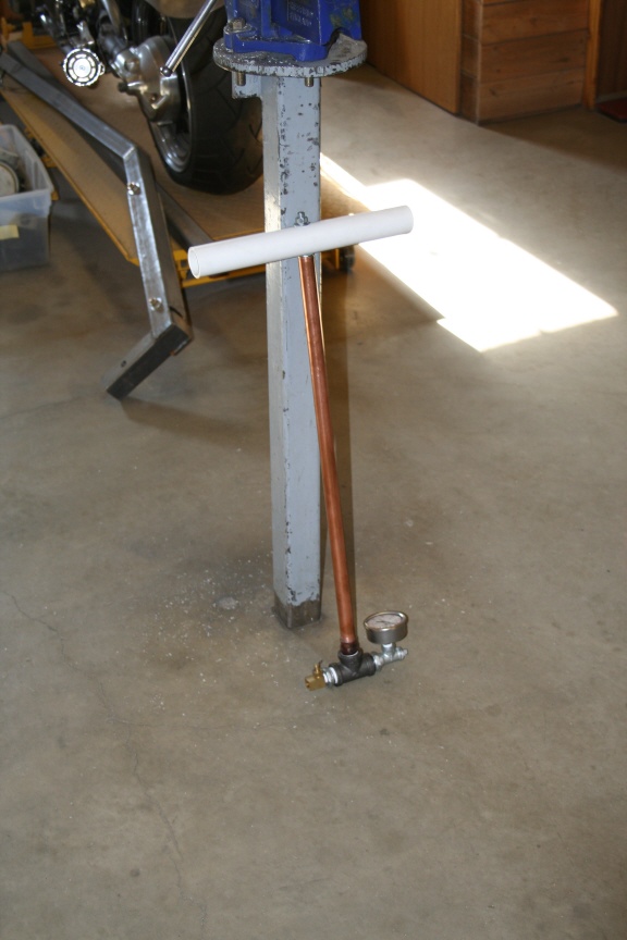

This is an easily constructed stirrup pump. It should be replicateable by most spudders out there. There is a pictorial on photobucket here;
http://s245.photobucket.com/albums/gg76 ... up%20pump/
Cost to build: About 20.00 for the pump and check valve. Another 10.00 for the manifold. Gage and valve belong to my work.

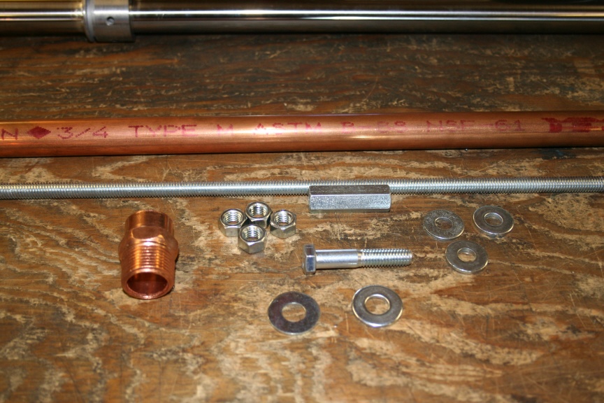

Material list:
3/4" copper tube one 25" piece and one 2" piece I used type M
One 3/4" tube to 3/4"NPT fitting
3/8" all thread rod 3 foot length
3/8" x 2" grade 5 bolt
(6) 3/8" flat washers
(1) 1/2" flat washer
(6) 3/8"nuts
(1) 3/8" threaded coupler (long nut)
(1) 3/8"od. x 1" length compression spring (a light one)
Fibreglass resin or other low viscosity (runny) epoxy
(1) 012 o-ring
(1) 114 o-ring
Red Loctite/5 min epoxy/jb weld/ etc. (any one, I had red loctite)

Update: My pump and check valve have been tested and proven (to my satisfaction) to 400psi.

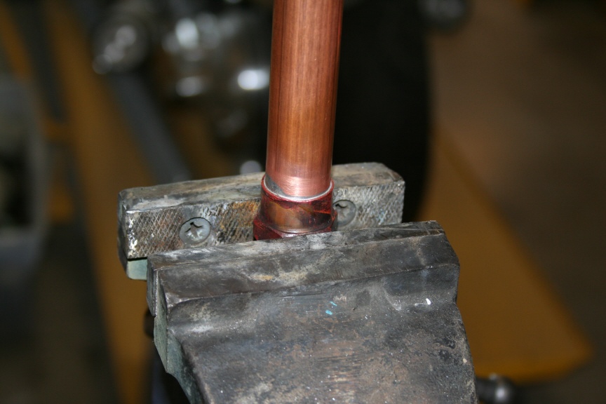

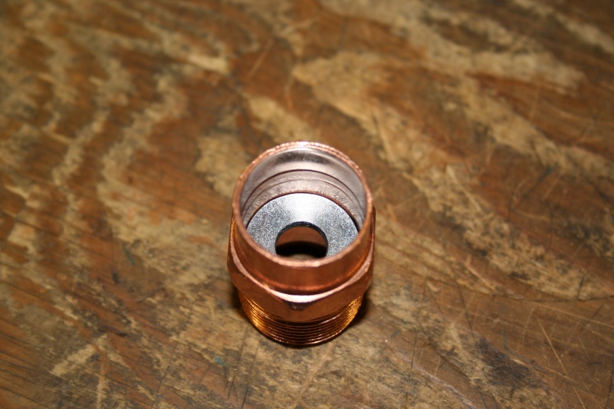

Measure, mark, cut and de-burr a 25" piece of 3/4" copper tube. Properly prepare and solder the fitting, washer and tube together. Ask if you don't know how.

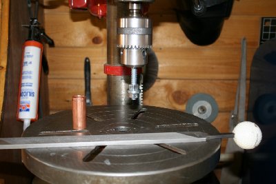

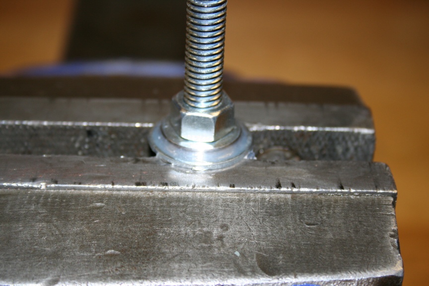

File one 3/8" washer using your mandrel until it fits as shown.
Assemble (3) 3/8" flat washers on your mandrel between nuts. Use the drill press and file until the washers just fit into the tube.

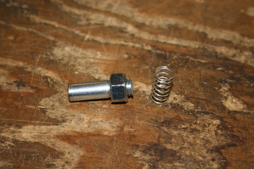

Cut the head off of your 3/8" bolt. Thread a nut on and snug it down. Cut the threaded portion 1/8" out from the nut. Chuck it in the drill press and file the threads until the spring fits slightly loose. Remove from drill press. Place an 012 o-ring and 2 flat washers on the long end. Mark and cut here. Clean up the cut with the file and bevel the edge. File two flat spots on this end. (look at the pictorial if in doubt) Turn off the nut, apply Loctite or epoxy to seal the threads. Spin the nut back on, snug it, and clean off any excess Loctite or epoxy.

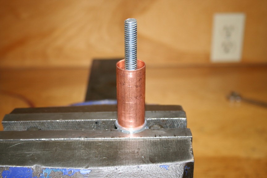

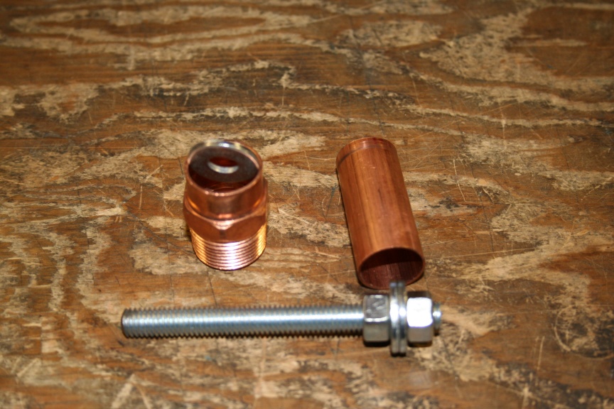

Measure, mark, cut and de-burr a 2" piece of 3/4" copper. Measure, mark and cut a 4" piece of all thread. This will be your mandrel, and then part of your piston.
This is pretty much what you will need. If you bought a check valve, you won't need the copper fitting or other check valve parts.

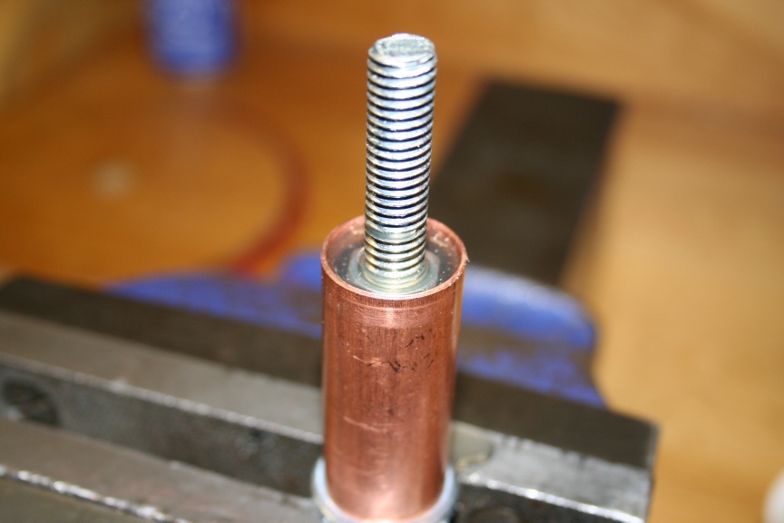

Assemble your mandrel as shown. Large washer on the bottom, filed down washer on top. Secure with nuts top and bottom. The bottom face of the filed down washer should be 5/8" from the end of the all thread.

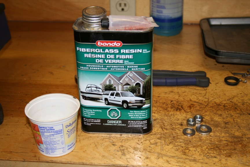

For the next step, have nearby  (1) nut, (1) filed down 3/8&amp;quot;flat washer, small plliers (needle nose preferred) <br /> Mixing cup and stir stick. A rag or paper towel for spills.
For the next step, have nearby (1) nut, (1) filed down 3/8&quot;flat washer, small plliers (needle nose preferred)

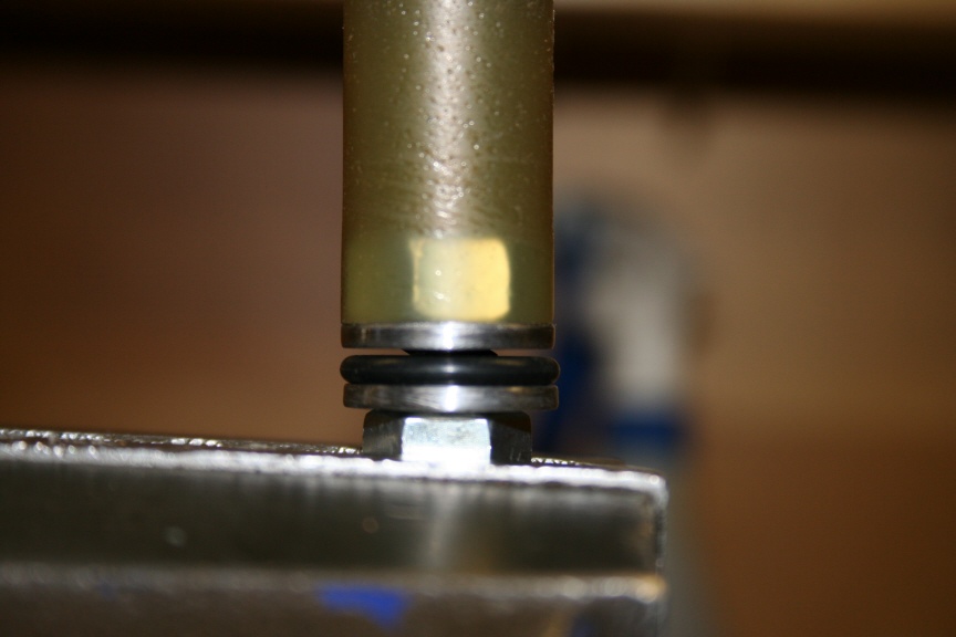

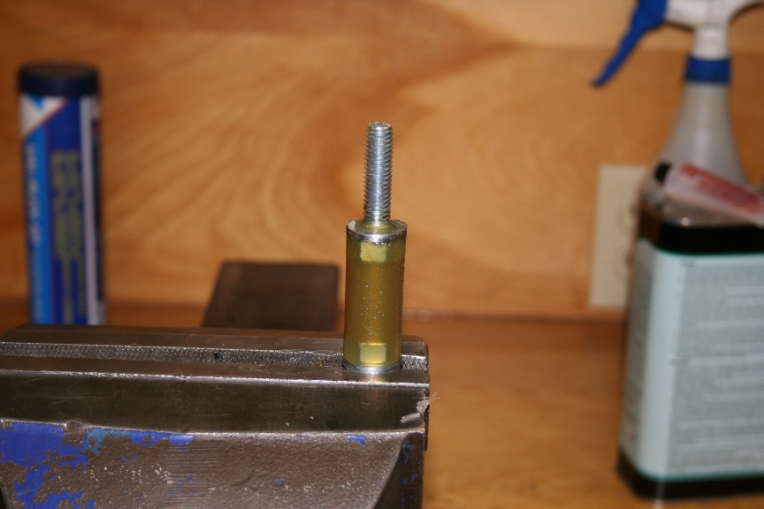

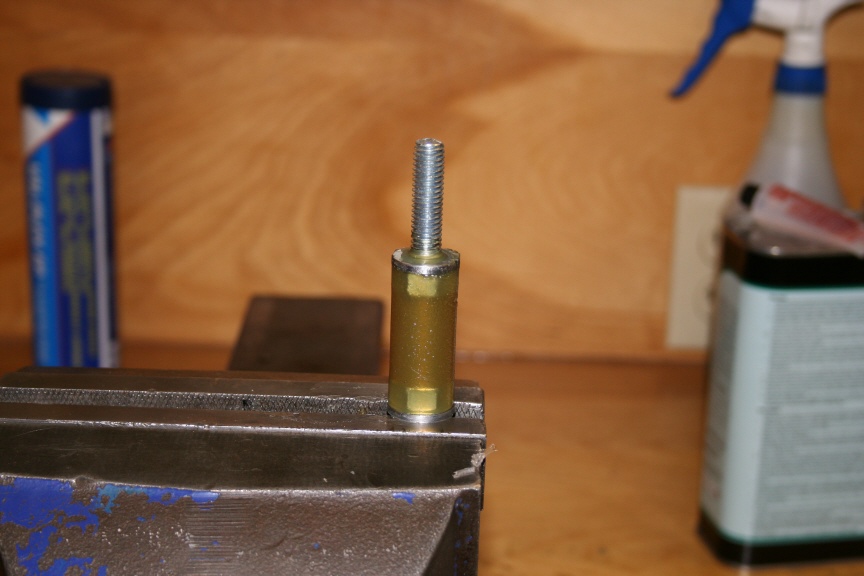

Mix your resin/epoxy as per manufacturers directions. Pour slowly into tube until about 3/16&amp;quot; from the top. Turn a nut down into the resin until the top of the nut is one washer thickness down. Add resin if needed to cover the nut. Add another filed down 3/8&amp;quot; flat washer to the top. Press it lightly down to contact the nut. Now, walk away and let the resin cure.
Mix your resin/epoxy as per manufacturers directions. Pour slowly into tube until about 3/16&quot; from the top. Turn a nut down into the resin until the top of the nut is one washer thickness down. Add resin if needed to cover the nut. Add another filed down 3/8&quot; flat washer to the top. Press it lightly down to contact the nut. Now, walk away and let the resin cure.

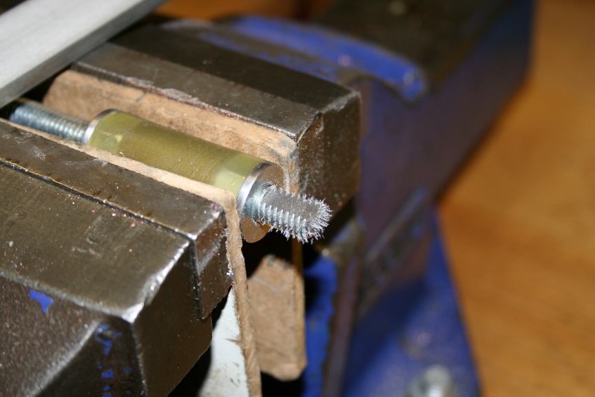

When the resin has fully cured, you can tap the piston out of the mold. Clean the grease from the piston and mold. Chuck the long end into the drill press and wet sand until the piston fits in the tube with a very small amount of clearance.

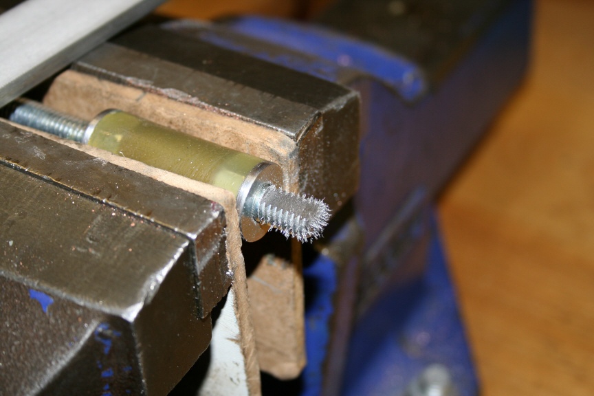

File two flats opposite each other. Spin on a nut to check for depth. You should see a noticeable gap.

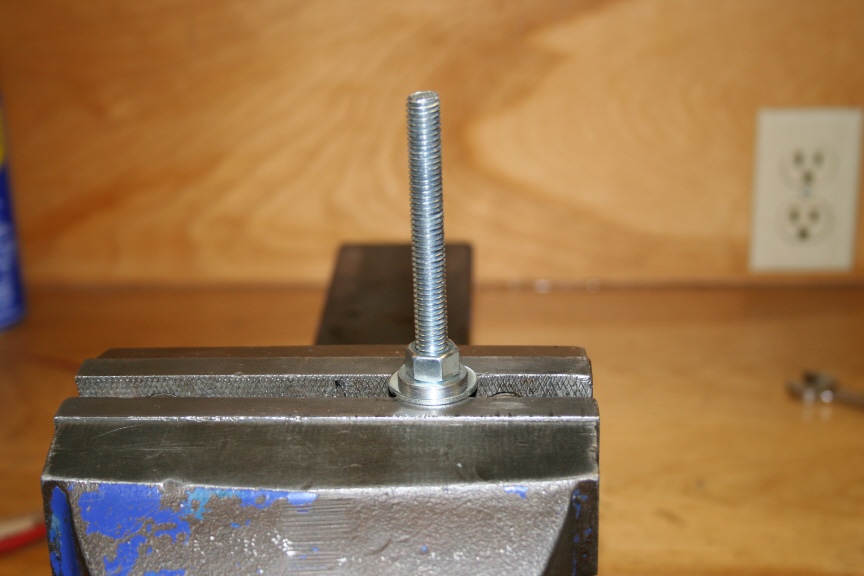

Assemble your piston as shown. Check the length of the all thread. You want it to be recessed in the nut about 1/8&amp;quot;. Trim all thread as neccessary. Apply loctite or epoxy to the threads, assemble to the correct air gap, and clean off any excess loctite or epoxy. Ensure that air passages are clear. Set aside to cure.
Assemble your piston as shown. Check the length of the all thread. You want it to be recessed in the nut about 1/8&quot;. Trim all thread as neccessary. Apply loctite or epoxy to the threads, assemble to the correct air gap, and clean off any excess loctite or epoxy. Ensure that air passages are clear. Set aside to cure.

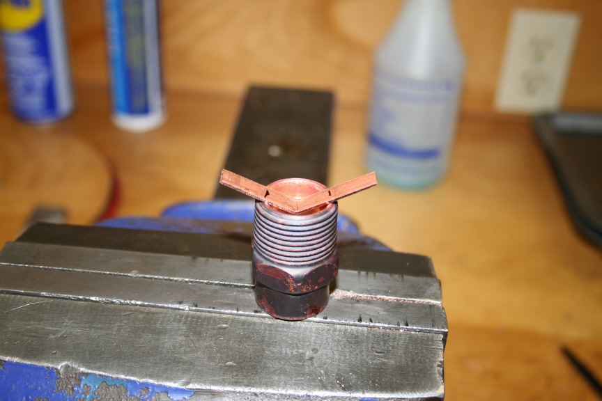

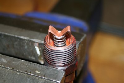

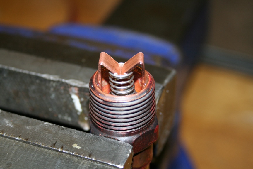

Cut a strip out of your piston mold about 5/16&amp;quot; wide. Clean up edges with the file. Mark center point and bend about 45 degrees. Place on fitting and mark as shown. Finish bending to &amp;quot;w&amp;quot; shape. This is your spring retainer.
Cut a strip out of your piston mold about 5/16&quot; wide. Clean up edges with the file. Mark center point and bend about 45 degrees. Place on fitting and mark as shown. Finish bending to &quot;w&quot; shape. This is your spring retainer.
Put the 012 o-ring on your modified bolt(check pictorial if in doubt), place this into the fitting o-ring first, install spring and spring retainer. Check spring and retainer for center and straightness. Epoxy spring retainer in place. Let cure.

I have updated the top post with cost, etc. The pump and check are working perfectly, and I have satisfied myself that it is safe to 400psi. (see original post for details)
bluerussetboy
Posts: 265
Joined: Fri Nov 02, 2007 12:25 pm
And how much do you have to weigh for that 400 psi???

Somewhat more than the average 12 year old. :lol:

I used it to prevent the washers from digging into the pump cylinder. If you have another way to accomplish this, by all means try it.
