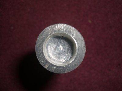

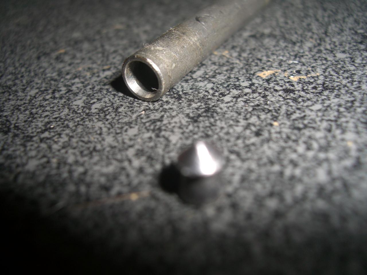

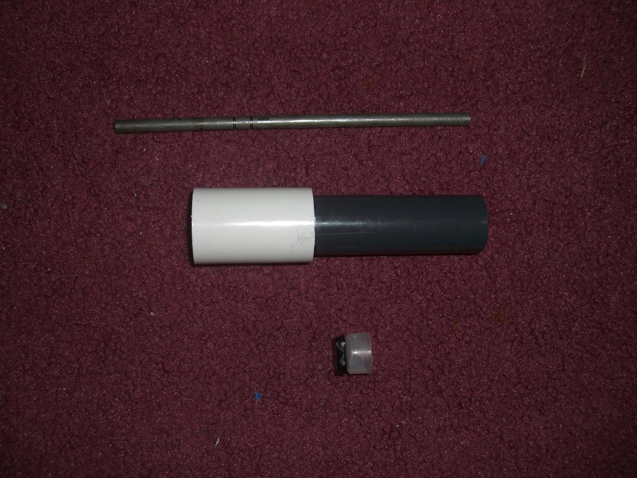

Guys well im starting my second mini coax since the first one sucked like hell! so my question is can i pilot off a 1/4 ball valve and have good performance or should i pilot off a shrader, if i do pilot off a shrader valve does it need to be very tight? the piston i am currently machining is a very tight fit, here some picture to let you see what i have so far.

That looks cool but will you concider using bbs instead of pellets because pellets tumble when they come out of a smoth bore right? What caliber are your pellets .177 or .22 ?. And is that sch 80 pvc?

You should be able to push the piston with your little finger and not much effort, as to the schrader valve it should be plenty to pilot something that small,as for the "tightness" i assume that you mean the tightness of the valve screw inside? If that is the case it should be tight enough so that it does not leak when pressurised but not so tight that you can't pump air though it.

I meant tight ness of the piston but well you've answered that haha but, these are .177 call pellets they have a hollow skirt in the back so they wont tumble much. Nova I was planning on using this at 160 psi since this sch 80 and the fittings will all be double layered and since the barrel is aluminum actualy,I obtained this barrel from a co2 pistol. And as for the piston I should glue on the sealing face instead of screaw cause i cant find a screaw small enough and if i did it would be hard to aline with the barrel without the screw in the way of the sealing

Pilot with a 1/4in ball valve you will get much higher performance.
A blowgun will work too but not not as well as a 1/4in ball valve.
About the tight piston just dremel it down a little and itll be fine.

Assuming you keep your pilot volume to the bare minimum, you should be fine with a schrader.
Medium weight diablo-shaped pellets will fly straight without rifling.That looks cool but will you concider using bbs instead of pellets because pellets tumble when they come out of a smoth bore right?
Performance might be a little disappointing, these smaller coaxials need pressures of 300psi+ to really impress.I was planning on using this at 160 psi

I wouldnt take it above 175psi because of the sch40 fitings if you replace those with sch80 ones id say 200psi-225psi.
