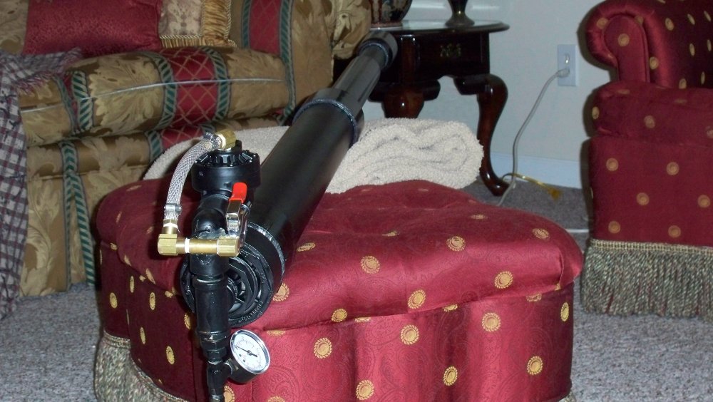

Features include:
- 48" 1.5" SDR 21 barrel
- c:b = 1:1
- overall gun length about 5'
- 3" barrel sealing piston, multiple plastic paint coatings to build out to ideal diameter
- 3/8" to 1/2" piston travel
- 3/4" Orbit Watermaster pilot valve, 3/4" brass and sched 80 piped, blowgun actuated
- schrader air fill
- screw ball stop and barrel dimple, holds ball in place reliably
- cool 2 tone flat black/glossy black paint job
- cool looking but useless barrel noozle
- deep throated, fast pulse shots, 50 - 100 psi feels about right in this gun. Laser beam GB shots...

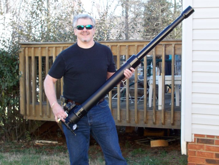

The BLB with Cool McCool. Reasonable ergonomics and power aplenty.

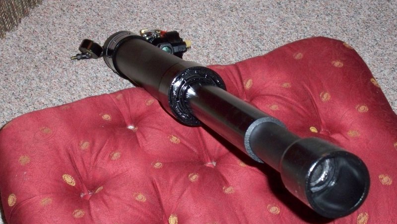

Business end of the BLB

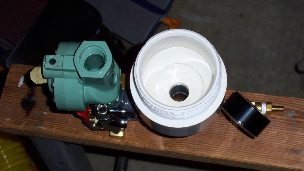

Valve and piston assembly

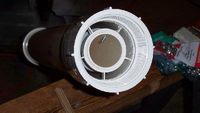

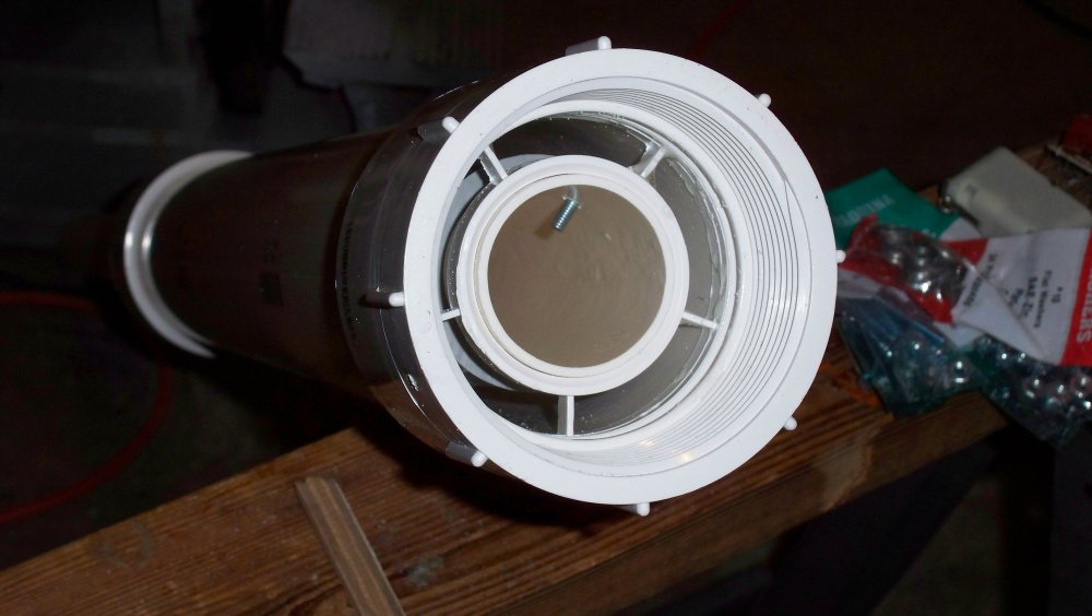

Sealing barrel face and airtank. Barrel standoff was made by using a tablesaw to slice the first 3/8" face off of a 3" / 1.5" reducer bushing. It is welded to the 3" only and floats around the 1.5" barrel. Screw ball-stop visable, barrel dimple on opposite side and is 7/8" in front of the stop.

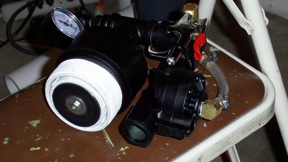

Piston cylinder and pilot valve system

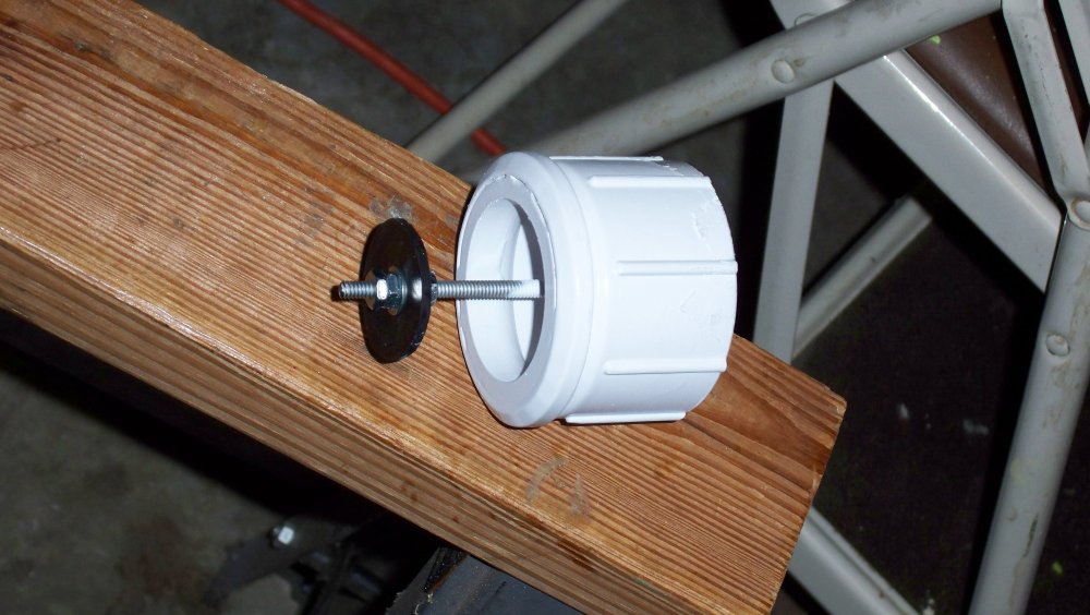

Piston, used a slice of 2.5 " PVC pipe to build out the "ring" on a 2" socket to male NPT adapter. Most of the NPT threads were sanded off. Used multiple paint passes to build out ideal ring diameter.

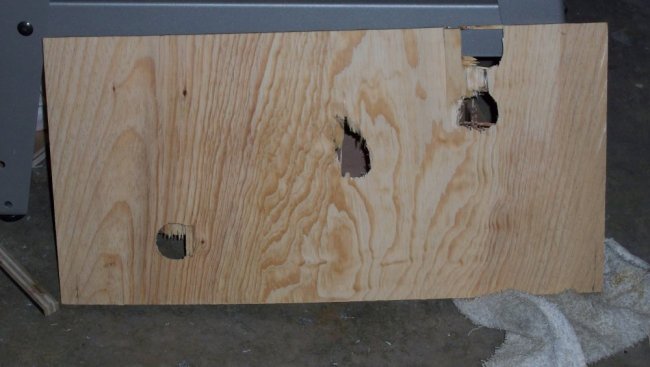

Damage front, 1/2" plywood from about 30' away.
