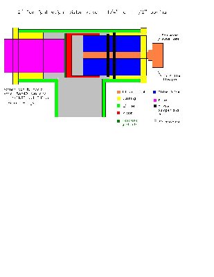

I used a 1 1/4" end cap, but pieced it together a bit differently.

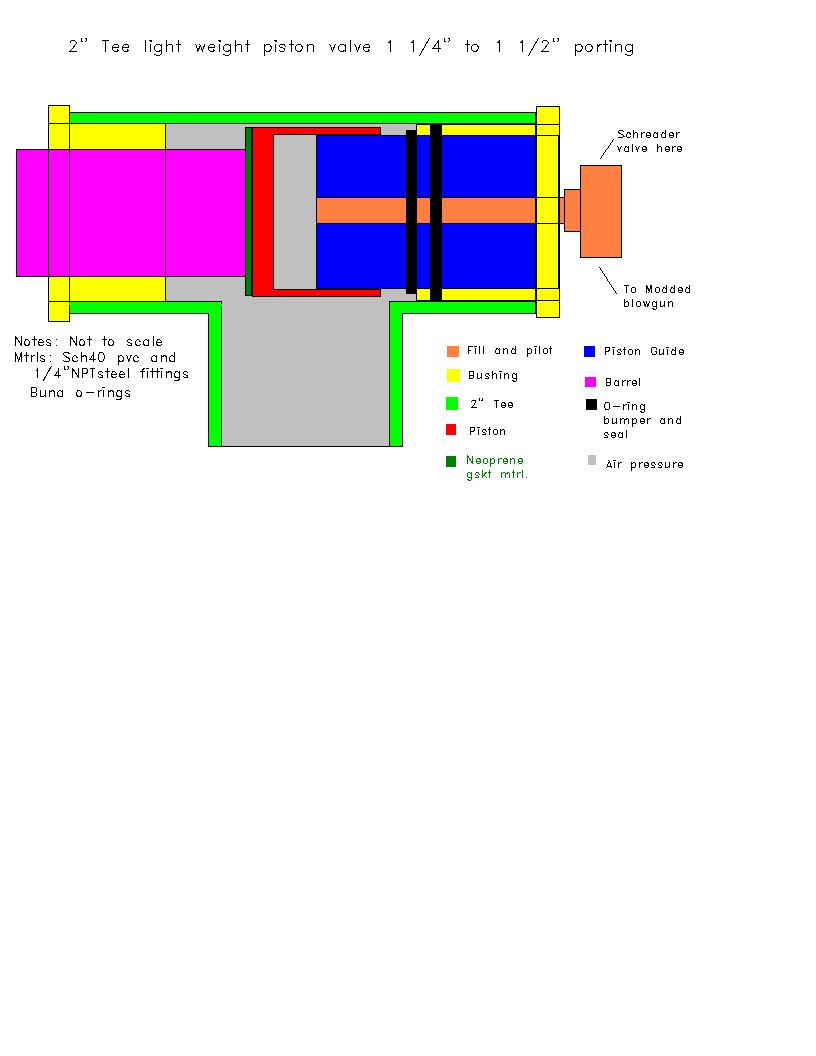

MrCrowley wrote:http://www.spudfiles.com/forums/how-to- ... 10381.html
Always check stickies for useful topics, in every forum section. If you can't find any good stickies, search.
Another case of posting without searching. :roll:
that is why you should have sticked my topic.. it is for every sized piston..

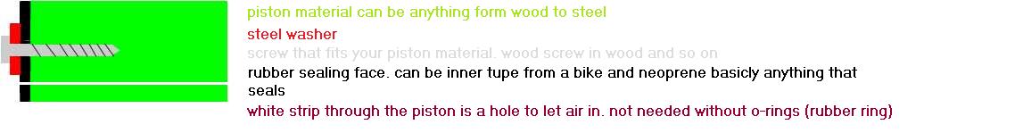

well a easy piston out of a right sized wooden dowel..
easy piston2.jpg (26.65 KiB) Viewed 4007 times

Made mine from wood, (Oak) 2" diameter X 2 1/2" long. 1/8th" X 2" rubber washer for the sealing face. 1/4" steel carriage bolt holding the seal on. 2, 1 1/2" o-rings at each end for piston side clearance and a 1/32nds" equilzation hole, (lined with brass tubing) useing the sealing face rubber washer for a check valve.
SpudFarm
Posts: 2571
that is a real life how to on my diagram..
"Made in France"
- A spud gun insurance.
