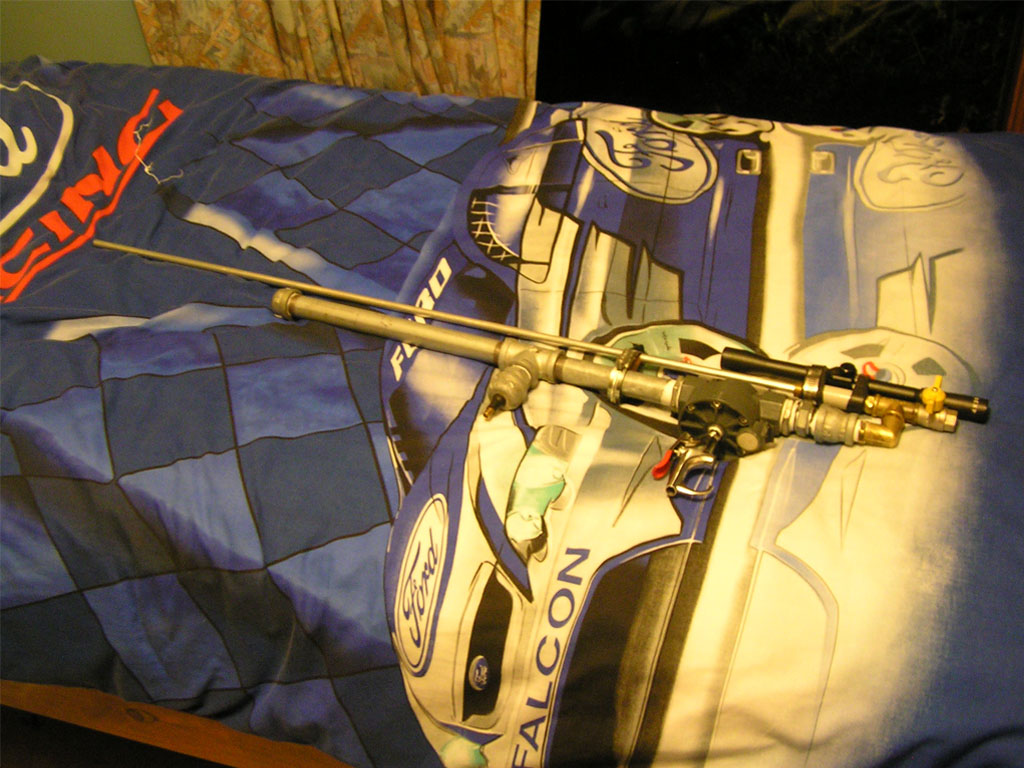

hi everyone this is my second atempt at a Pneumatic gun i hope you all like it.
Chamber3/4" galvanized steel pipe

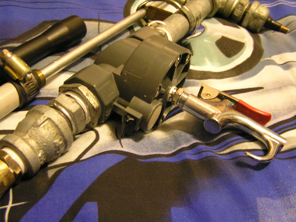

valve 1" sprinkler valve modded
barrel 8mmx1m aluminium tube
i have not fired the gun yet but i have pumped it up to 10 psi just to c if valve worked and it fired like my ball valve gun did at 160 psi lol. i'll try get some damage pics up tomomorow

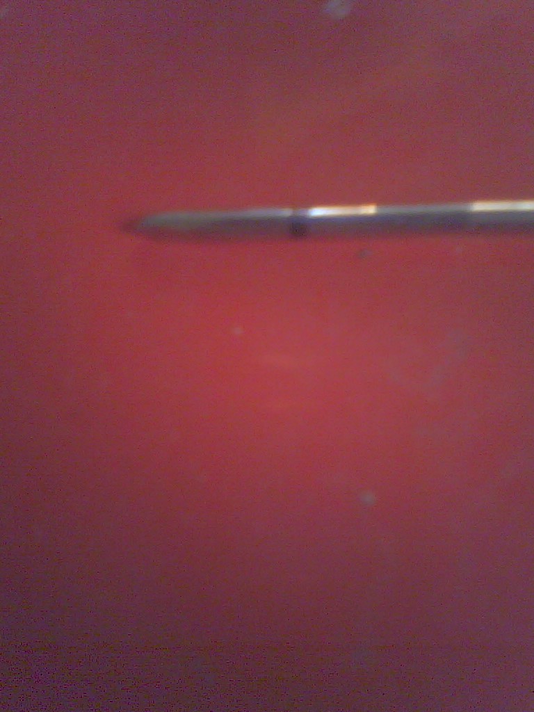

dart the black ring is how far it went in.

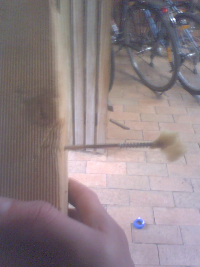

homemade dart in peice of wood

You need a stock to shoulder it, nice build!

ya i'll make a stock tomorrow if stop having fun shooting it lol
hey great gun... I like the fact that you used a BV to make it breach loading
you should consider upgrading it to a 1/2" QEV and building a fridge compressor to use higher pressures

That's quite good! Take a bow. :)

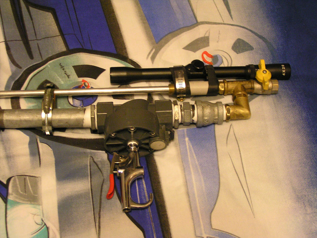

I would add another barrel support closer to the end of the chamber.

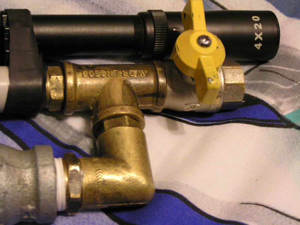

Are you loading ammo through the ball valve at the rear?

hey nice gun mate!
Love the use of the BV
oh and GO FORD :D
Aussie spudders unite!!
@Gippeto sorry :D
@sinper2006 you built a very nice gun... have fun using it for a while... but when you decide to upgrade it replace that sprinkler valve - it's the only part that stops you from using 30 bar

That is a very nice gun.. What did you use for the barrel? also what size.I know you can get brass pipe nipples in custom lenghts. There perfectly smooth on the inside, no seam. You should upgrade to a stronger valve so you can take it up to higher psi..other wise the galvnized pipe is just over kill.

when i get some more money i'm thinking of getting a brss solenoid valve i have seen some rated to 1500 psi. my barrel is 10mm od 8mm id aluminium tube glude into a 10mm nipple

i load wad/darts in ball valve and stick bbs, lead, screws down barrel
