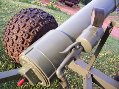

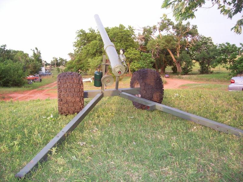

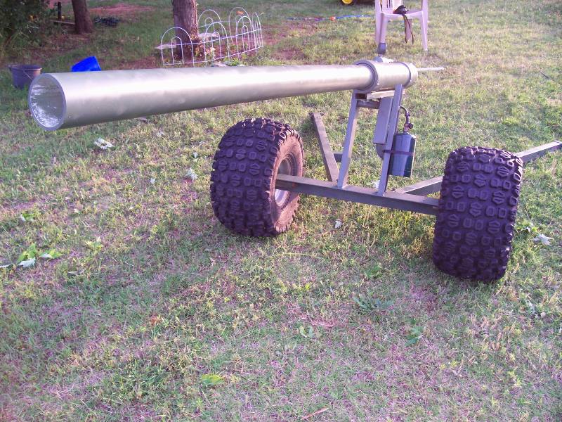

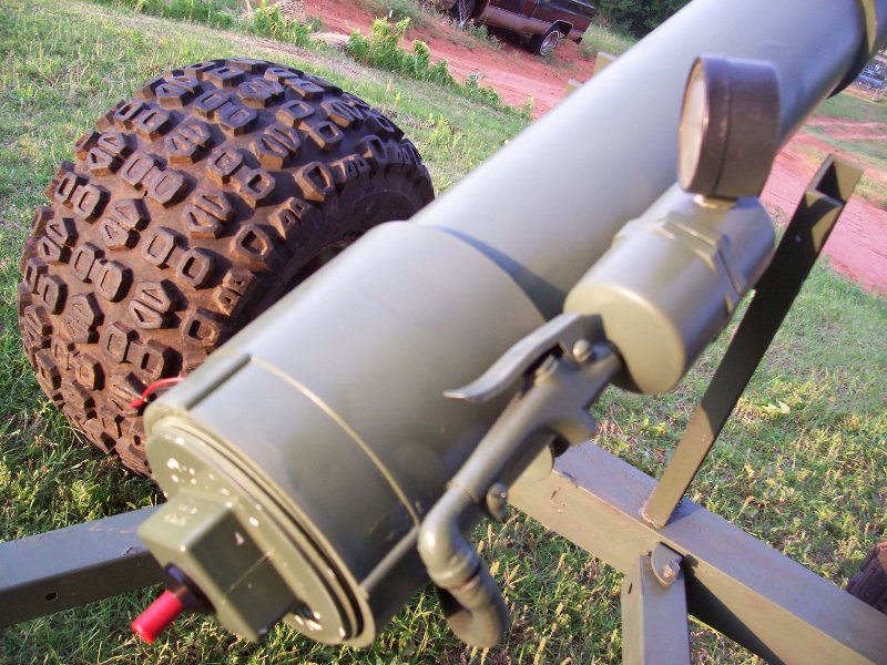

4 inch chamber - 20 inches long
3 inch barrel - 5 foot long

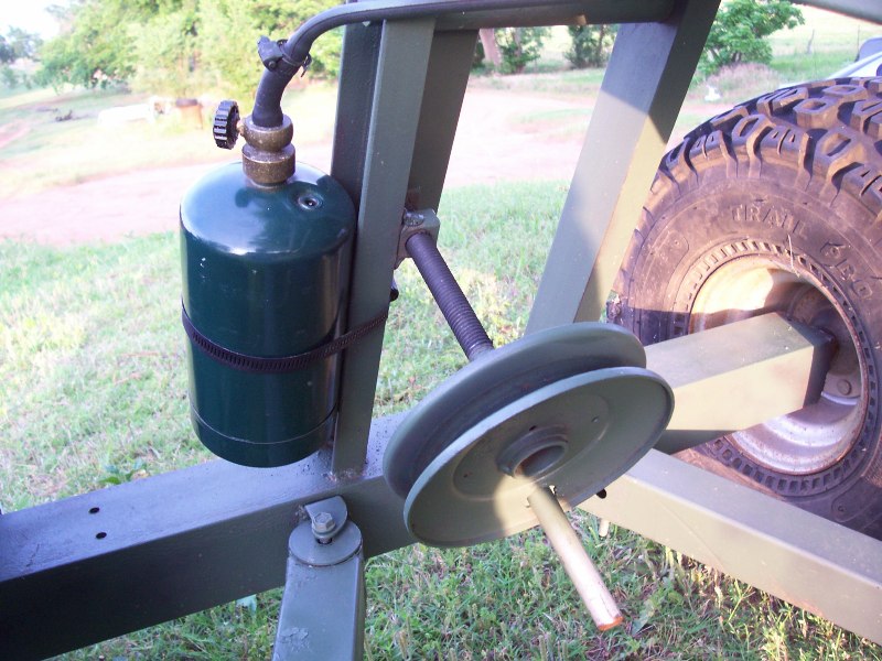

"phat" propane meter - 1.5 " caps

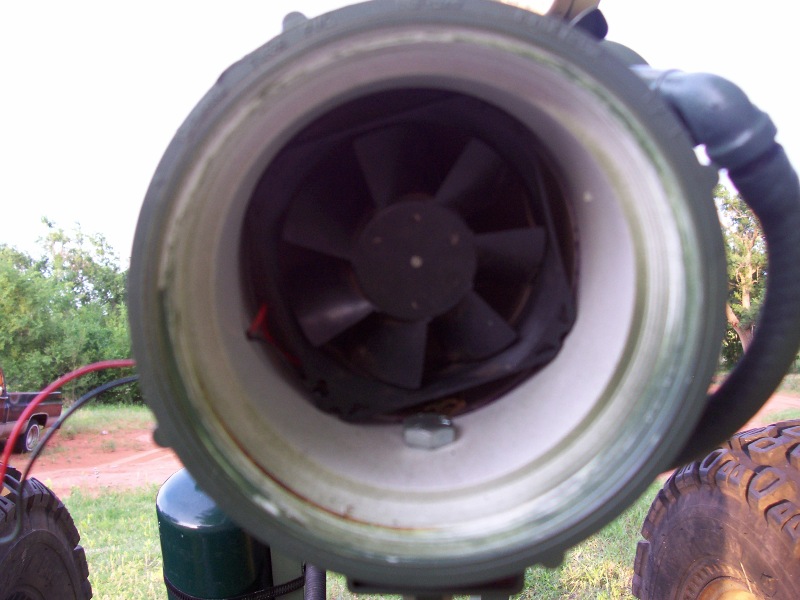

pc fan
3 wheeler tires
welded carriage
I have found a fuel mix that is very powerful. a couple squirts of starting fluid and a few squirts of hairspray really makes for a powerful bang.

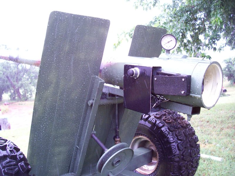

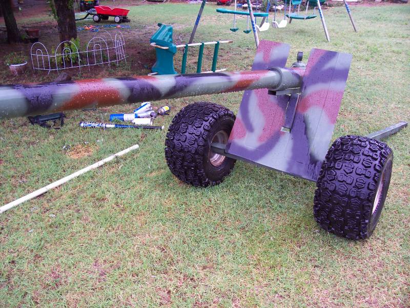

UPDATE #2: i added the electric bbq ignitor and a spark strip with double sparks using small bolts. this and the fan really improves the power. added a battle shield and camo paint.
UPDATE: propane sucks with this canon for some reason, i found out that solarcaine first aid spray works best , then disinfectant spray works real good so i dont use propane anymore on this gun. it shot a baseball 660 feet with solarcaine. in the vid u will see a baseball go through 1/4" plywood then travel another 159 feet at its lowest elevation setting.
Also the C:B ratio is less than 1 to 1 so to get the pressure up in the chamber and to simulate a 2" barrel i added a plywood baffle inside the chamber up against the barrel, the baffle has a 2" hole and this greatly improved the power.

now... that's great I really like the way it looks... well maybe its not a real howitzer but it looks as if it was.. that green military paint suits it
the recoil rocks it a little but i built it mostly for style.

Wow that is very cool. Good job I am that kid you talked to on the chat lol and you told me about this and it is awesome. I like the desighn of how its held in place like a howitzer. And as asked before what is the range. And that bbq ignitor should be replaced with a stun gun I think and I have never built a combustion except for a mini but i have heard that putting the sparker in the end cap is not a good idea because it has a greater chance of failing. I still like it though besides that.

I like the fat tires and the attitude of the whole thing...great paint job! The elevation control is awesome...(I think that's what that pulley and handle is anyway)
I think the only thing I would add would be some sparks gaps in the center of the chamber. Overall though, really nice unit. I'm glad you "unveiled" it before the competition gets underway...

I did want to put in a stun gun but didnt have the money, so a spark strip might be added.
as for the ingitor in the end cap i was going to epoxy it until i drilled through it and seen its just as thick walled as the 4" pipe itelf.

Wooow, I love those wheels! Looks really awesome!
Though the stand looks somewhat big for the cannon in my opinion.
A larger cannon or maybe another cannon (2, 3 or maybe even 4 cannons next to eachother) is the only thing that can be done better.
