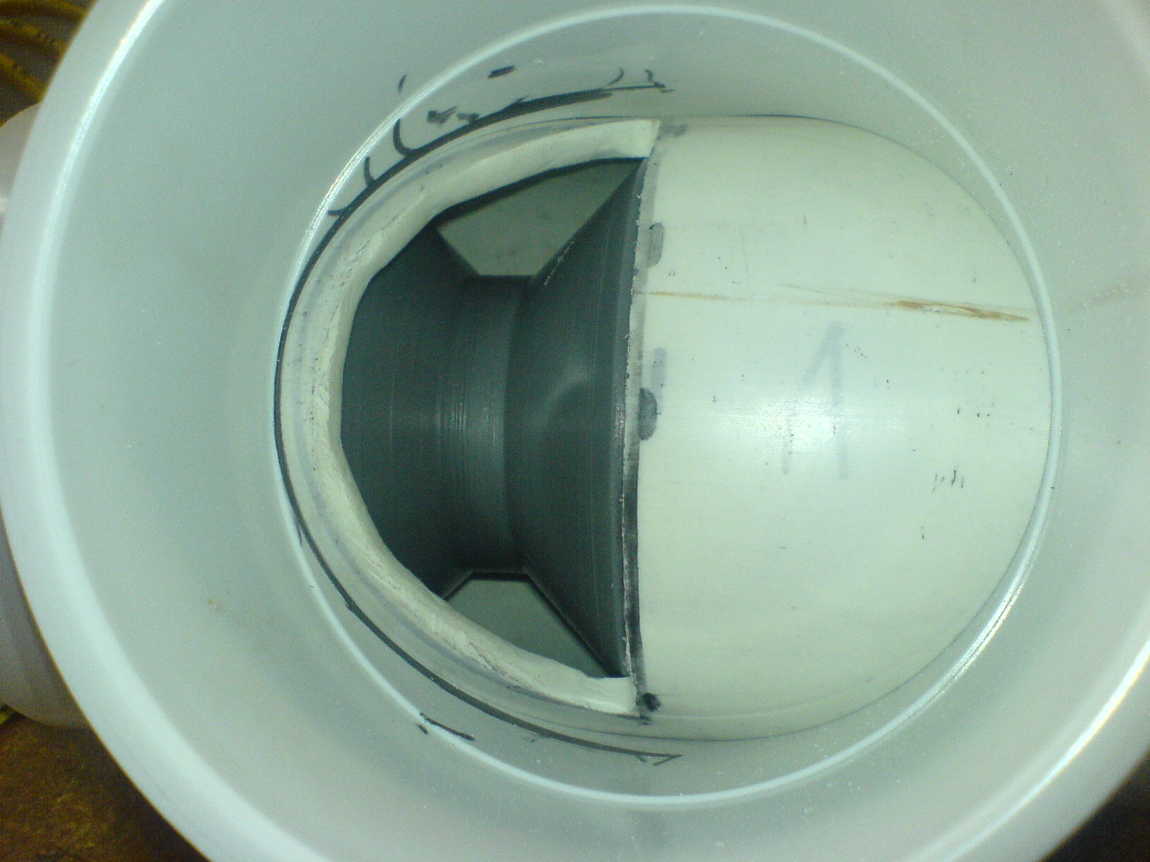

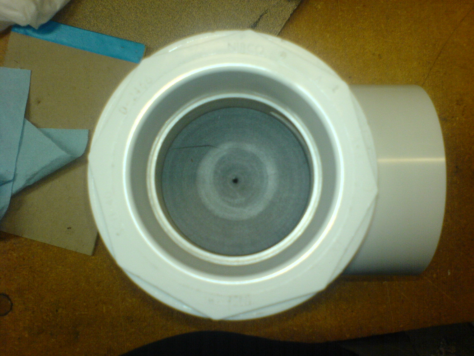

what did you make the pistons out of? they look quite nice.... almost an hourglass shape (whistle)
- LynyrdSkynyrd
- Private 4
- Posts: 93
- Joined: Sat Aug 26, 2006 4:39 pm
the pistons are made out of UHMW and the hourglass shape is just to reduce mass.
This is bacically what we got going on:
except the piston(blue) is an hourglass shape.

i think those are the best looking 3in porting piston valves ive ever seen.
ah and they are chamber sealing as well......... (whistles).
for a newer member you got your game on..... lol. I think even more than some of the seinor members of this forum.
