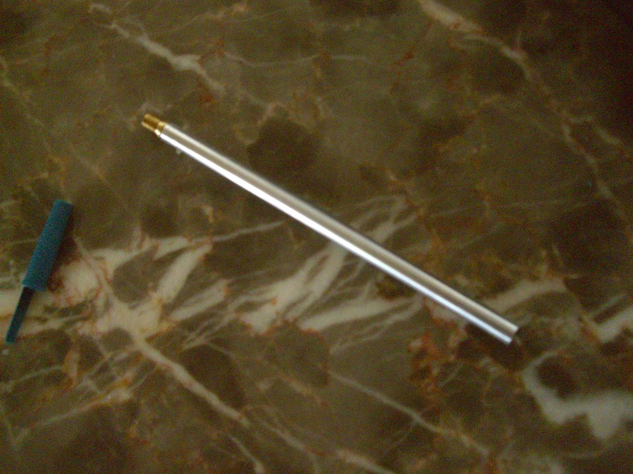

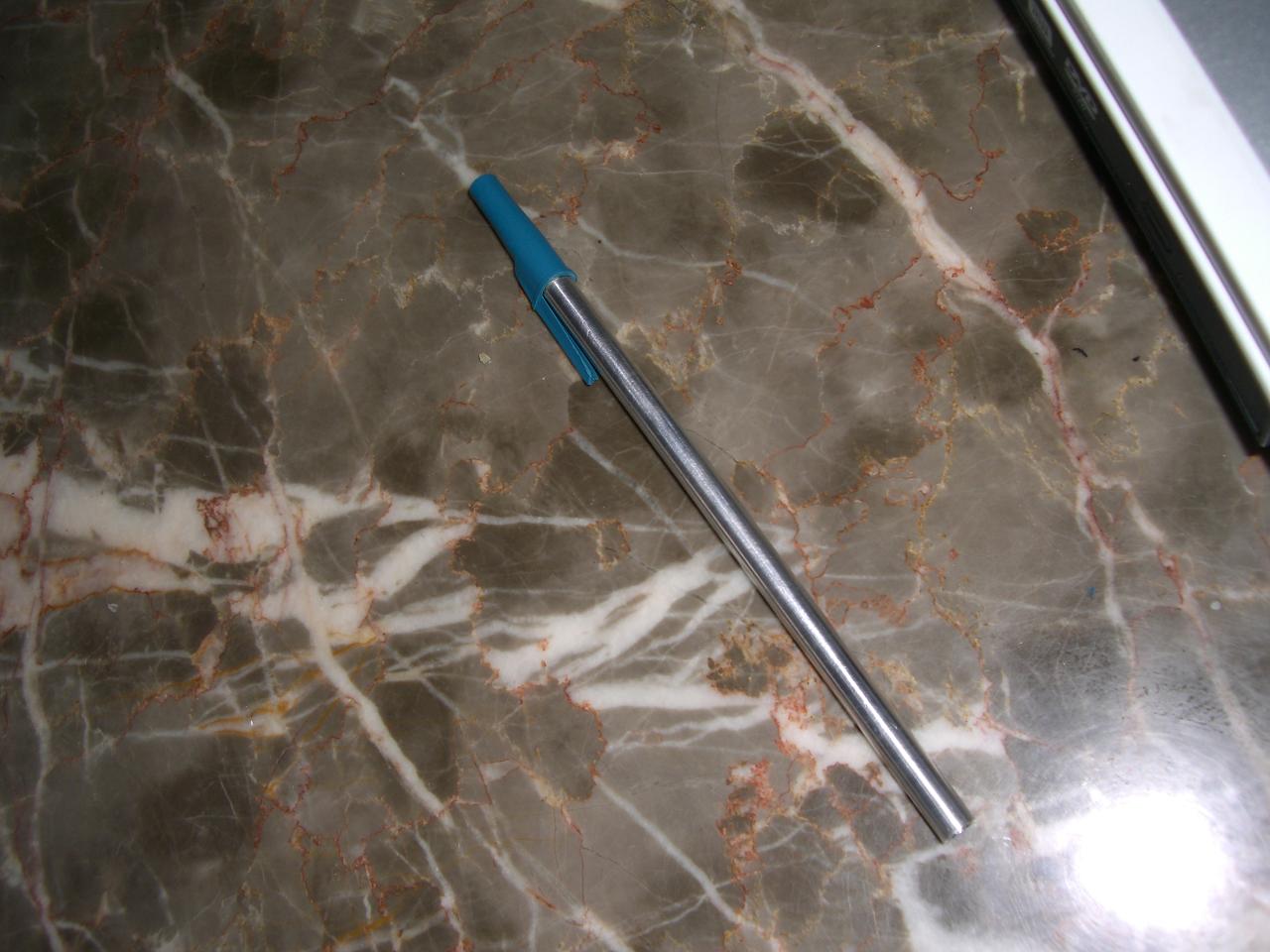

Hey guys I haven't posted much recently, because I was mostly lurking around, also I am developing a new cannon heal jr and a pen gun similar to jsr and rcman. I just wanted to ask you guys if an aluminum barrel from a bb airsoft gun could hold much pressure, im going to use marine epoxy bushing and everything will be epoxied in, the id is 6mm, do you think this could hold pressures of 500psi+?
elitesniper wrote:do you think this could hold pressures of 500psi+?
Very easily :)

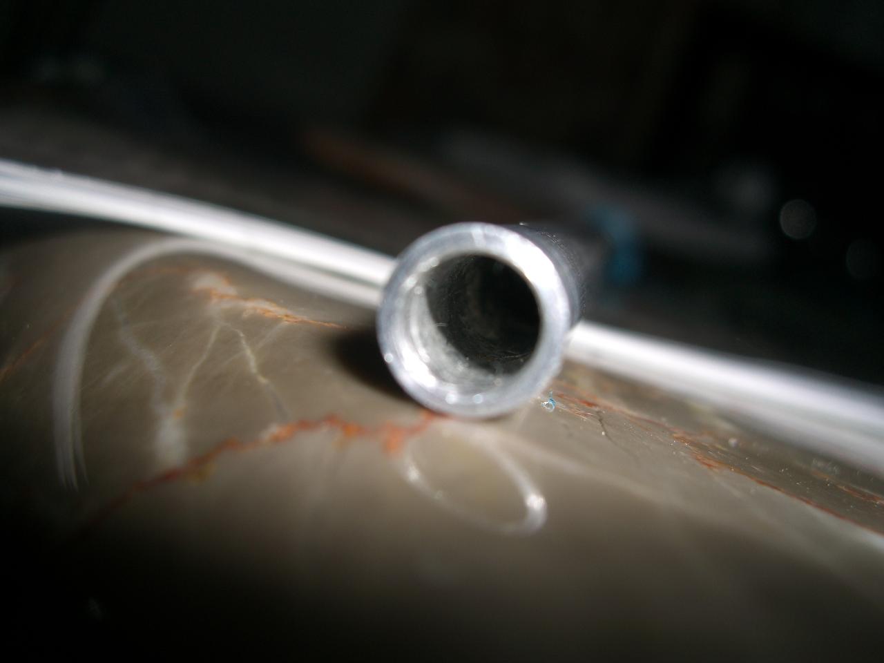

thanks for the feedback , whats your guess on the burst pressure of the pipe? im kinda new on the high pressure stuff
The following estimate assumes static pressure, a 1.7mm wall thickness (what I guessed from the picture), and a 40KSI tensile strength alloy:
Roughly 22,000psi.
Roughly 22,000psi.
This is not a fact but I measured my airsoft tubing and I am pretty sure all airsoft aluminum barrels have a wal thickness of 1mm not 1.7. Eh elite sniper?

elitesniper
Posts: 1090
Well im not actually sure but i think dyi is right, but im not sure, as i don't have a set of calipers. I measured against a 6mm bb cut in half:D, pretty crude haha.

You don't need calipers just a ruler with metric. well anyway my airsoft barrel has a 1mm wall thickness.

O well nonetheless if it was 1mm it would still hold over 500psi easily eh?
