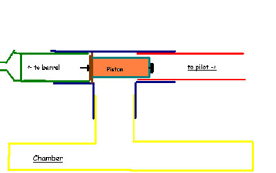

Ok, i'm in the process of making a piston-valve pneumatic, and I have a question. First I will explain my valve, The piston itself consists of a slightly sanded 1" x 2" wooden dowel, a bolt, 3 small washers, a nut, and a 1 1/4" neoprene washer with a 1" neoprene washer on top of it as the sealing face. When the piston is in the housing, the sealing face is to big to fit into the 1" pipe, so it stays in the gap in the middle of the 1" tee with the dowel extending into the 1" pipe leading to the pilot. Anyway, my question was, do i need any kind of bumper sice (i think; correct me if i'm wrong) the piston will not leave the tee.
edit Ok, i'm changing this, all i care about now is since this won't work, how can i fix it?? :(
A simple diagram
A simple diagram
This is what it looks like
elitesniper
Posts: 1090
barrel needs to be smaller then the sealing face, there no pressure acting on the piston from the front, so it wont actuate.

ya, if you look @ my diagram, you can see how the piston seats onto the 1" pipe going to the barrel (however i may remove the front, small, neoprene washer)
The barrel needs to be a smaller diameter then the tee socket. There has to be a gap between the seat (where piston seals against the barrel) and the tee. There needs to be a pressure on the front of the piston, in your diagram because the barrel is the same diameter, there is no force acting on the front of the piston.

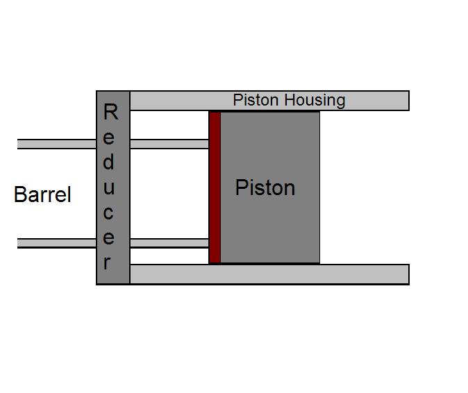

Here is a basic diagram of what is being said.

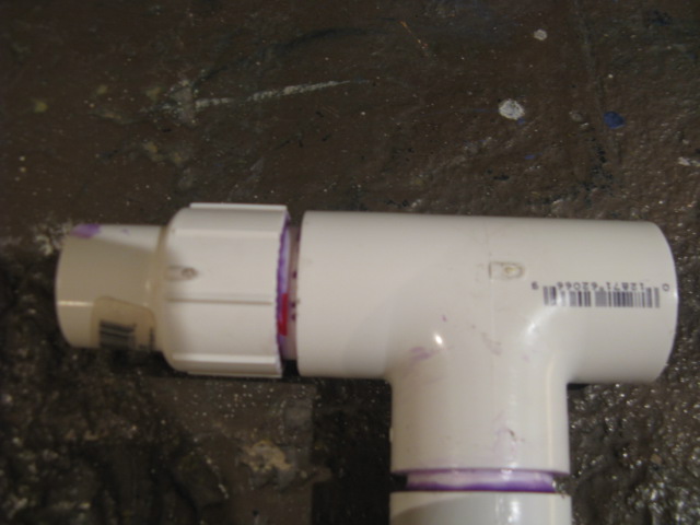

wait I have 1" pipe going to a 1" x 3/4" female adaptor (i wanted interchangeable barrels). Will my piston not work like this?
And if not, how can i fix it?? :(

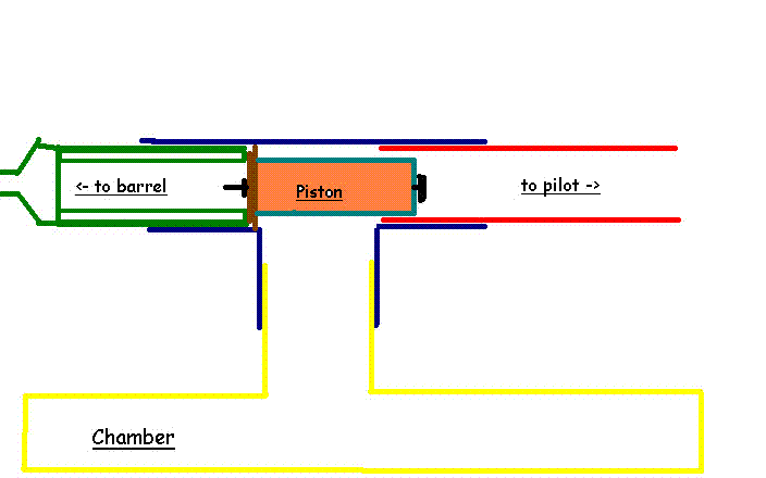

If the outer diameter of your piston is the same as your barrel, your piston will never work, A solution would be to find some (say, 3/4" inner diameter) pipe and epoxy it inside your adaptor in such a way that the piston seats against it.

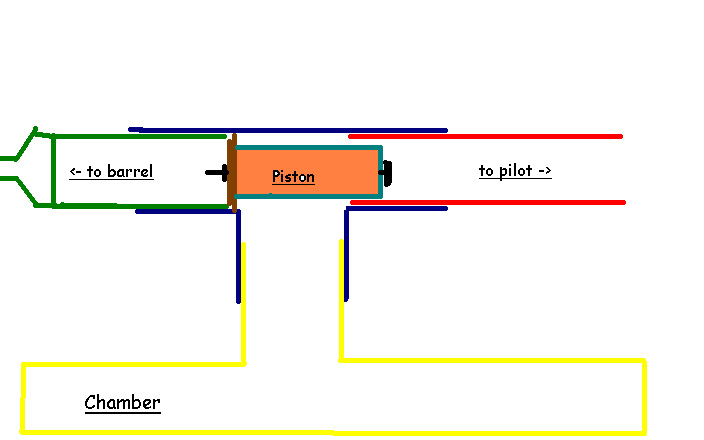

Just to clarify:
