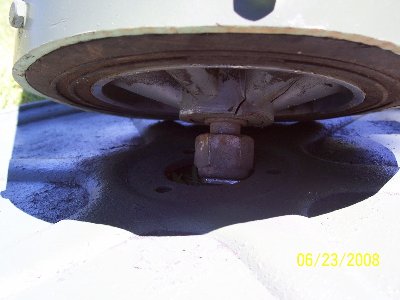

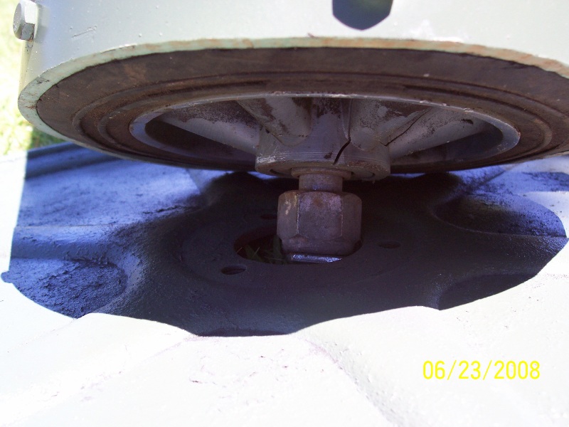

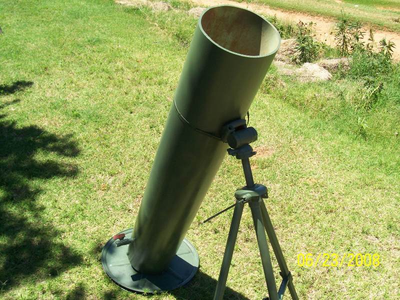

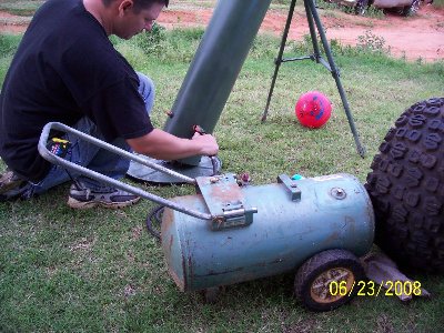

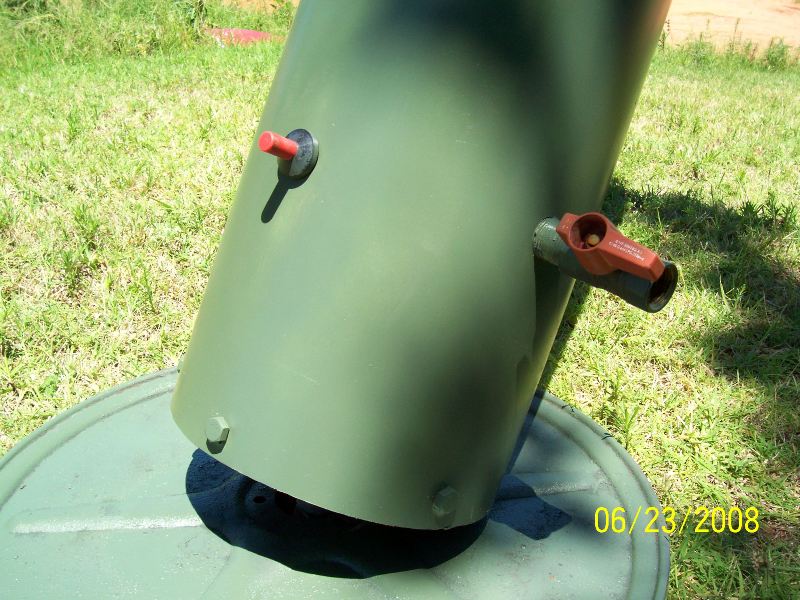

A friend of mine gave me a piece of 6 inch and 8 inch pipe so i built another mortar with the 8 inch. it has a 1/2 inch ball valve to add the fuel (disinfectant spray) i also use a air tank to air out the chamber instead of a fan. bbq sparker ignition. it shoots ok but im planning on adding a bigger ball valve to make it easier to add fuel and adding a 5 or 6 inch baffle to increase chamber pressure. i blocked off the base with a 8 inch diameter 2 inch wide solid rubber tire.
Edit: oh ya go ahead and flame me for drilling through single layer. but it dont seem to build much pressure as is. the wall thickness is the same as a 4 inch sch 40 pressure rated btw.

ya the tire still has the rim. as for ammo i shot a couple 8 inch balls out of it, one was a normal kick ball. they were not that heavy so im planning on getting a soccer ball and maybe add some water in it. the good thing about these balls is i can add air or let air out to fit the barrel snug.

is the video not showing up? its right under my original text. i dont have anything stopping the ball, it fits tight enough that it wont move after i shove it down about half way.

Though the performance doesnt look very powerful to me (for its size, that is), I think you should certainly crank it up with a chamber fan.
Proper mixing of fuel can really add up alot of power, especially in a large chamber with one single injection point.
Propane metering would also make it better ofcourse.
Btw, in that one pic that shows the bottom part of it, is that a crack in the center of the plug?
