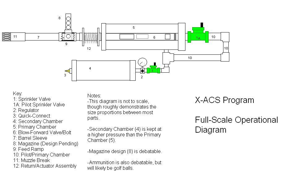

My next project after the Airburst system, and maybe a bunch of identical mortars for mass-fire, will be a Blow-forward Autocannon. It will use a single piston, and one sprinkler valve to actuate it, and another to shut off air flow to the primary tank when the piston is in the forward position to reduce air waste and to more easily re-seat the piston. When the piston is in the rear position, the airflow control valve (between primary and secondary tanks) will be open. When the piston is moving forward and reaches the point where the rear inlet on the sleeve is open, a roller switch will disengage, closing the air inlet valve and firing valve. The inlet hole on the piston sleeve will continue to allow pressurized air to push the piston forward. The air escapes through the barrel when the forward inlet reaches the inlet on the sleeve. Air escapes, and the spring returns the piston to it's rearward position. The rear inlet hole is not closed until the last possible moment to further aid re-seating of the piston. The moment the piston's rear inlet is sealed, the roller switch re-engages, allowing the inlet valve and firing valve to open again. In order to allow the cannon to have a reasonable rate of fire, the primary tank will be kept as small as possible while still allowing a reasonable muzzle velocity. The secondary air tank Will be kept at a higher pressure and will have a preset regulator installed just before the valve, also to ensure better air use. The tank will be constantly connected to a compressor. The finished gun will be to large and awkward to use as a handheld cannon. It's final construction and operation will be similar to the Browning M2.

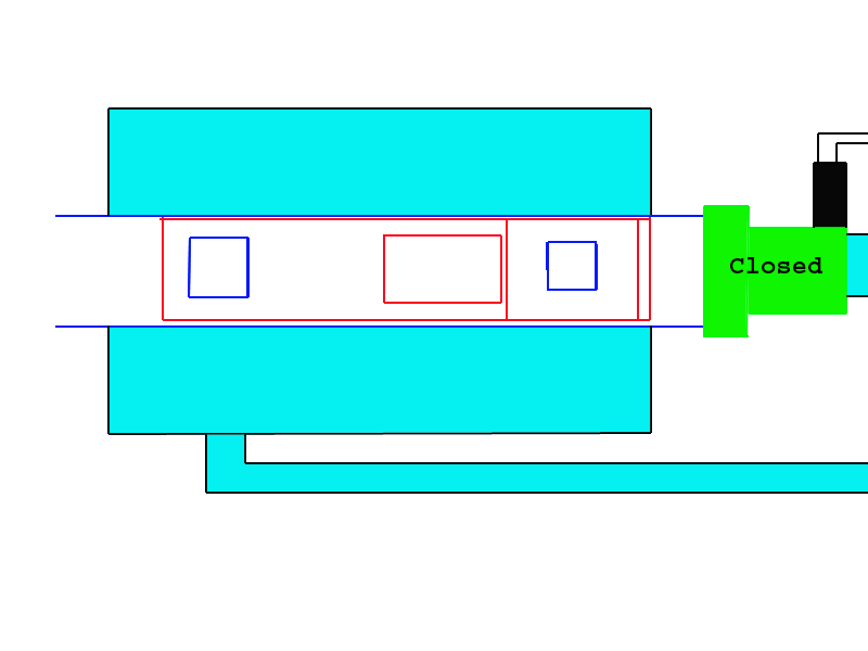

Diagram of the Blow-Forward Valve developed under the X-ACS Program.

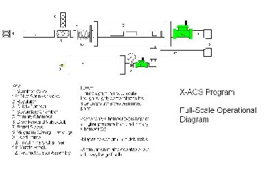

Full Diagram of Cannon, minus Controls.

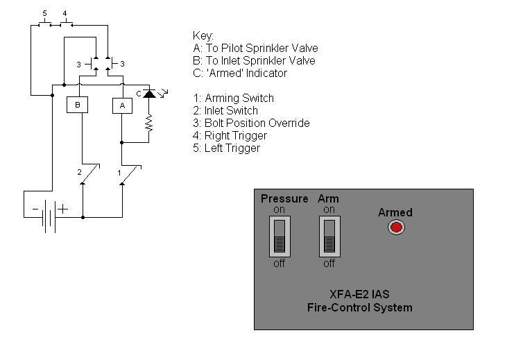

Circuit Diagram of the XFA-E2 IAS control system, developed for the X-ACS Program.

that hole can't vent the pilot completely, it will just vent enough so the bolt can move back enough to close the hole, but not all the way. don't even think about making the hole longer because thats irrational, when you open the valve the bolt would not move and the air would just vent out the hole
get rid of the hole in the pilot and replace the valve in the back with a 3way 2position valve
