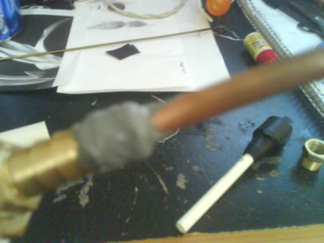

Gah! I cant test because the "small" whole i had is larger than i had initially thought. I tried to epoxy some copper tubing into a brass hose barb and its leaking. I guess im going to mix up some more epoxy and give it another go. I hope it work.s I want to do this so bad man.
Wow. That was a terrible epoxy job. I think i had too much hardener and not enough resin. As soon as i started twisted the hose barb the epxoy started to fall right off.
Well its all epoxied up. Hopefully that my only leak. Im out of epoxy. What i have is a half inch to one fourth inch adapter. The hose barb is screwed into that and then i slide my copper tubing into the hole of the hose barb. I find this effective in keeping the tube straight. I thought i had it fixed but it was leaking from where the tubing was inside the hose bard. So i covered the part of the tube that goes in the barb with epxoy and slid it in. I made sure to put excess so it makes a good epoxy on the inside and underside. Then i epoxied around the tip of it. I hope it holds.

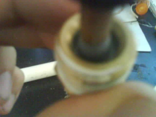

Just to clear things up. I switched my piston, to the crayola marker, for a tighter fit. I went to test it and i had a pretty bad leak at my hose barb so i epoxied that last night and let it dry over night. And thats where im at right now.

Epoxy repair escapade was a success. I can pressurize with no leaks. NONE. It hols air steady without dropping.
But i tihnk my piston seals too well. Like the copper tubing pushes too far into the rubber pad and it gets stuck and wont pilot....

- Inside of adapter.
- DSC00693.JPG (32.34 KiB) Viewed 3250 times
- New crayola piston.
- DSC00691.JPG (34.43 KiB) Viewed 3250 times
Macro mode on the camera please...the little flower. Your pics are out of focus on the things you want to show.
It was suggested earlier that you use real rubber seals and not mouse pad material. I again offer that suggestion for the sealing face...mouse pad foam will be fine for the bumper.
