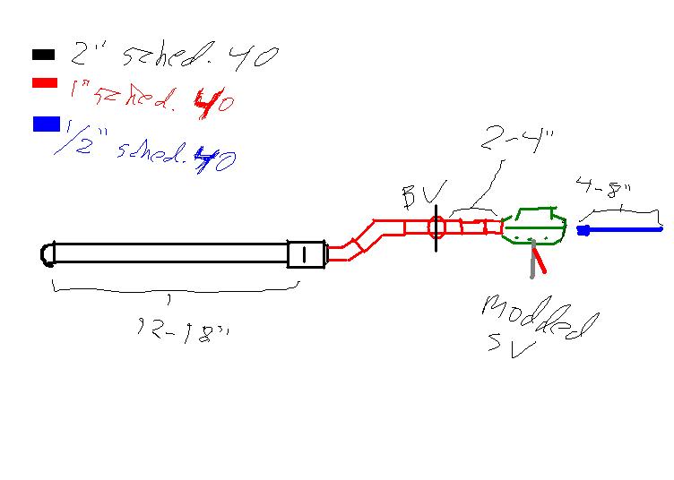

okay, here is my concept for a multi-shot nerf gun. It consists of a large primary air chamber which fills a very small firing chamber via a ball valve, the ball valve is closed, and then a modded sprinkler valve is used as the firing valve. I was wondering, what would be a good operating pressure, and how many shots do you think I could get with it? (note- 1" firing chamber will most likely be smaller than shown in the picture, it will probably be 1/2"-2" long)
edit- click the pic to read it better

it would work but your shots would get less and less powerful maybe you could upgrade to 3 inch pvc for the chamber

yes, but not refill it, I am considering a sliding breach if I make an additional longer barrel

well sadly sprinkler valves, because the way the operate, do not close immediately when a very sudden increase of pressure is introduced, like from opening the ball valve quickly, you would have to open it so slowly and carefully it would kill the fun, it is possible that you could leave the ball valve slightly open, but in that case I would recommend a needle or gate valve to regulate flow better. the best solution would be to use a ball valve instead of a sprinkler valve

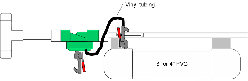

I would recommend moving toward a slightly different approach if you really want to use a sprinkler valve, Since there is no need for a high flow connection between the big chamber and little chamber, you can design the gun with a large chamber made from a section of large pipe and 2 end caps, large pipe (although most stores don't sell sch40 fitting larger than 2" they still sell large end caps in sch40) that is attached to the smaller chamber with a vinyl tube
examples
but note the flow restriction from the vinyl tube may not slow flow enough to directly connect to the chamber and not waste significant amounts of air immediately after firing, you could use a blowgun or small ball valve to cut off flow to the small chamber, or you could try plugging one of the vinyl tube fittings with epoxy and drill a pinhole in the epoxy
