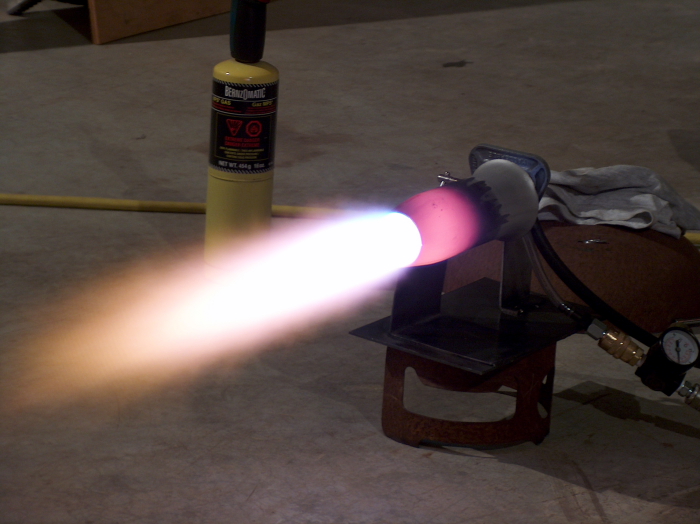

Syphon burner prototype. Burning a mix of WMO and diesel @ 80psi. 2 liters every 15 minutes. Non flash photography showing IR and near IR zones.

@brplatz;
Yes it's mine. 2nd version. I was tinkering with waste oil burners at the time.
If you're after thrust, stick with the pulse jet. All mine does is make a LOT of heat. (And a Ridiculous amount of noise. 8) (Although version 2 is substantially quieter than version 1))

If I used the correct spelling it would help your search eh?
SIPHON nozzles are pretty simple, at least in theory. :wink:
Air blowing through a chamber, creates a vacuum, which "siphons" the oil/diesel up to the chamber.
The high velocity air stream then breaks the oil into small droplets.(atomizing)
That is a siphon nozzle simplified.
And then the important part...The droplets hit the "burn tube" , vaporize (you can't burn liquids, only vapours), mix with the additional incoming "combustion" air, and ignite.
Getting it all to work "together" is the fun part. :wink:
