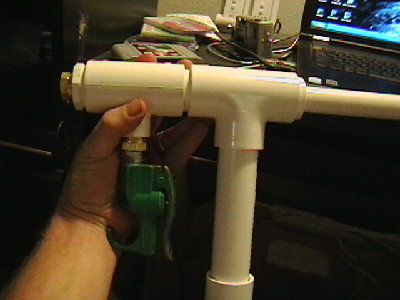

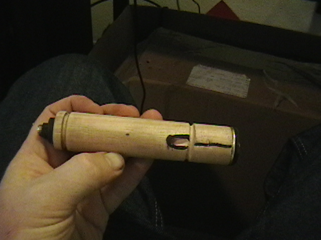

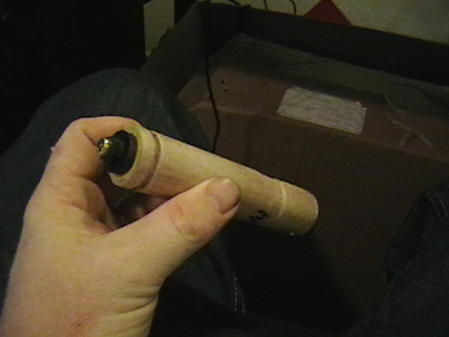

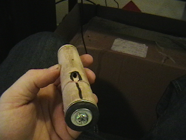

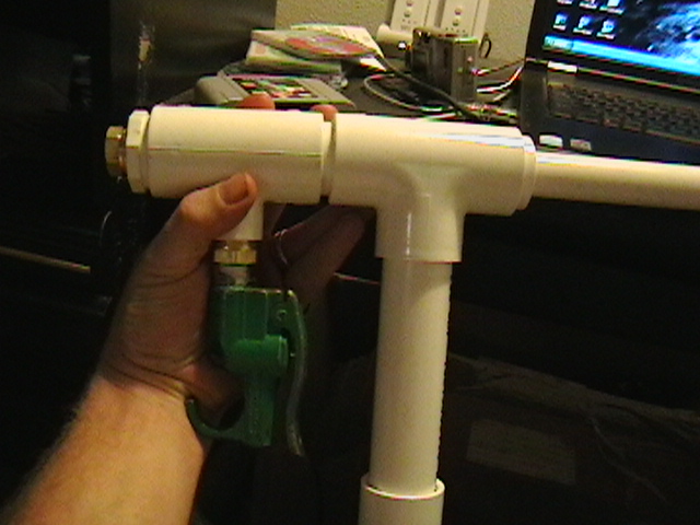

Okay, I'm taking on the challenge of building a piston valve for the first time. I'm using wood, with a neoprene washer, but my real problem is getting the piston to seal before the chamber begins to fill... I'm thinking of using a schrader in the back of my piston to create enough pressure in the pilot volume to seal the chamber before it fills... I believe I have heard here before that a schrader will open at 90psi, if this is true, I really need to know soon so I can begin construction... I included a few pictures, the black oval is connected through to the hole in the back of my piston, where the schrader valve is shown...

im not exactly sure what youre doing? are you trying to fill the chamber via the piston?. a diagram would be nice just for readability issues.

...um not exactly... the schrader valve was just gonna be a way to get a positive differential pressure in the pilot volume, i.e. the valve would be completely inside the gun, with another valve behind it to fill the gun with...

it really depends how tight fitting your piston is, and maybe you need to think about a softer sealing face before overcomplicating things, its a good idea though, if i ever build a larger bore piston cannon then i have thought about putting a check valve in the piston .
edit: thinking some more, a check/schrader should be unecesary as long as the piston is tight fitting and the sealing face is soft enough because a piston should seal with the same pressure on both sides because there is more surface area on the back than the front so more force is 'pushing' it foreward regardless of pressure differential.
edit 2: i assume you have made the piston tight fitting anyway or the shrader would have no effect? so maybe the sealing face is at fault?

I used this same idea on my 4 inch piston, simply threaded a hole in the front of the machined piston and screwed in a schrader valve, it worked flawlessly but the chamber leaked.
It would also lower the max PSI that your chamber gets too i think (in an o'ring piston).

In the search for increased efficiency, controlling air flow within the valve is a worthwhile idea.
I use a "floating o-ring" on the piston for my copper gun. It is simply a slightly loose o-ring groove with a hole drilled into the side of the piston.
The drilled hole is half in, and half out of the groove on the chamber side.
The piston fits closely, and seals the barrel immediately upon pressurizing.
Pressure then fills the chamber to the same level as the pilot.
Upon firing (piloting), the o-ring on the piston is forced (by pressure differential) to seal the pilot volume off from the chamber volume.
Although, it would likely work without the o-ring, I doubt it would work as well.
And it does work very well IMO.

i can't see a schrader making much of a difference to be honest, in the time it takes for a piston to open, my relitivley heavy piston opens in 1ms according to GGDT, so thats no alot of time for the pilot to start emptying the chamber
so the problem only occurs, if you have a loose piston that is overly heavy, then the air can leak around as you are piloting because it would take longer to open.
so as i said before, i still think the sealing face is at fault or the piston is not tight fitting enough?
edit: after looking at your piston pics again, one factor causing the problem could the the small piston diameter compared to the barrel diameter? because then not much gas can get infront of the piston to 'push' it back when you pilot it.

I used the schrader as a check valve within the piston, the chamber was filling through only the schrader.
The valve needs pressure to open, hence less pressure in the chamber upon filling, only like 5psi but it all counts
