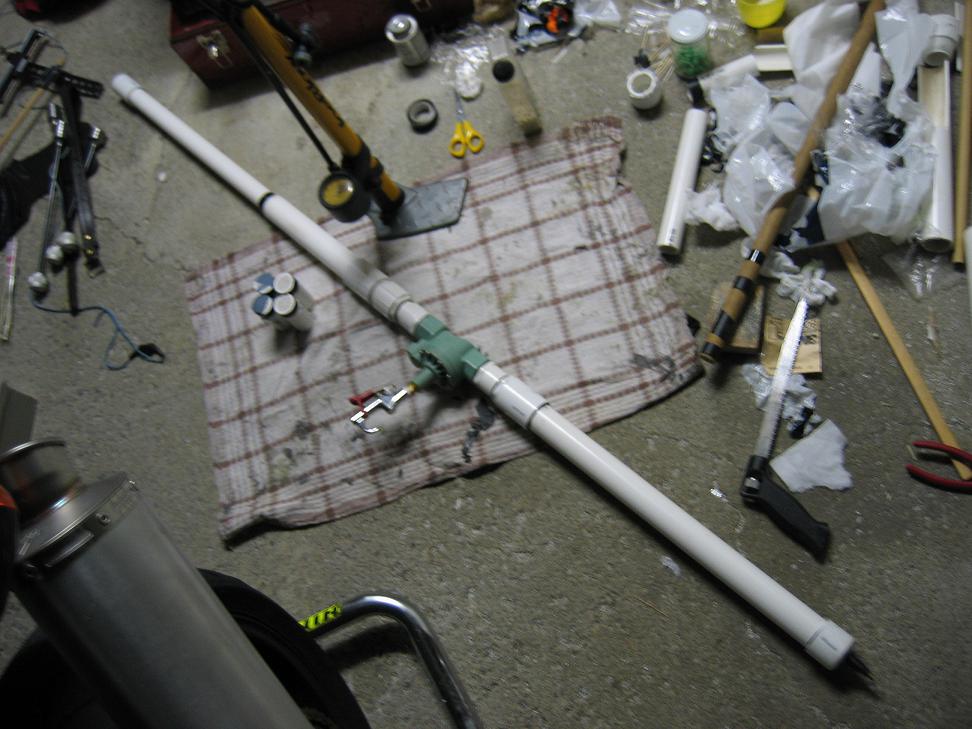

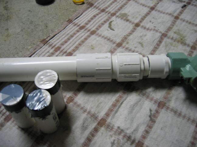

The specs:
1 inch x 2 foots barrel.
modded sprinkler valve(1 inch).
1.25 inch by 2 foots chamber.
I do "clay" shooting with it(throw a potato, aim and fire on it, lot of fun)
Its able to pierce 4 layers transport cardboard with .2 grams bbs(.2 are not enough heavy for this gun, i will need .3 or .4 ones).
There have been an error with pictures orders :oops:
Me holding the gun...

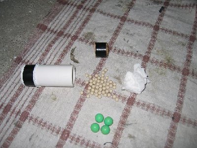

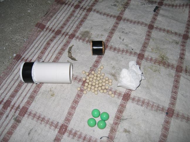

Different ammo...<br />(green bbs are mini paintballs)
Different ammo...

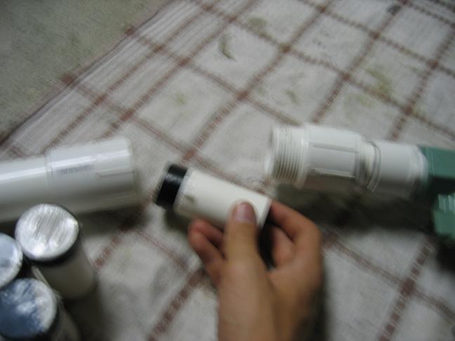

Loading done...
Loading done...
Loading...
Loading...
Loading...
Loading...

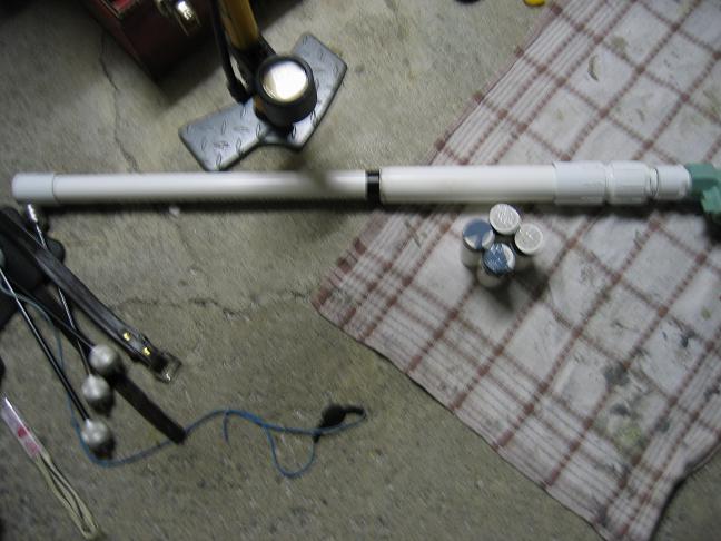

The barrel...
The barrel...

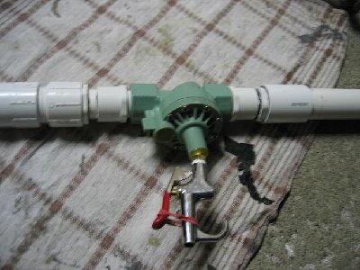

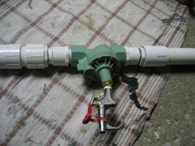

The valve...
The valve...

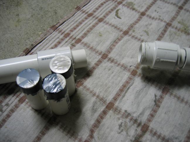

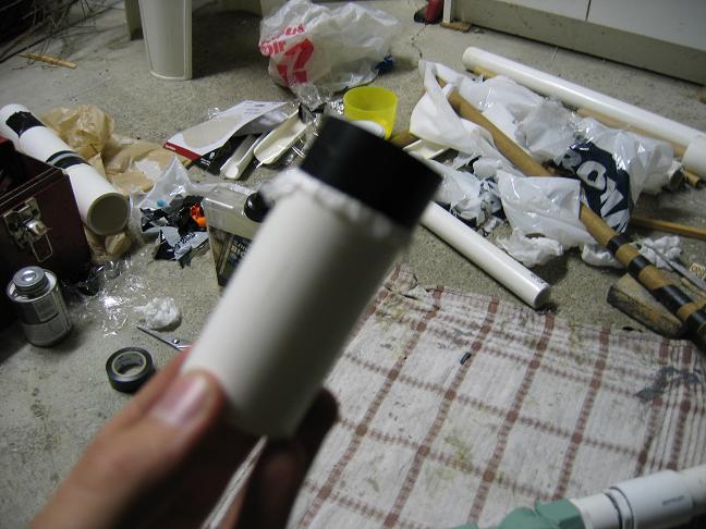

The catridge...
The catridge...
The gun...
The gun...

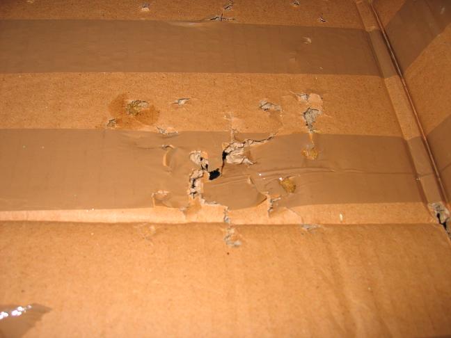

DAMAGE!<br />(i am not sure if it was an dog food round or an airsoft one)<br />Paintballs go trough 3 layers of it!
DAMAGE!
Photo 015.jpg (35.85 KiB) Viewed 4081 times

and for the damage picture it is an dog food round.
Getting trough heavy cardboard with dog food!

The one you just see are the old version, i now only put 2 wads of toilet paper on each side. less time to make and same results.
but the plastic bag ones looks better :D

Looks good, and yeah, you have to upload the pictures in reverse order if you want em the way you had them in order.
The only thing I would comment on is the valve, it seems to have a narrow spigot-thing sticking out the top that was most likely associated with some piece of unnecessary hardware. I usually just like straight, frill-less, 1" Orbit-Masters. But, it's just an opinion, and it it works the same then it was all for nothing, right?
