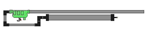

Here are my final plans for the pneumatic,
the barrel is 1"
the stock is 1"
and the camber, is 2".
All the pieces will be threaded and i already have the most of the parts! :D
I think it will be an awesome pneumatic!
here:
Well?
Well?
awsome pneumatic.PNG (10.84 KiB) Viewed 4657 times
psycix
Posts: 3684
Location: The Netherlands
Not bad.
Chamber is somewhat large I think.
And whats with the excessive use of those elbows?
Spudfiles steam group, join!

What will you shoot with that?
Try chick peas with a wadding :wink:
Psycix is right, this will put a lot of flow restriction...
Well, do you have any suggestion for something else?
starman
Sergeant Major
Sergeant Major
Posts: 3027
Location: Simpsonville, SC
And why all threaded parts? Sealing becomes more of a challenge.
Chamber could be 1/2 or even 1/3 that length.

All threaded parts, because i can't find any PVC glue
in my country, so i have to use threaded with teflon.

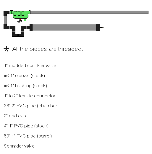

elad311 wrote:Well, do you have any suggestion for something else?
Yes - you see that cluster of the three elbows in the bottom left? Swap them out with just one - Less parts to buy, less joints, and less flow restriction.
End result should resemble this more:
thanx, for the plan, Ragnarok.
