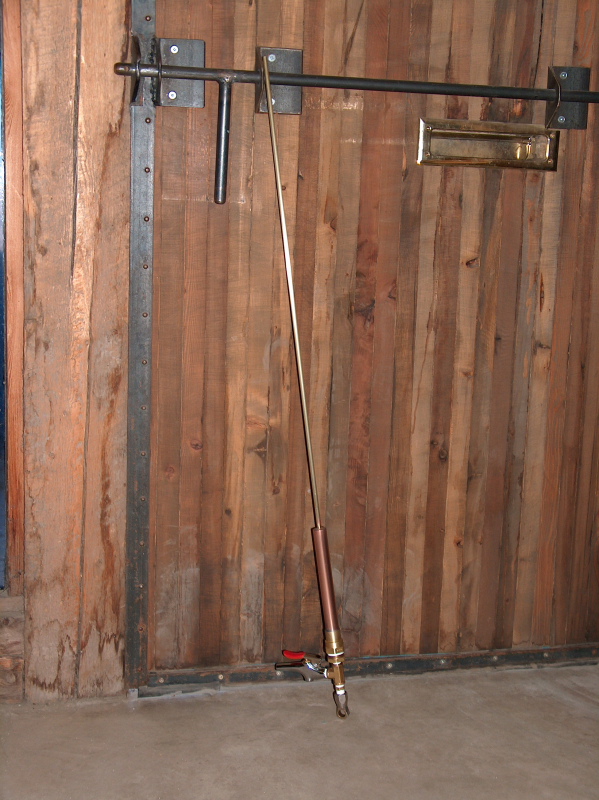

Barrel: 36" of 9/32" .014"wall brass tube
Chamber: 6" (interior length) of 3/4" Type M copper
C:B of 1.5:1

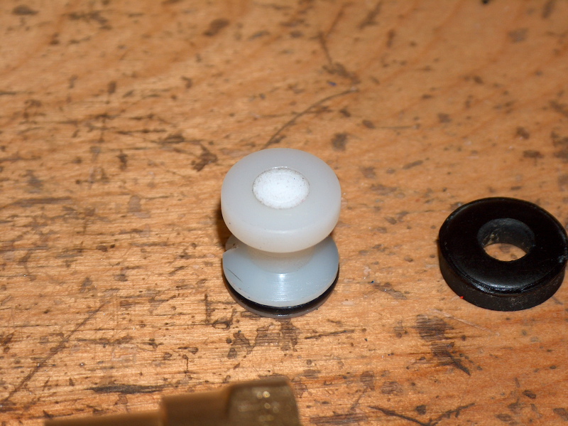

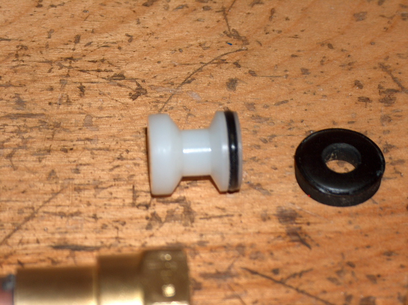

Co-axial piston machined from nylon, with a teflon sealing face and floating o-ring seal

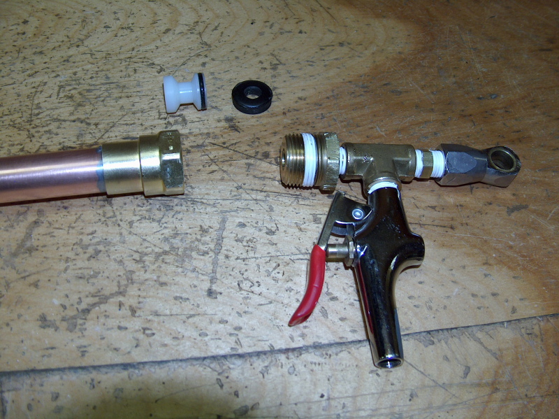

Pilot assembly: "Borrowed" from my copper gun. Features a modded blow gun, and an improvised probe style fill.

Can't wait for a confirmed >Mach 1 shot. Tough, wouldn't it be better with a bigger chamber and longer barrel? (Just guessing)

I wouldn't personally call this a mini, too long in my opinion - I think of it more as pistol sized, but if you prefer...

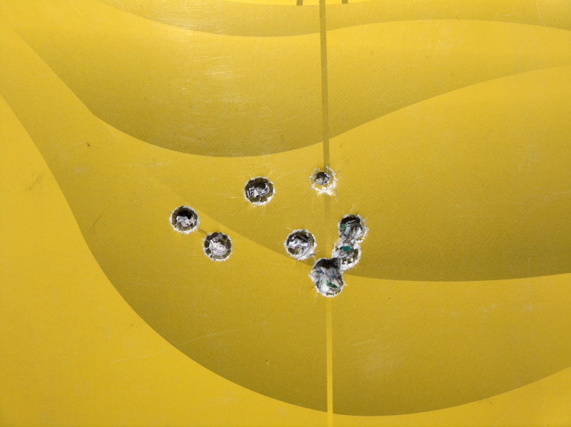

Looks nice and shiny. What range were you shooting that target at? 'Cos that ain't a bad group. (EDIT: Saw the video. This last comment no longer applies)

that. Piston. Made. Me. Need. Paper. Towels.
How did you make such a bloody beautiful Item?
that and, For gods sake, Shoot a full can of seltzer water. You will be suprised. And catch it on video.
That and what is that fill thing your using? Ive never seen it before.
Im envious on the sexyness of this cannon.
