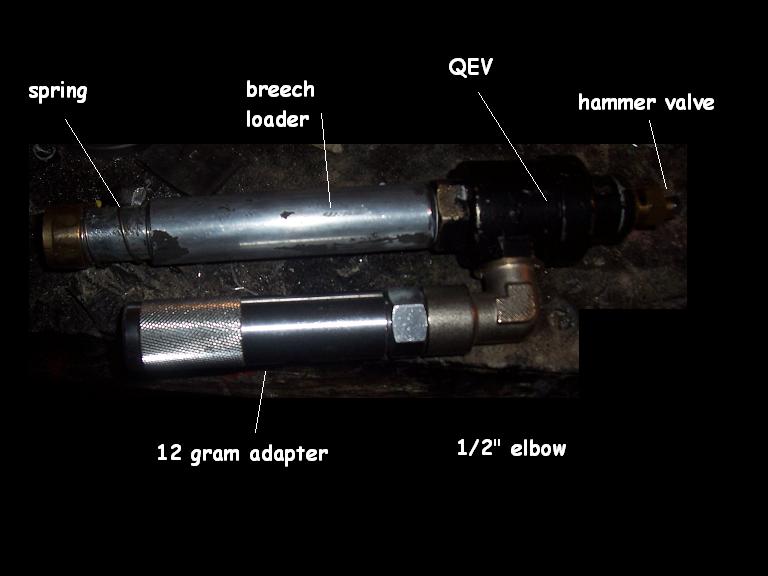

I used old parts, for now, and tested a QEV at full unregged CO2 pressure.
The QEV held up nice.The valve was already modded to accept filling from the chamber side.
I hooked it up through an elbow, straight to a 12 gram adapter.
A hammer valve at the back does the rest.I had to mod a few things for everything to fit together..
Voila, a 900 psi repeater in 1/2" bore, firing lead balls halfway into wood, with a barrel effectively SHORTER that the 12 gram adapter!
Just take a look at the pic and you can see it is just pistol sized!
Halfway won;t do it for me, so I'll have to get me a longer barrel than that, but still.
Pleasing results!
Need a heavy hammer to set it off though.
But like with BT2B, I'll get it done.
About 6 shots a capsule.
Want to know about the name LUPARA, google it!
Just the basic pneumatic components.Striking the back with a ( regular ) hammer, sets it off.<br />Just a test right now.It might be turned into a revolver, or pump action, I don't know.<br />Lot's of possibilities.

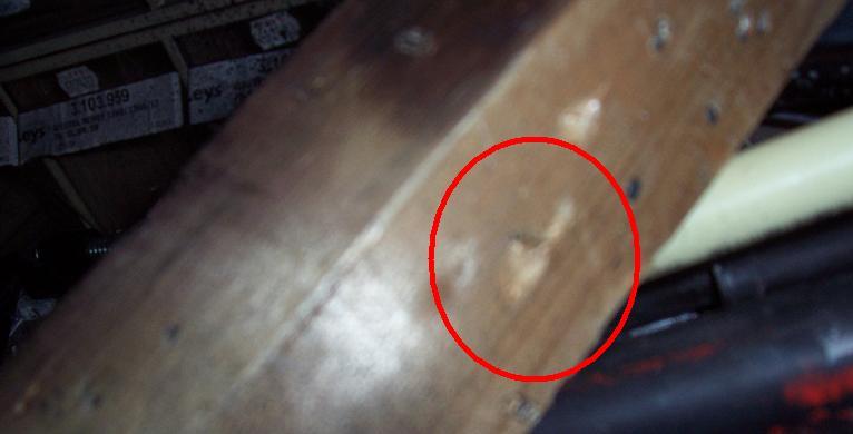

Damage.Might seem unimpressive, but the lead ball was flattened!<br />Longer barrel means all the way in next time!

whats the hammer valve like, is it just check-valve/non-return valve style?

It will for 6 shots, if you mod the QEV.
And use one heck of a hammer.
The output is more than enough to justify a longer barrel.
It will become much more effective, and more quiet as a result.
Normally a pneumatic dumps all it;s pressure, but not this one, so a longer barrel silences it.Well, not the hammer valve of course.
If you want to find out how to mod a qev, look up my BT2B thread and the 35 bar repeater.
JSR will probably provide the links anyway..
EDIT: the hammer valve is a poppet style valve.
Think bolt through hole, O-ring behind the bolthead.Like that.
yeah makes sense, is it a BTB custom? or an off the shelf part?
Netherlands
Posts: 3497
Custom, but no need for it to be.
I made it from a stock part that just had the wrong thread size.
A cut-up safety valve replaces the body, the stem I kept.
Threaded it to accept a small nut so I could keep it all together with a spring.
O-ring and bolt works just the same..
