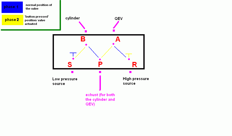

it seems that I was wrong.. I think it is doable with a manually actuated valve but mine is a soleniod one... it's a 5/2 solenoid spool valve (5 way / 2 positon valve)
the reason why it won't work is becasue my valve has to always have pressure at port P otherwise it won't 'switch' (there is a small orfice there - I assume it's used for 'switching' the valve)
now... a diagram showing how it could work...
forgive me its poor quality I hope it's comprehendable... I put both phases in one picture that's why there are two colored arrows showing how air flow through the valve...
*phase 2 is when I press the button/actuate the valve
*a cylinder can be either double acting with the other side filled with pressurised air or single acting
*Port 'P' was meant to be used as an exhaust for both the QEV and the cylinder
obviously I could have done more reaserch before ordering a valve.... the good thing is that I will find some use for it

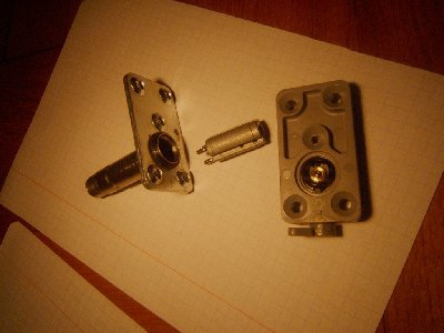

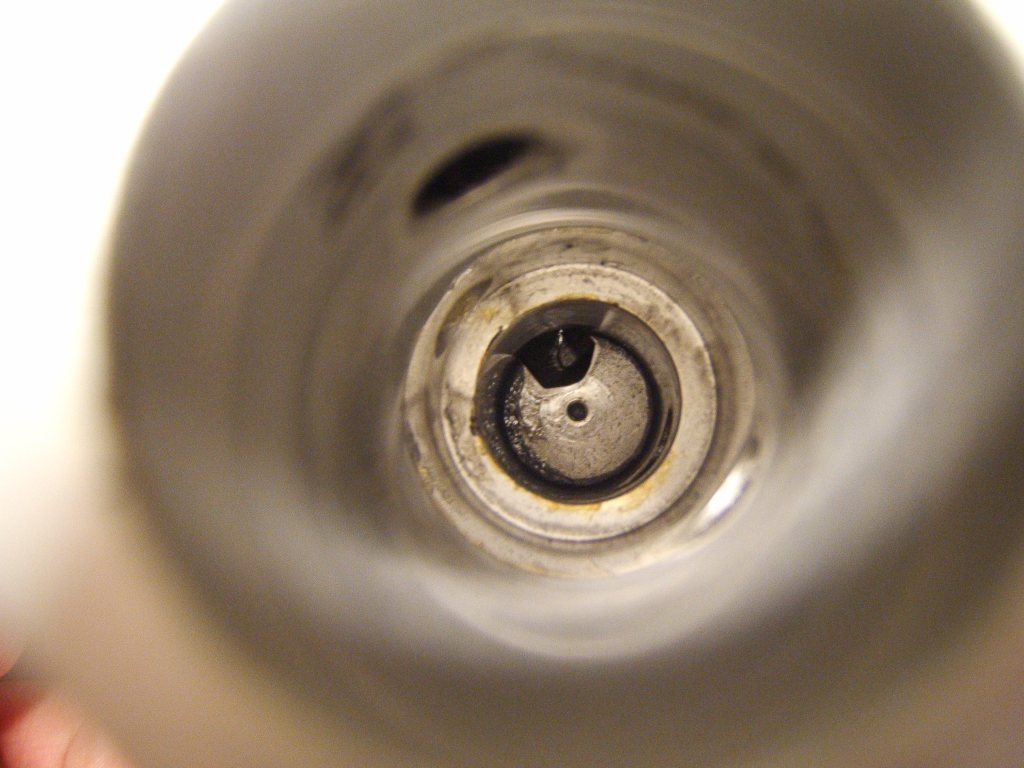

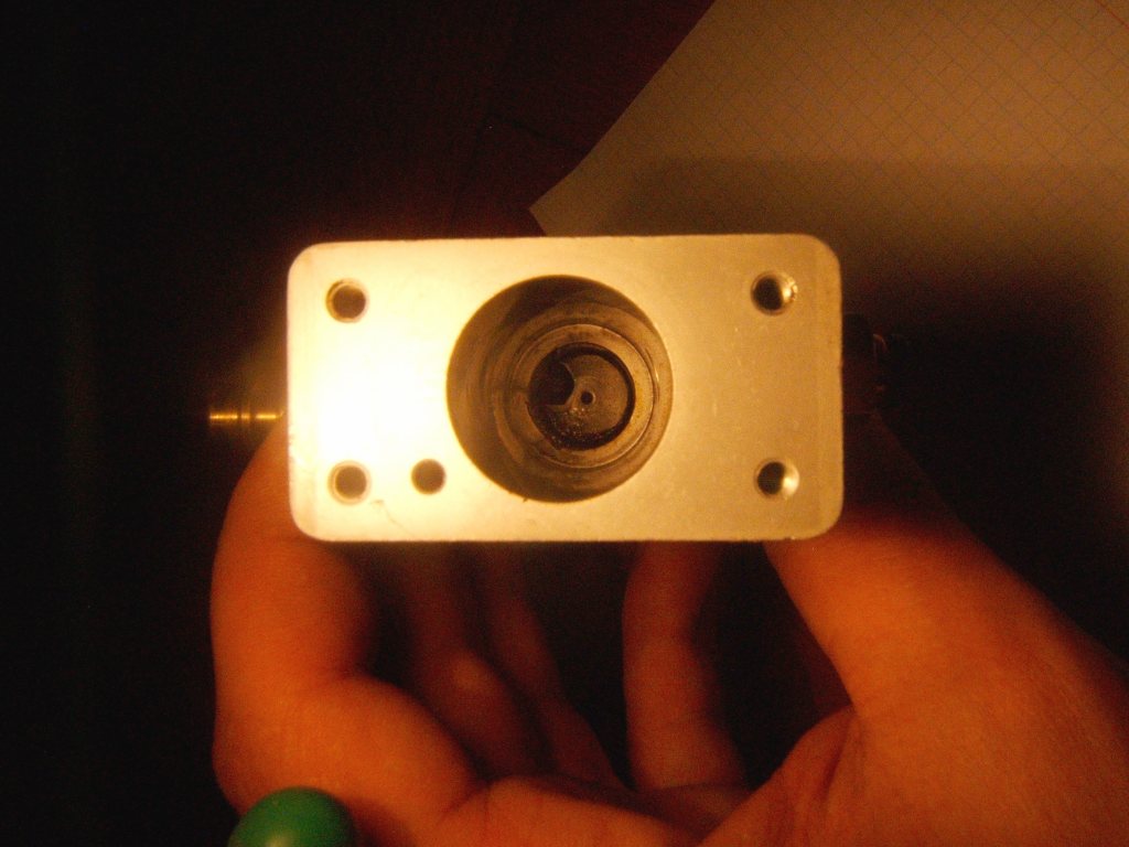

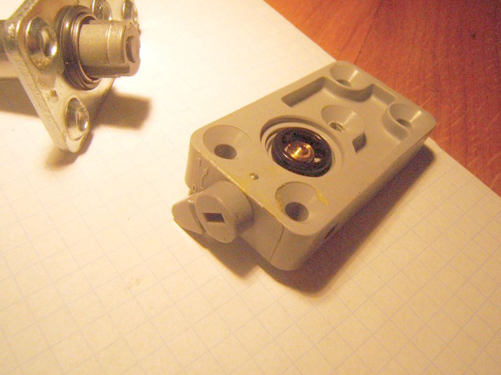

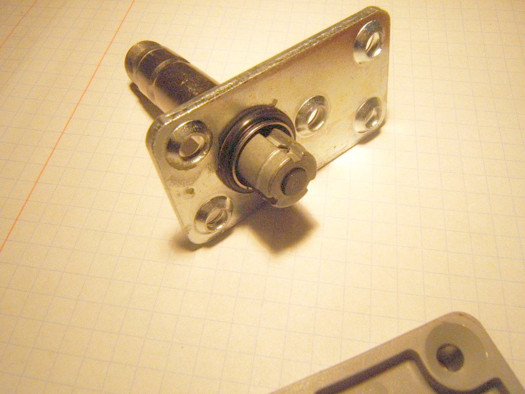

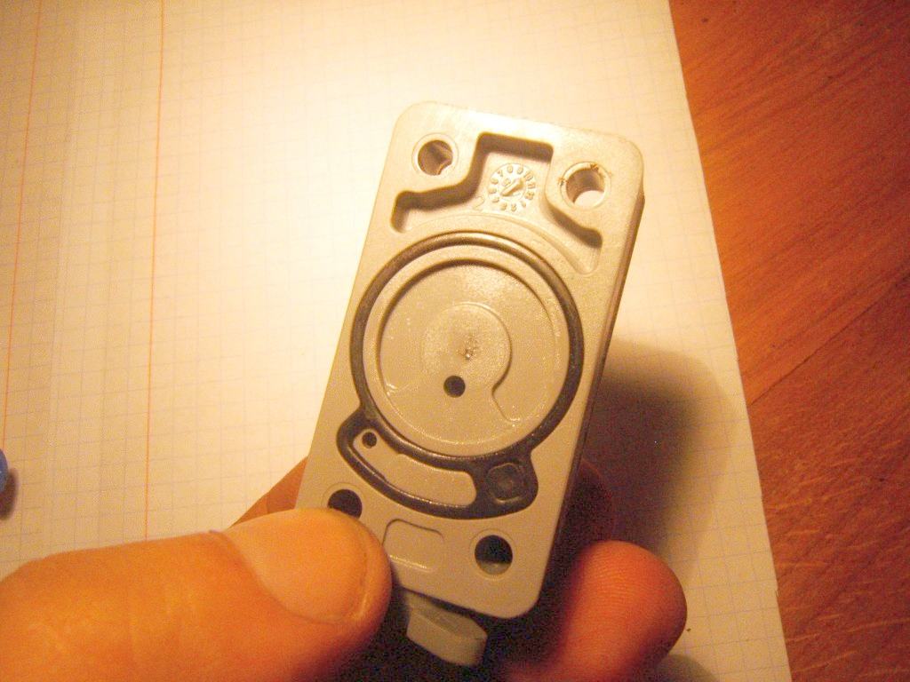

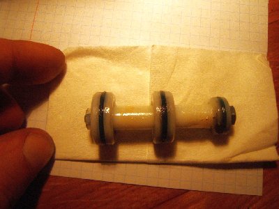

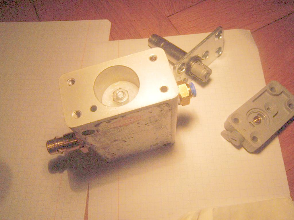

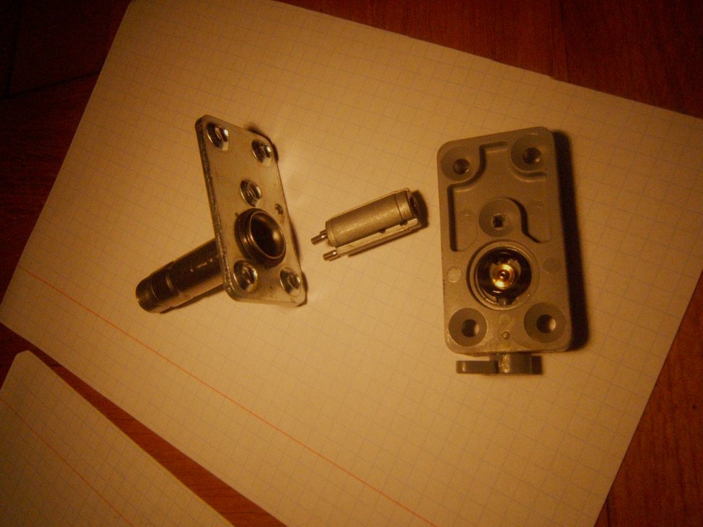

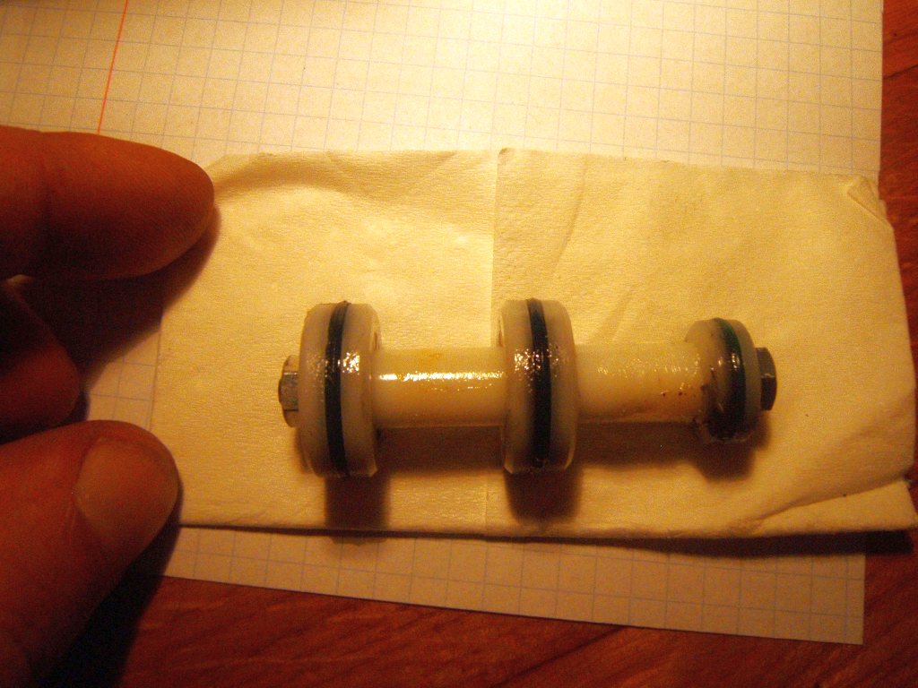

I disasembled the valve just for the fun of doing it and to learn something... I am not good at taking pictures so sorry it's so dark
EDIT I increased gamma
EDIT no2 I fucked up the order of pics... but I think you understand what is what

I guess I can say a thing or two about solenoid valves using this example.
Most valve bodies can handle a lot more than the valves are rated to. Unfortunatelly there are other limiting factors than that
See this plunger ? when you energize the solenoid it moves up and exposes that little hole. Air from one side of the spool valve vents to the atmosphere through that hole and the spool switches.
When you use pressures higher than recomended pressure will force the plunger up and air will leak.
If anyone wants to modify a valve like this one to use at higher pressures you'd need to replace the spring behind the plunger with a stronger one. Probably you'd have to use higher voltages too.
You can see similar valves (indirect acting) here
When it comes to direct acting valves.... so valves that look like this
...it is basically the same but there is no spool. The only valve in there is the plunger itself.
