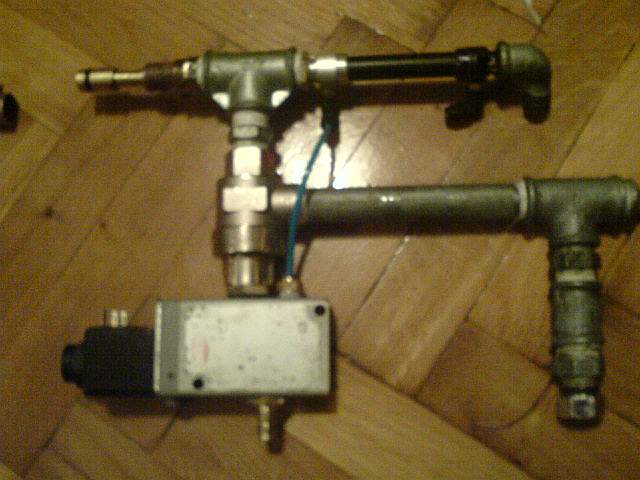

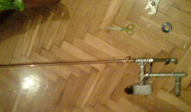

ok I finally finished my semiauto marble QEV gun... I designed the gun over 1 year ago... it took me some time to finish it....
it's quite funny that this is acctually the first gun I posted here
Specs
barrel - 98 cm of 16mm ID copper pipe {thats proper barrel lenght, that is - (overall barrel and T lenght) - (dead space)}
chamber - about 50-60 ccm (yeah I know it's smallish)
firing valve - 1/2" QEV
air cylinder - 15mm X 50mm stroke double acting; 3/8 male threads on both ends - one of them is joined with a 1/2" - 3/8" male-female adapter which is screwed into the 1/2" T which joins the QEV the barrel and 5 way valve toghether... the other one has a 3/8" elbow screwed on - just to avoid dammaging my cheek when I fire something heavier)
bolt - it used to be a part of some really old equipment/piece of junk I found in the basement... it's just a tube made from brass which has a female threads one one end that perfectly matched those one the air cylinder... surprisingly it even had two grooves for o-rings and a dimeter of 15mm... so to put it short - it's exactly what I needed and it was just lying in basement waiting for me to incorporate it into my gun :shock:
pilot valve - 1/4" 5 way solenoid spool valve... it has mechanical overide
ammo - 15mm marbles (acctually 95% of them are between 15.5 - 15.8 mm... the rest casues jams)

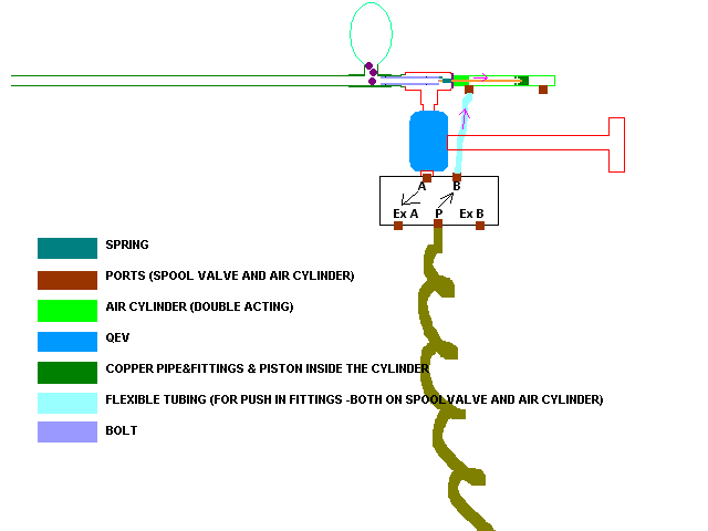

I forgot to add how it works...
first of all it's just a QEV pneumatic with a 5 way valve...
The 5 way valve is for filling/piloting the QEV and piloting/filling double acting cylinder (turned into single acting one with an addition of a spring)
In one postion the 5 way valve directs air to the QEV (filling it) while at the same time venting air from the aircylinder.... in the other position the QEV is being piloted while air is being directed to the air cylinder, which, as a result, retracts....
the copper T houses the bolt.. a homemade hopper with marbles (which is not inluded in pics and the video) is joined to the upper port of the copper T...
it's all very simple and very straight forward...
so far I tested it at up to 300 psi and it works good... seals/o-rings still need some tweaking becasue some air gets past through them which hinders performance..... I realize that the chamber is rather small but I didn't know how many shots I could get with the fridge compressor.... increasing it is just a matter of time

for now - two pics that some of you have already seen and a video showing how the bolt operates...
sorry for low quality of the video - my camera doesn't work well in low light conditions so I had to use a mobile phone
EDIT
animated schematic added
