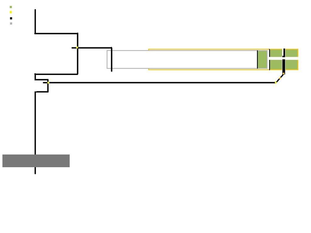

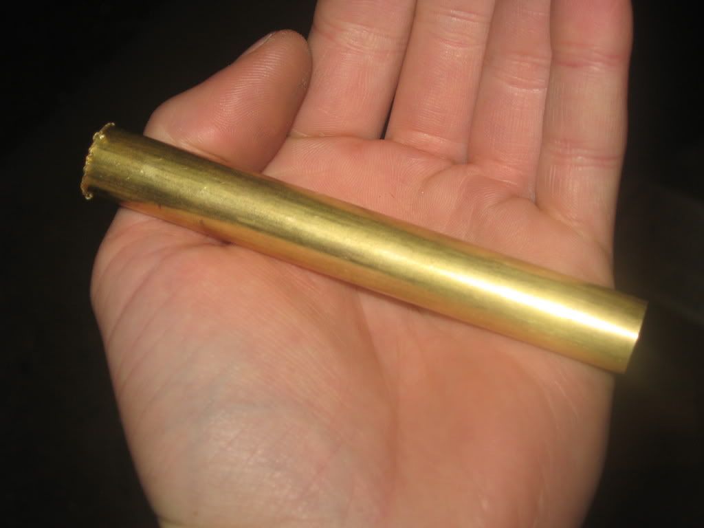

Well, Ive decided to construct a steam engine, As I have seen many of them around the internet, All of them relatively Simple. Below are my plans, And some pictures of the parts I have started (the Cylinder/valve and Piston)
Questions/comments/ideas are 100% welcome
Piston (1/2OD aluminum tube)
Cylinder (17/32 Brass Tubing)
Design Drawing (Crude, And probably not even timed correctly... And I know the Valve linkage will not work... Im making it Linear.)

My design has been revised so that I do not need a right-angle linkage for the valve, It goes along Side. I have to purchase some more tubing, But I suspect this will be done relatively soon. Its not that complex..... And actually requires no perfect seals, seeing as it runs at around 3-20 PSI.

That makes your life alot simpler, what you are constructing then is not really a steam engine but more a CO2 motor. A few good animation of steam engines can be found here: http://www.keveney.com/Engines.html
PS I would suggest deburrign the left edge of your copper housing when looking at your picture of it.

Well I started work on my Valve today, And Realized a few things:
1. Keeping the valve linear is FAR superior to the farking right angle valve thing. Less mechanical resistance and alot less of a sideways footprint.
2. the valve crank MUST BE 90 degrees out-of-phase, not 180 or 0, because you want the air valve switching full positions when the valve is at the midpoint of its travel.
3. Reciprocating (valve based on piston side-to-side movement) engines are simpler in construction, But I lack the metal and precise drilling required to construct such a Device. Maybe If my friend lets me use his dad's machine shop for a few hours.....
