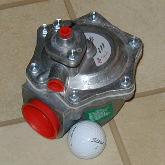

Just took delivery of a 1.5" Asco QEV. I'm liking it. Cv = 50. Best part? Right off the shelf it has a pilot valve built into it. That is to say...
...See the red cap on the top? That's a 1/8" NPT fitting. Put a blow gun on there and it opens up a small diaphram valve that dumps out of a 3/8" NPT fitting (the red cap just below the 1/8" fitting). This 3/8" valve, of course, in vents the primary valve and away we go.
A high-flow cascading system perfect for spudding with no work! :P

D_Hall wrote:I've decided that I want to go for Mach with a golfball
With that valve and a long enough barrel and high enough pressure, I'm sure you can get pretty darn close. I'm guessing it would take 300 psi or so easily.

jackssmirkingrevenge wrote:With that valve and a long enough barrel and high enough pressure, I'm sure you can get pretty darn close. I'm guessing it would take 300 psi or so easily.
Well, there is the whole problem of it being an unheated gas in there. Also, I'm not one to push valves much (if at all) beyond their ratings. This one is rated at 125. I won't go past 150 under any circumstances.
Nay, when I go for Mach... Well, I've got some 5" ID, 7" OD pipe lying around (yes, 1" wall) that I could really make one hell of a hybrid out of, but it'll take some welding. I don't weld and right now my honey do list is loooong. If I'm lucky, I'll get started on that a year from now. Good news is that I ought to be able to recycle the barrel from whatever I build right now (simple pneumatic).

i have a 1" qev thats a beast pilotet by a 1/2 qev with blowgun i use it at marble gun , at 100 - 200 psi . allways wear eye saftey , soory for my english

I believe Velocity's "Midsize Pneumatic Launcher (Original)" used a similar valve. I'm going to be putting the same concept to use on a piston valve I'm designing right now as well. If you can get the valve cheap it's definitely an advantage over having to buy a separate quick-exhaust or build a separate pilot.
