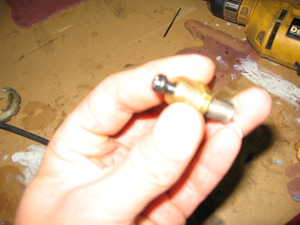

showing what happens when you depress the button...<br /><br />this is my second one, the bolt is a little long and it uses a differant spring than my first, but a made this one just for illustrating the construction method...

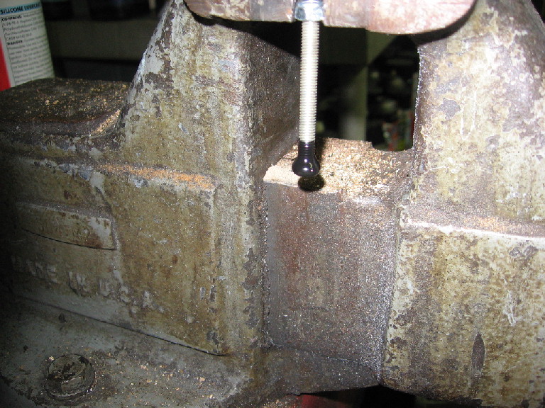

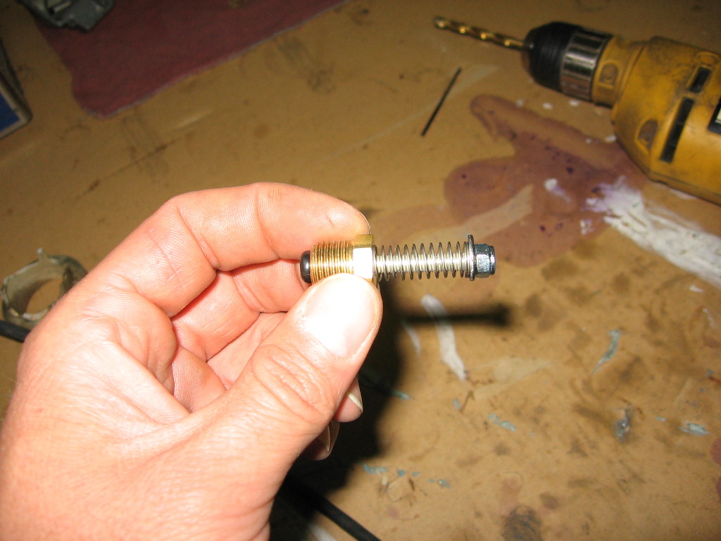

showing the complete assembly...<br /><br />I forgot to add that once the plastidip skins over real good, you can clamp the plug thread side up, and drop the screw down through to make sure the plastdip form a flat surface...

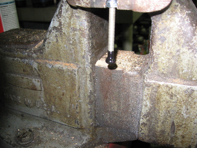

showing wha the head looks like right after dipping....

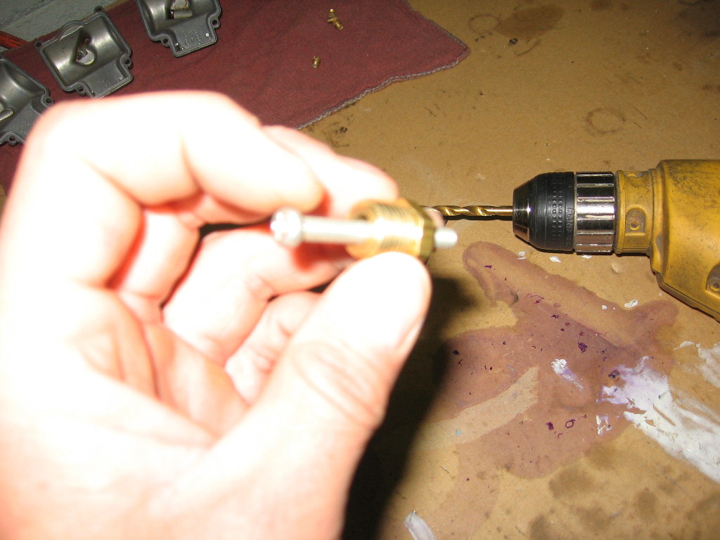

plug and panhead screw, showing how much vent clearance there is...

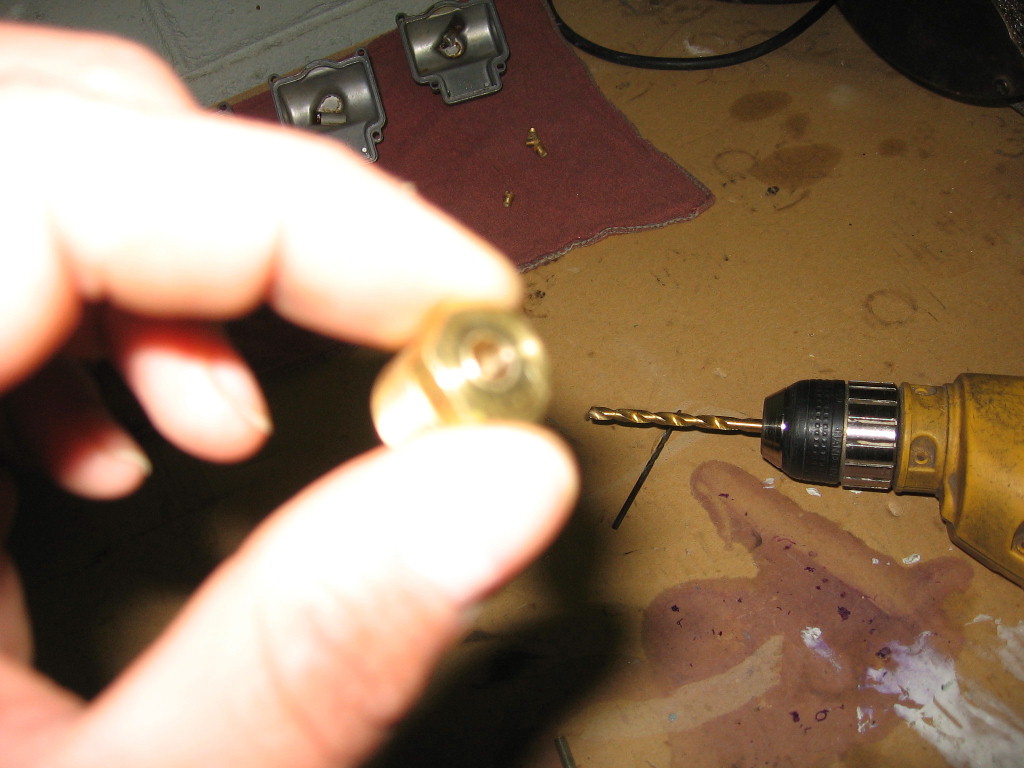

.25&amp;quot; plug with hole drilled
.25&quot; plug with hole drilled
