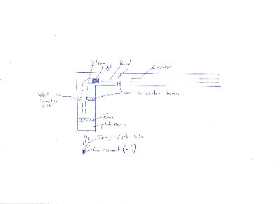

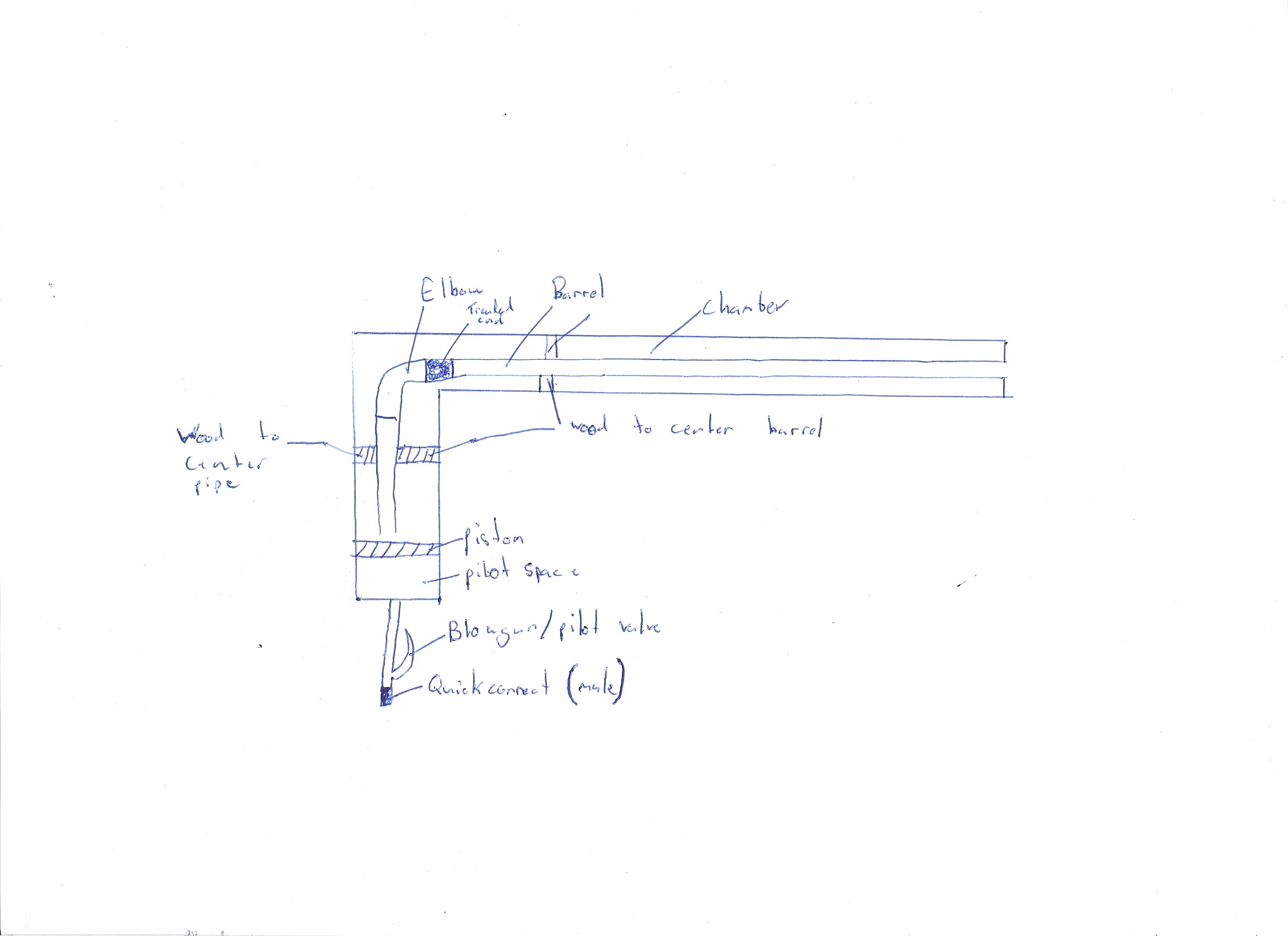

Hmm, the design is simple, and should work(if you leave the spring out and fill via pilot side it will work great) but the blow gun is in a really wierd position in tems of looks...
If you are going more for power than looks this is great, if not then try this(its new, its random, but hey, what else woudl you expect from me). I think the diagram makes sense on its own(that is if you manage to read my writing) if not, feel free to ask.

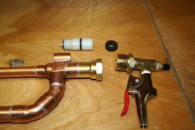

by the way: is it possible to hook up a schrader ( or smaller bike valve ) and a blowgun to the same endcap ?
Use a tee, like in the picture below. :)
