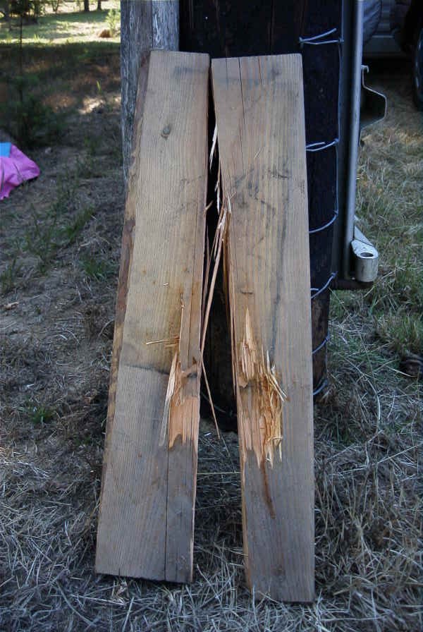

This cannon has a typical range of 525 feet with fallen apples and has split a 2X6 8 feet long.

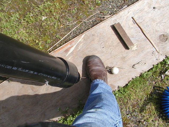

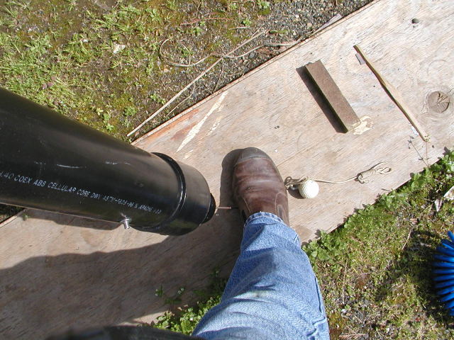

Due to the bulk of the chamber, this cannon is a very poor single person hand held, but it makes great mortar shots. Load it, stand it on end, step on the rope between the cannon and golf ball, grab the blue trim and lift.
:shock: Never ever load one of these while under pressure. Loading does the same thing to the core that pulling the rope does. :shock: :!: :!:

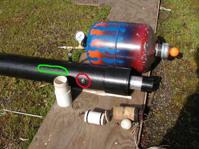

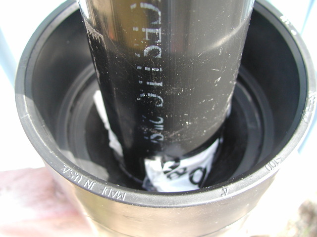

View of the valve ports before the chamber was installed.  A plastic bag is stuffed inside for the photo before the chamber is installed
ABS Test cannon parts.  Note ABS DWV Cellular core construction

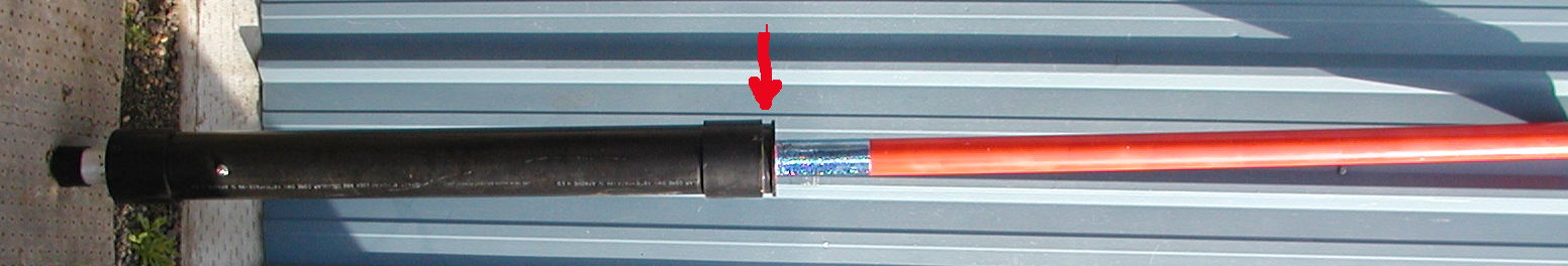

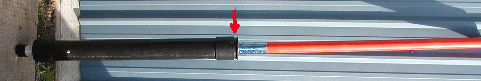

The ABS Apple Cannon<br />Note the end didn't get pushed in all the way.  It didn't leak or fail.
Core detail  All PVC and o rings.  It leaks a little due to the saw cuts.  Needed the ends polished before assembly.  Live and learn.

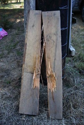

Here is a board hit with an apple from the ABS cannon.

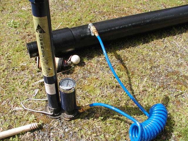

When pressure testing I stand behind it off to the side to stay out of the way of a split chamber or failed piston valve. The bumper and cap is removed in pressure testing to leak check.
***Edit*** Took and added pressure test photo for 2009
With the requirement to step on the rope and hold the blue ring to fire, the barrel is way over head so there are no close range shots as the breech remains close to the ground.

Pressure Test 2009.  <br />The core leaks a little due to the saw cut o ring grooves, so the 85 PSI test pressure bled to just over 80 by the time I grabbed the camera.<br /><br />I gotta make a new valve core for this.
Pressure Test 2009.
With the foot on the rope and holding the blue ring, the barrel is overhead.  Just lift to fire.

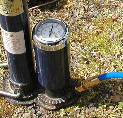

Close up of the gauge.

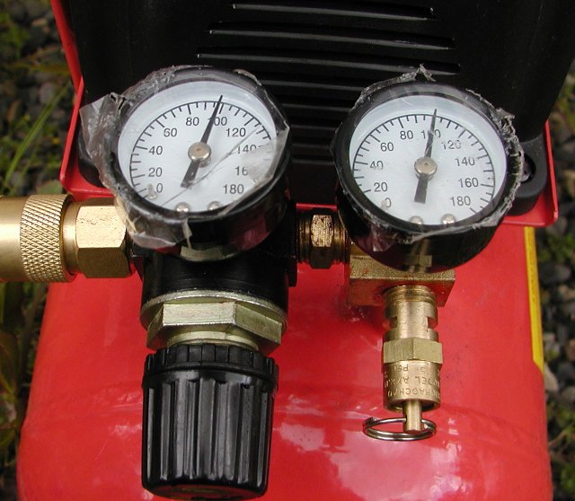

Testing all 3 QDV Cannons
30 Minute pressure test from 85-100 PSI
Damage from a 2 inch piece of 1 inch EMT electrical conduit.
Close-up of the gauges

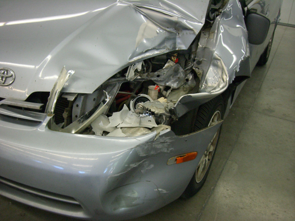

My Inverter car has been damaged. Bummer. The upside. Replaced it with a newer model. Seems a semi truck wanted my spot on the freeway.
Photo of the damage. Mirror was broken by hitting the pickup next to me, relatively minor damage. The semi crossed my hood and fender. You can see the path through the hood, engine compartment, and out over the fender.
My poor headllight
My poor headllight
