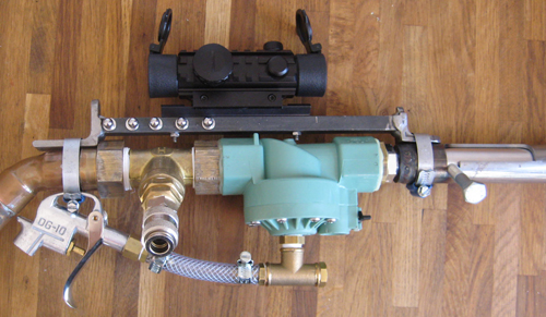

This is a rifle I made. Basic concept, quite self explaining. But I assure you, this ones fun to shoot with.
Features:

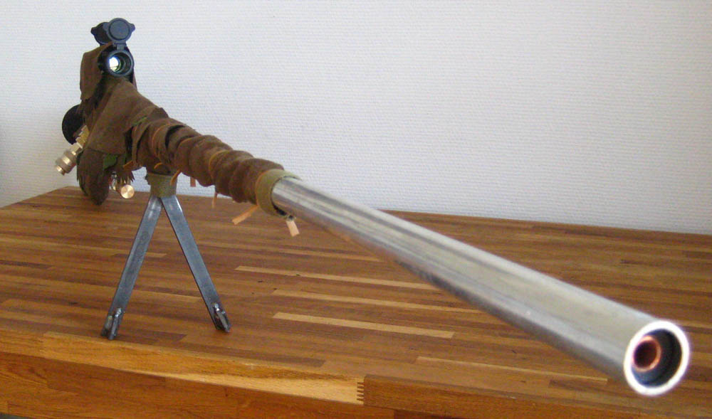

Barrel: 1m, 10mm copper pipe, with a hard steel + alu cover.
chamber: 5dl (500 cc) copper.
valve: 1" modified sprinkler valve.
Loading: Forward-breech.
Scope: 30mm red dot sight.
Ammo: 10mm Hardened Steel balls
I usually fire with about ~11bars of pressure (160Psi).
Before you comment:
-Yes I could/should make me a new bolt-handle
-Yes, it´s unpainted and thats just fine with me
-I know there´s no damage pictures; be patient.
New ideas and aspects are welcome!

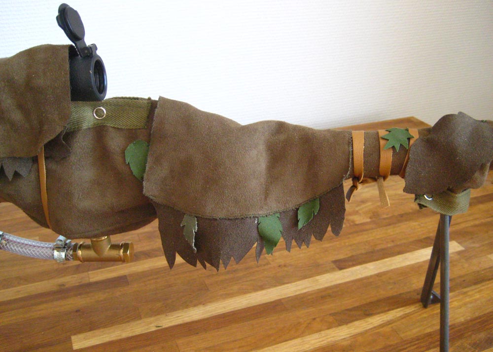

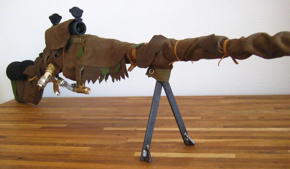

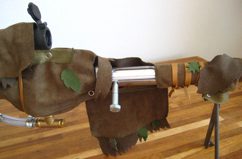

Added the bipod setup. 21/04
Added the forest-theme cammo, with leather straps and knots. 25/04

The Longbow. Updated with Cammo!

Wow. That is amazing for any gun...
I like how you sleeved your barrel in the metal tubing, and I really like your pilot setup for some reason.
Good to see yet another excellent contributor turn up. Good job!

thanks you all; and yes it´s milled.
Impressive, what's the accuracy like?
- boom_o_matic_2.0
- Posts: 190
- Joined: Tue Apr 14, 2009 6:46 pm
- Location: Danville, KY
verry nice. you're stock is the air chamber right?

nicce... how did you attach the scope??

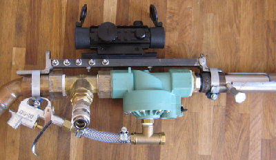

JSR: I haven't made a full scale long range accuracy test yet, but I will report back as soon as it´s done.
Poland: I´ve added a picture; showing the custom steel-bar which is supporting the uni-rail on which the scope is mounted. I´ve grinded/sanded the contact-areas, making the fixture firm and nice.

you might consider buying a QEV valve for more power... that chunk of PVC just doesn't fit there
ohh and I strongly suggest building a fridge compressor.... this gun is begging for 30 bars
you won't get good enough performance in this caliber without upping the pressure..
if you want long range shots you need that... the scope looks so good as well as the whole gun but without high pressures light ammo will slow down very fast (and becasue of that the drop will be insane) and heavier ammo will be so slow that the bullet drop would also be insane

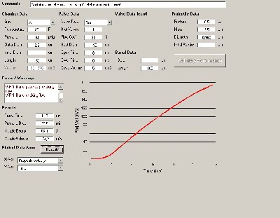

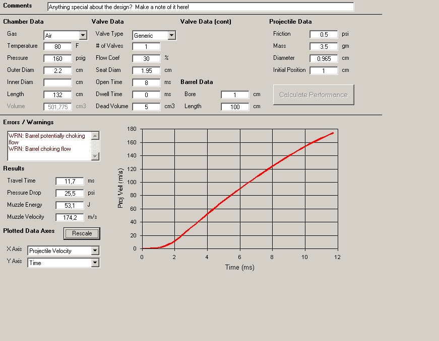

I GGDTed your gun - it seems that contrary to my previous post you don't have to worry about its long range performance...
sorry about that - I simply looked at the pics, skimmed the description fast and I didn't notice that there is a sleeved barrel... which made me think that the gun is much smaller than it really is and that there might be some performance issues... again sorry about that - my bad
the projectile is a 9.65mm ball bearing (3.5 gram IIRC)... seems like it would be quite a good round for this caliber - offering both good velocity and enough sectional density to allow some really long range shots
at 400 psi you could get 217,4m/s with the chamber volume of 100cc think about it
I know I am a little crazy about this but you might consider malleable iron threaded fittings as they offer great 'moddability' to your guns
also it makes spuddign cheaper in the long run because you can scap every part for your future projects
