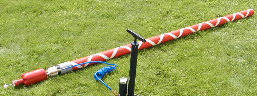

Here's a pic BTW.
jmccalip wrote:
rcman50166 wrote:Well I can only calculate it if I know how long 350lbs of force would be acting on the piston, if it is a continuous pressure I can do that now though....350>80 so...yes it would
Why does time matter. Wouldn't the force still hit a maximum of 350lbs(for example) no matter what, constant or split second?
Here's a pic BTW.
How long the pressure is present affects the duration of the pulse accellerating the piston. In my t shirt cannon, the recoil is fairly mild unless I launch a full Gaterad bottle, then it leaves bruises.
Nice pics. It would be a good idea to fill the end cap with someting not comperessable. If the bumper materal compresses enough so the piston hits the male plug, it may shatter the female adaptor. I learned this the hard way with my apple cannon. It had a PVC adaptor, but I had to change it after it was shattered once. Stay clear of the breech. Sometimes they do blow out.
