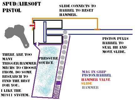

this is how i want to go about it. it's a quick mock up of an idea. it uses a piston valve that moves the barrel which seals it and moves the slide which resets the hammer. the pressure source can be whatever you want. i prefer propane. I've thought of plenty of ways to build a pistol but this is the more simple and reliable system. the only real hard part will be building the trigger and hammer system. if anyone has any suggestions on how to make a hammer that is heavy enough for cheap i'm all ears. i'm working with $0.

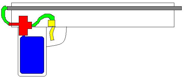

What i am planning on doing is full auto qev popoff, mag perpendicular to the barrel pistol. Running off helium from a backpack tank. All enclosed in an aluminum uzi handgun design. But thats for later on.
At the moment i am gathering parts for the gun ilustrated below. Simple and effective.
Its not multishot or anything but should be good for a bit of plinking and bloody easy to make.
RED= qev
YELLOW= hacked blowgun
GREEN= Flexi hose
BLUE= chamber
GREY= .22 barrel
RED= qev
GREEN= Flexi hose
BLUE= chamber
GREY= .22 barrel
