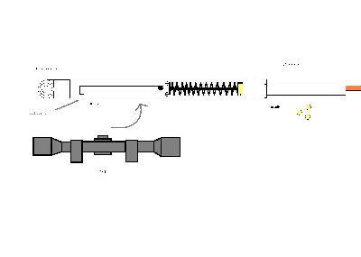

I am fighting between electronics and throwing speed at high velocity...
And i want to end this eternal fight by making what i always wanted to make, a cheap, easely reloaded and that shoots far...
The best option is spring, because i dont like pumping at each time...
My main question is for my barrel: It is 6.3 mm of diameter, is it enough or it wont be able to shoot bb's well?

6.3mm is extremely oversized for Airsoft BBs.
That is simply way too much blowby for the BBs.
I actually wouldn't recommend anything over 6.14mm for use with Airsoft BBs.
A regular airsoft barrel is 6.08-6.14mm, while a tightbore airsoft barrel is 6.01-6.05mm.
6.3mm has 5% blowby which is simply not effective.
.3mm oversize is huge when talking about smaller sizes (6mm)
I have seen some people have 1/4" barrels which has 5.8% blowby and its just atrocious how crappy performance it gets in comparison to even a regular airsoft barrel(6.14).

Same concerns as david but also I have a feeling that after extended use your spring lock is going to round off thus causing premature shooting (lulz). Also I don't think an airsoft gun deserves a tasco scope.
What about loading?

Yeah, 6.3mm wouldn't get anything done. As for the other concern about premature firing, I would suggest making the locking position longer and/or making it into a "J" shape to really lock it in place.
