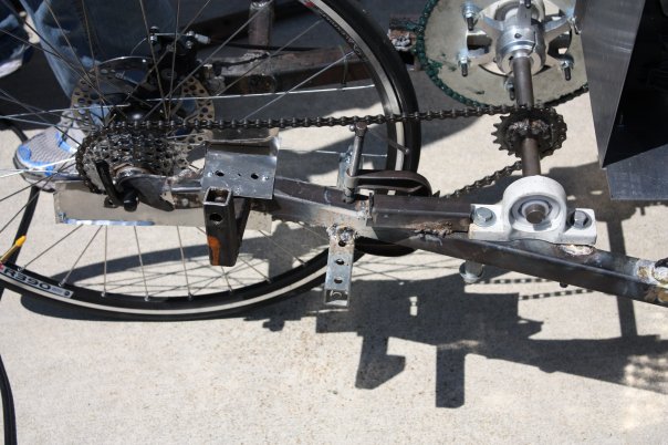

Three lightweight aluminum byclicle wheels
Push Rod Steering
Centrifugal Clutch
Engine to Jack Shaft to Wheel Transmission (6:1)

on the chaindrive, POLISH the SPROCKETS!!! Mainly the teeth where the chain rides, for chain lube use "hot sauce" reel lube(find it in fishing tackle), if you use bicycle wheels, make sure they are perpendicular to the ground(not cambered like last years, roller ball bearings friction goes way up when side loads are applied).... Also, think about restricter plates, I noticed you're using k&n air filter, but remember that more air=more fuel to maintain stoich.... also on tires, depending on track surface, sometimes less pressure is faster, you don't want super hard tires on a rough(most racetracks have more texture than a lot of roads) surface because vertical deflection removes some of your forward energy, you want the tires soft enough to roll smoothly without transmiting track texture into a verticle plain of movement....
since you can modify crank bearings, find out what size bearings they are and get some micropolished bearing... plays a huge factor, also polish the crank and make sure and run a light synthetic oil....

Once again you continue to impress. The clutch on the drive train was centrifugal. However we plan to use a cable engaged clutch, much like that of a ride on mower. The vehicle will be three wheel based of course to remove the need of a differential and the friction of another wheel. I have heard that the ideal detune displacement is right around 50cc.jeepkahn wrote:Don't use GREASE on the chain, you want a LIGHT oil, the hot sauce I told you about is what they use on HIGH END fishing reels, you'll be amazed at how well it works on chains... And seriously, throw the sprockets in a tumbler to polish them... any bearings in the driveline or chassis, make sure you get the highest quality, off the shelf bearings are CRAPPY compared to whats actually available... the balance of the motor is very important... also is the main drive sprocket from the motor a direct drive??? or is it a oneway clutch setup??? is it going to be 4 wheeled, 3 wheeled.... Another thing is depending on # of piston rings, you may be able to lose one, you only need the top ring and the oil ring(most racing pistons are single ring design), also you can groove the piston (like you would a pellet) to reduce surface friction... And I prolly don't have to tell you this, but you want the motor LOOSE... Check the clearance service limits of all the rotating and moving parts and whatever is in spec to the tightside, polish it until it's at the very loosest end of the specs....
