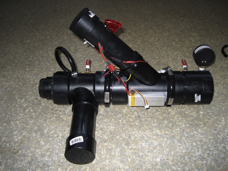

Hey guys, I'm new here and I thought I would show off my first cannon. I finally convinced my mom to let me build it! She still doesn't like it...

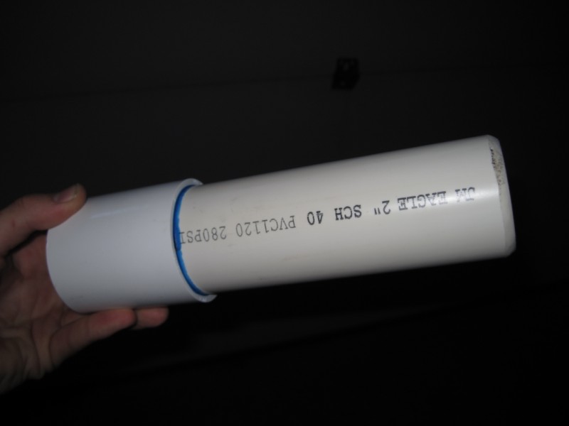

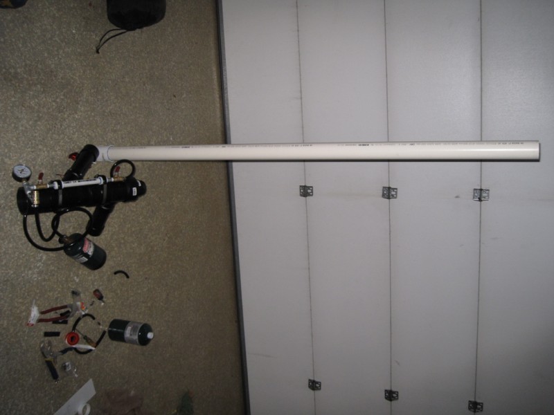

The cannon is mixed PVC/ABS, the combustion chamber being the ABS part, and the barrel is PVC. I used 3 inch for the combustion chamber, with a threaded 2 inch connector for the barrel.
The ignition system is based on the guts of a taser from ebay. It broke after playing with it for about 5 minutes (I only paid $18 for it, what did I expect!) so I built my own control circuit for it and now it works better than ever! The output of the taser is hooked up to a spark gap made out of copper clad, with a total of 3 gaps. The system fires on the first push every time :)

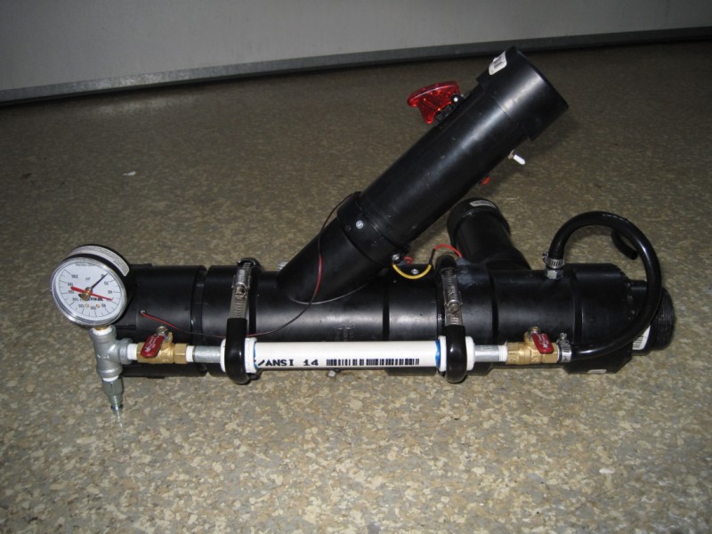

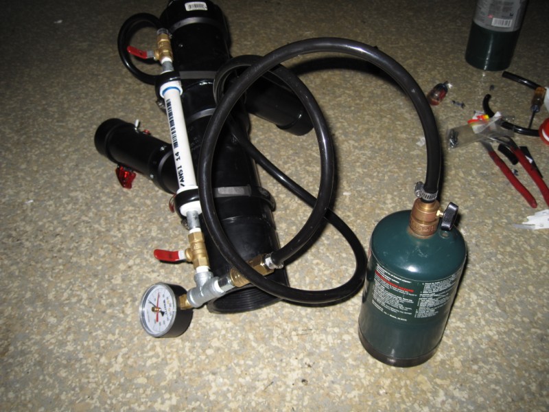

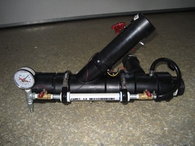

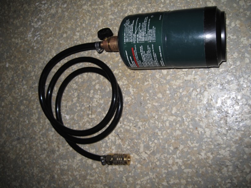

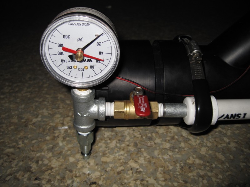

The fuel is propane, through a metering system made out of 1/4" galvanized fittings, 1/2" PVC, and some black acrylic tubing. I made a long hose coming from the propane tank, which ends in a compressor fitting for easy removal, so I can leave the tank on the ground. The pressure gauge is upside down at the moment, and I intend to get a different one as soon as I have the cash. I also used tubing to go from the second valve into the chamber, in lieu of using an elbow fitting. If anything goes wrong it is easier to disassemble this way.

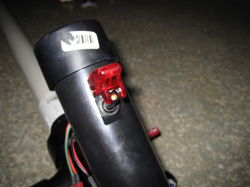

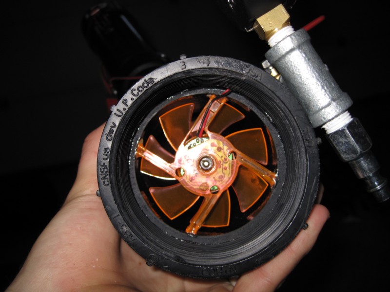

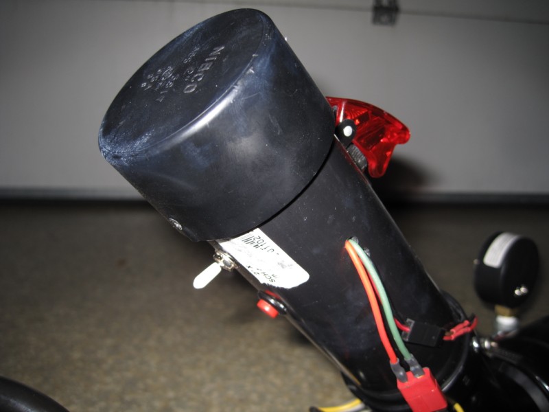

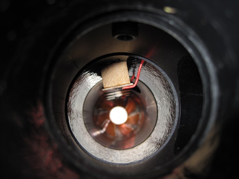

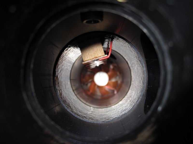

Also, I added a chamber fan to the system, controlled by a switch on the handle. All of the electronics, except the battery, are housed in the handle. A large aircraft switch with a cover arms the taser, but the fan works while it is armed or unarmed. A small red button on the bottom of the handle triggers the ignition.

Spark gap on, sort of visible...3 sparks total
Spark gap in middle of barrel, propane entry fitting visible at the top
Chamber fan, epoxied in
The switch lights up when its armed

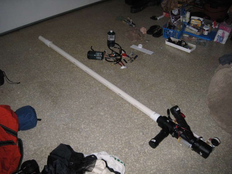

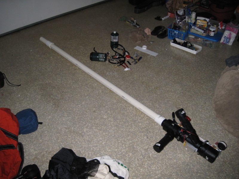

Everything assembled (minus the cleanout cap...I need a new one)
Removable potato cutter
All of the stuff...
All of the stuff...

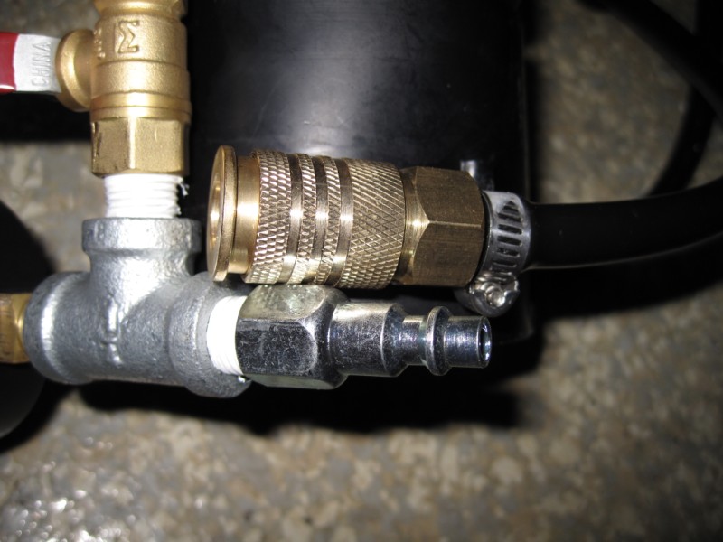

Close up of the compressor fittings
Propane system connected
Propane hose, with compressor fitting on the end
Pressure gauge
Pressure gauge
Handle, red switch on top arms taser, re button on bottom fires it, white switch controls the fan
Side view 2, LiPo battery visible
Side view 1, propane metering system visible.

Looks very nice especially being your first :lol: :o .......
My only recommendation would be to make the propane tank holder out of a magnet or something, I think there is a guide on burnt lake :D anyway again veryy nice :P

How long is your barrel?

Very nice, and well put together. Only thing I would suggest would be to remove the stickers and maybe the lettering from the meter pipe, and this would look great.

I'm not a massive fan of the DWV, but if you aint gonna use pressure rated ABS is the way to go.
The barrel is fine but the chamber is unrated. I wouldn't bother changing it because abs has excellent failure characteristics.

(1) you should not have epoxied the fan in place. If it ever dies (and it probably will) you are going to have a hard time replacing it.
(2) Do what Boom said with the tank. Click here for the link he was referring to.

I like the effort here...pretty extensive use of advanced spudding techniques and technology for your first cannon build. I like your outboard propane tank/detachable hose system. The fuel meter as a whole unit is neatly configured and the handling ergonomics of the unit as a whole looks fairly comfortable.

The barrel is 6 feet long, calculated from a barrel/combustion chamber ratio I saw somewhere...probably burnt lake.
mark.f wrote:Very nice, and well put together. Only thing I would suggest would be to remove the stickers and maybe the lettering from the meter pipe, and this would look great.
Hahaha yeah I realized after I took the pictures that I never took off the barcodes...I promptly did so. Also removing the lettering from the meter pipe is a great idea. I'll definitely do that soon.
Yeah after I built it I realized that I didn't use pressure rated ABS, but its all Home Depot had. I really wanted to make the whole thing out of PVC, but again, HD doesn't carry anything larger than 2 inches.

1. Meh, I really didn't use that much epoxy, and that epoxy isn't the greatest. And hopefully when that fan fails eventually (it was brand new when I installed it!) it will be time to build a new combustion chamber. But we will see...
2. I really like the idea of making a propane tank holder, but that requires me to buy another 10' section of pipe and with the way it's set up, the gun is lighter and it enables me to be able to use a large propane tank and a "tree" if you know what that is. Flexibility is key!
