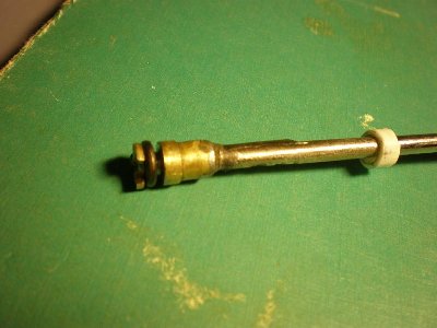

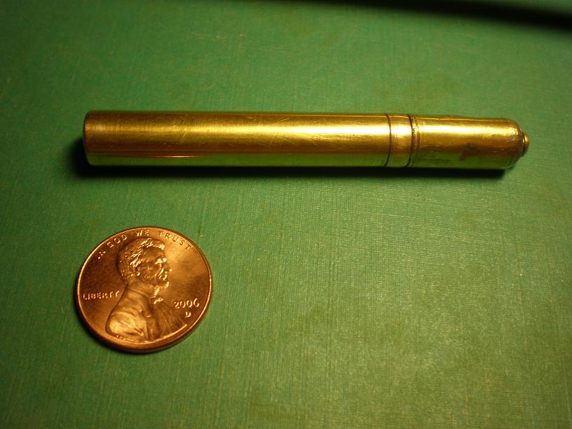

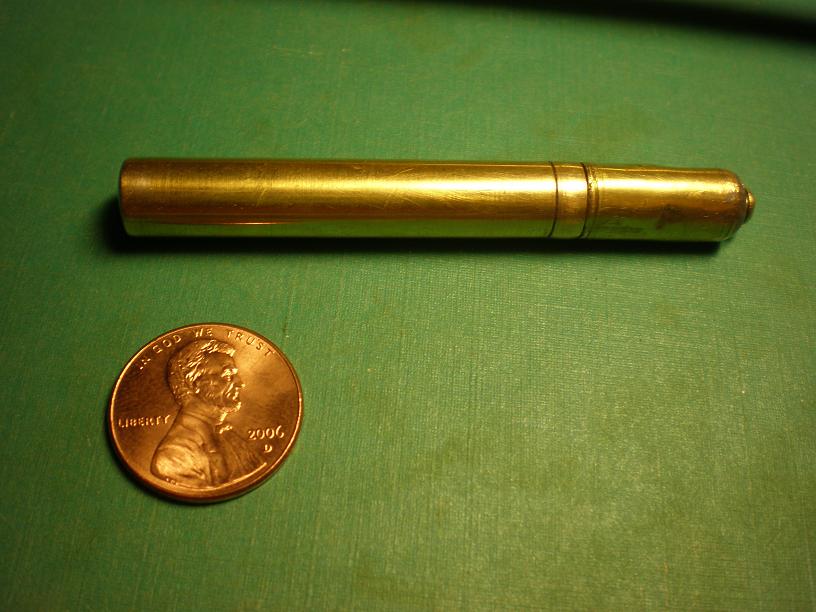

I saw Jook's keychian gun and decided I needed one too. I had pipe left over from my brass pen gun so I decided to build it out of that. Its nothing to special 2.5" long about 8mm wide with a 3mm barrel. I built another firing cap similar to the one on my larger pen gun.

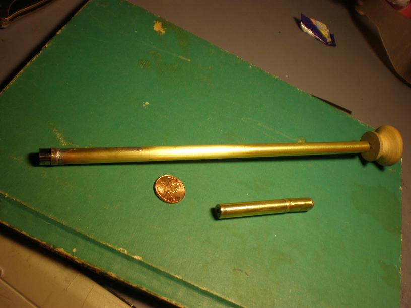

Shortly after building it I looked at another pen gun and saw this that JSR posted and decided to try my hand at building a small pump. It was surprisingly easy about an hour at the drill press and I had a floating oring piston that works great in my 8mm brass tubing. Im not sure exactly what pressure it can achieve but same gun firing same ammo penetrates much more using my pump as apose to a bike pump.
I normally fill the gun with about ten pumps from my small pumps, after that the power increase isnt significant enough to warrant more effort.
No damage pics right now but I got a nail to go through both sides of a coke can.
floating oring piston and pump shaft
the pump and gun
the pump and gun

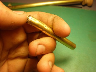

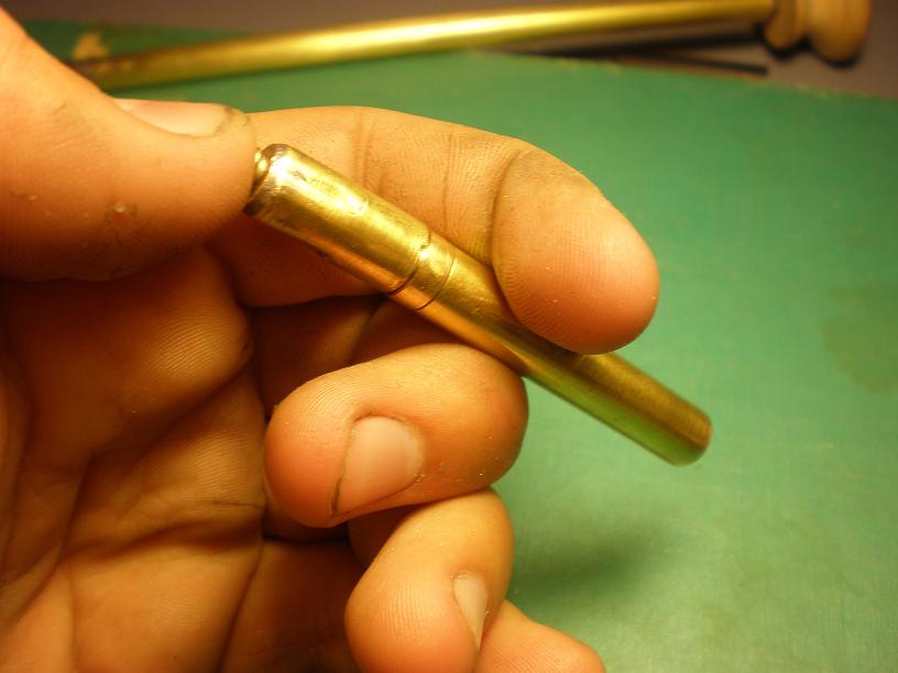

how I hold it to fire it

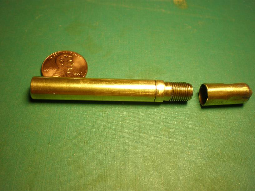

gun with firing cap removed for filling
the whole gun with firing cap

Good job, what's the stroke of the pump? With info like that we could give rough estimates of pressure.

what did you use to seal the barrel on the chamber ,epoxy putty?
jor2daje
Posts: 418
Joined: Sun Oct 05, 2008 9:41 pm
Location: Southern California
Everything except for the schrader is soldered together, I epoxied the schrader becuase I would have melted the piston if i tried to solder it.

Do you think you could take a picture from the barrel side(at the barrel)?

I love this! looks much nicer than my keychain gun. Great work on the pump as well. I made a pump that worked, but too well. I had the issue of getting past the crack pressure of my schrader, so it didnt fill very fast. I like my shock pump anyways.
I have the option of 800 psi fills from my paintball tank. I don't think I'd trust a schrader past that pressure anyway.
I remember gipetto testing a schrader up to 10,000 psi and it showed no signs of letting up. I would worry about the epoxy more than anything at those pressures.

Setting the record straight, the valve core of the schrader (the sealing face to be specific) was destroyed by the 10000psi test. However, it did not leak.
Replacing the valve core brought it back to "good as new".

Could you give us a rough estimate of pressure and maybe even a video of a shot seeing as how performance is hard to estimate on minis, though really performance isn't the main goal, or achievement in one.
Anyway good job, very clean and simple build, one of the nicer penguns up here.
Oh and by the way, shrader valves are fairly big in mini's there needs to be a smaller solution found for smaller minis, and for small minis with larger chambers and barrels. A shrader core would solve the problem(you screw it into a small, threaded hole in the back of the gun), but i can't think of much else.
