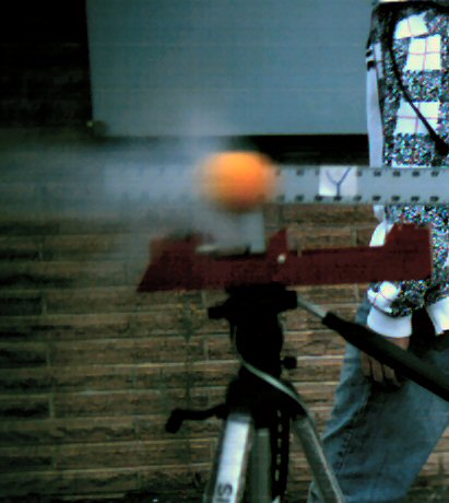

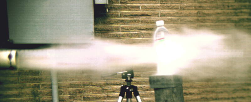

In air cannons, the sudden drop in temperature often causes an intense fog. Here are a few taken with high speed photography. I hope these photos help.btrettel wrote:Interesting. Is this a well known effect? It goes contrary to my understanding of how the chronometer works.Yeah, being less than a foot from the barrel can be a problem unless your using a wire break chrony.

- The apple is about 6 inches away from the water bottle.
- airblast2.jpg (34.73 KiB) Viewed 14243 times
- Orange and condensation fog.
- orange.jpg (34.79 KiB) Viewed 14230 times
